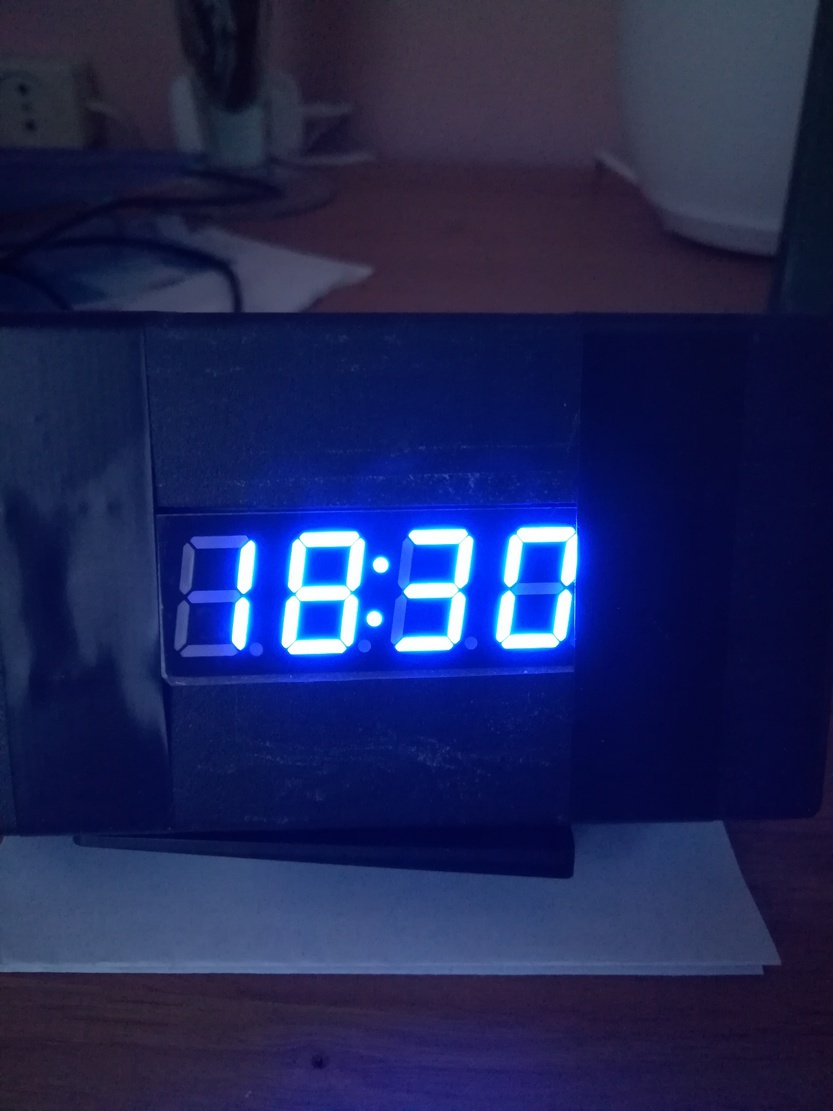

Re: Connecting a TM1637 4-Digit Display
thanks a lot 38domo, can you please post a picture of your display to confim which one you tested?
Or maybe refer to the pictures I've postes fwe message before...
hello,
it is the display with dots & semi colon
- IMG_20180316_183052-ConvertImage.jpg (185.02 KiB) Viewed 790920 times
