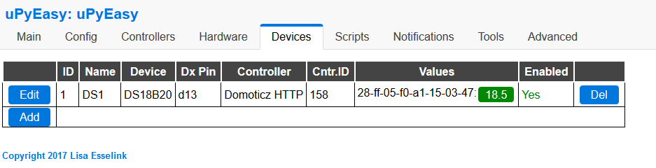

Just thought I'd post a screen shot of uPyEasy on my Lolin32 Lite board, working with three DS18B20 sensors (it seems these have to be on separate pins) and a BME280 showing all three readings (temperature, humidity, and pressure) and running nice and stable. :)
It starts automatically, thanks to BertB for his suggestion to add a main.py file. :)
Still using port 9000.
Thanks for all the hard work you have been putting in. :) Please continue, within the time you have available, and let me know if I can help at all.

Cool!!! :D
The DS's should be able to run on one pin, but maybe the plugin can't handle that yet. I haven't tested that out so far.
I'm busy documenting the architecture and database contents, so that you'll understand how uPyEasy operates.
I tried this first time around, with just two DS's, but they interfered with each other and both ended up looking at the same ROM address and reporting the same value as each other. It would be good to do that eventually, to match the ESP8266 version (it would simplify wiring, and use less pins too ;) ) but it is probably best to spend time on developing the rest of uPyEasy, unless someone particularly needs that extra functionality.
I'll raise an Issue on Github for this so it doesn't get lost.
That sounds good. :)
