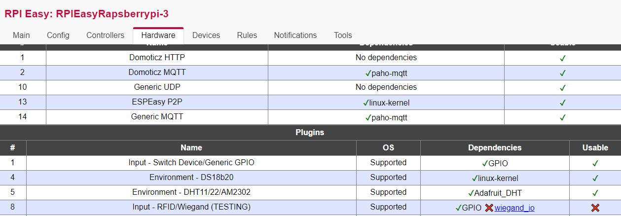

I would like to use the RFID / Wiegand reader. But the dependencies shows that i'm missing wiegand.io I've tried all kind of things but I can't get it to work.
Henk.
henkdejonge
Posts: 13
Joined: 22 Nov 2017, 13:47
Re: RPIEasy
#104 Post by henkdejonge » 20 Mar 2019, 16:55
henkdejonge wrote: 20 Mar 2019, 14:11 I would like to use the RFID / Wiegand reader. But the dependencies shows that i'm missing wiegand.io I've tried all kind of things but I can't get it to work.
Henk.
It's more easier than I thought.... just click on the blue link... et voila it's automatically installed... ;-)

I still got a small issue. I can't get pygame installed. Tried all kind of things but NOGO.
Henk
enesbcs
Posts: 587
Joined: 18 Jun 2017, 11:02
Location: Békéscsaba, Hungary
Re: RPIEasy
#122 Post by enesbcs » 10 Apr 2019, 20:18
henkdejonge wrote: 10 Apr 2019, 10:11 Hi,
Henk
Please send me the output of the following linux commands:
cat /etc/os-release
dpkg -s python3-pip
cat /etc/apt/sources.list
Then try to run installation manually:
sudo apt-get update
sudo apt-get install python3-pip
sudo pip3 install pygame
If the above writes some error messages please provide it also for narrowing the problem.
henkdejonge
Posts: 13
Re: RPIEasy
#123 Post by henkdejonge » 11 Apr 2019, 09:18
I've run the commands as requested. Everything went well. Only the last command for installing pygame exited with a error code 1.
Attached the output.
Henk
RPIEasy output.zip
(1.42 KiB) Downloaded 1352 times
enesbcs
Posts: 587
Re: RPIEasy
#124 Post by enesbcs » 11 Apr 2019, 17:32
henkdejonge wrote: 11 Apr 2019, 09:18 I've run the commands as requested. Everything went well. Only the last command for installing pygame exited with a error code 1.
I see. Please try:
sudo apt-get install libsdl1.2-dev
Then:
henkdejonge
Posts: 13
Re: RPIEasy
#125 Post by henkdejonge » 12 Apr 2019, 15:43
Tried the command... same result... :-( I think I'll try to reinstall the whole stuff from the beginning. Nice job for the weekend.. ;-)
Thanks anyway for your support.. or perhaps somethings else pops up in your head..
Henk.
RPIEasy output.zip
(646 Bytes) Downloaded 1364 times
enesbcs
Posts: 587
Re: RPIEasy
#126 Post by enesbcs » 12 Apr 2019, 20:23
henkdejonge wrote: 12 Apr 2019, 15:43 Hi,
Henk.
Hi!
It is very odd, looks like you have more dependencies missing, than i have ever installed.. :)
Please run the below command, than try to reinstall pygame with pip or with RPIEasy.
sudo apt-get install libsdl-image1.2-dev libsdl-mixer1.2-dev libsdl-ttf2.0-dev libsdl1.2-dev ffmpeg libfreetype6-dev python3-dev
If it solves the problem i will add all of them to the dependency list.
henkdejonge
Posts: 13
Re: RPIEasy
#127 Post by henkdejonge » 13 Apr 2019, 13:33
Still dependencies missing...but almost there... ;-)
See attached output file.
Grtz,
Henk.
RPIEasy output.zip
(642 Bytes) Downloaded 1346 times
henkdejonge
Posts: 13
Re: RPIEasy
#128 Post by henkdejonge » 13 Apr 2019, 13:59
The next command almost did the trick... ;-)
sudo apt-get install libportmidi-dev libportmidi0
pi@raspberrypi:~ $ sudo pip3 install pygame
Collecting pygame
Using cached https://files.pythonhosted.org/packages ... 9.5.tar.gz
Building wheels for collected packages: pygame
Running setup.py bdist_wheel for pygame ... done
Stored in directory: /root/.cache/pip/wheels/4b/e1/2a/58ce2aefc91564e870fcc388f04e69d96159ff64671ca0e22d
Successfully built pygame
Installing collected packages: pygame
Successfully installed pygame-1.9.5
Unfortunately the pygame successfully installed but the output of the dependencies page still shows red crosses
Grtz,
Henk.
henkdejonge
Posts: 13
Re: RPIEasy
#129 Post by henkdejonge » 13 Apr 2019, 14:01
After a reboot the red crosses are gone... ;-)
Henk
enesbcs
Posts: 587
Re: RPIEasy
#130 Post by enesbcs » 13 Apr 2019, 19:18
henkdejonge wrote: 13 Apr 2019, 14:01 After a reboot the red crosses are gone... ;-)
Thank you for your feedback I've added extra dependencies in todays commit to RPIEasy.
