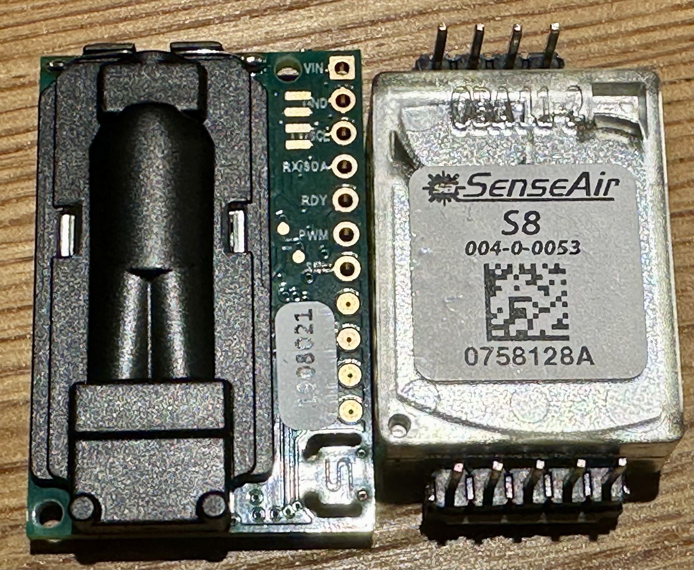

TD-er wrote: 11 Jan 2024, 14:48 The SCD30 is really not small.
To be honest, I've been quite surprised as I had them first in my hands. They are not that big, like I expected.
Compared to the SenseAir S8, they are not that much bigger:
