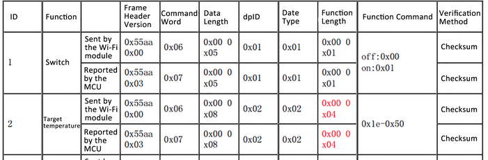

I have yet another Tuya-based family of Wi-Fi switches and power outlet devices that are also controlled by the MCU and serail comms to the TYWE3S Wi-Fi module.
I'm guessing this plug-in will work fine.
I have noticed, however, that both the switches (1, 2, 3 and 4 Gang) as well as the Power outlets have current sensors. With the "Smart Life"/"TuyaSmart" app I can read the current utilization (in Watts), which I assume is being read by the MCU and the data goes, via comm, through the TYWE3S to the cloud. I assume that because there is no other GPIO connection except TX/RX on the TYWE3S.
I have briefly read the tuya serial communication protocol and have noticed that they have mentionned some other comms relating to reporting of sorts (e.g. temperature).
I'm wondering how we could add these readings to the plug-in and take full advantage of the protocol rather than just switch on, off and dim?
Thoughts?

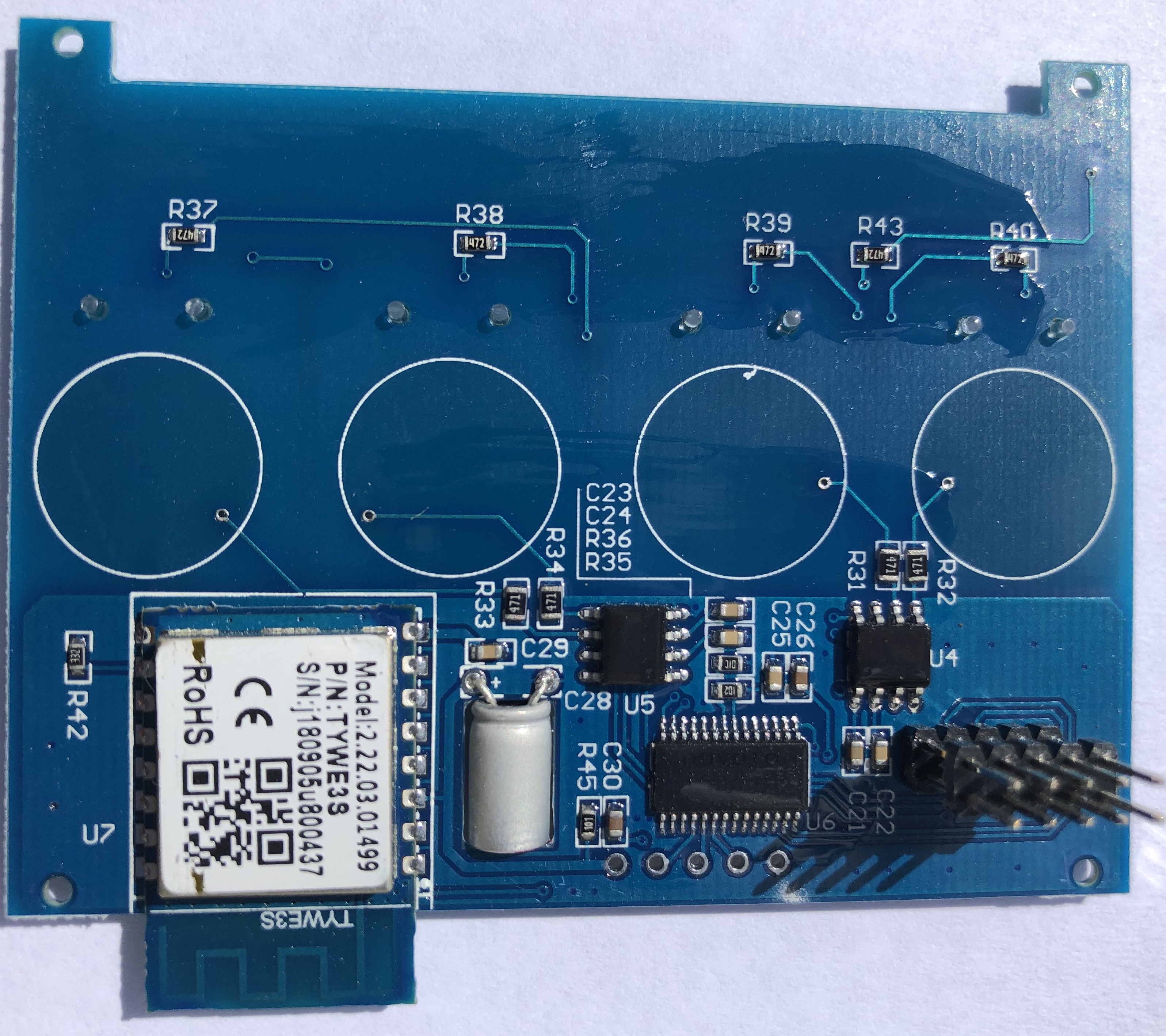

So here is the 4 gang wall switch
4ch - back.jpg (2.01 MiB) Viewed 216719 times
the switches have a controller board and a relay board, as well as the current sensors.
I guess the current sensors are not that important (it's more of a nice-to-have), especially for the GPOs.
But if it isnt too much trouble, may I ask for a version of the firmware where there is a 4 relay option?

Mravko wrote: 28 Apr 2019, 14:54 So here is the 4 gang wall switch
Adding an option is not so hard, few minutes... but compiling and testing is a much more challanging quest.
As i see there are some troubles with the ESP 2.5.0 core, so i had to first reinstall 2.4.0. This is the last version that proven to work with serial communication both ways. Interesting fact, that both the 1gang and the dimmer version broadcasting all three (non existent) gang's status informations everytime when either gang is changed their state, so i thought that 3 gang is the limit. As i see your image i was wrong. But i am curious if it will be enough to add a new id or the packages changed for the 4th gang somehow. I hope that i be able to upload the modified firmware soon.

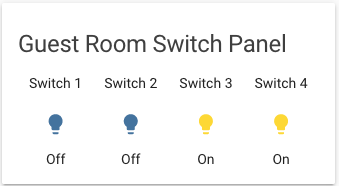

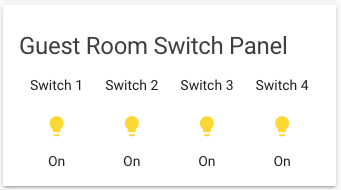

Ok here's how it went:
There is a 4 relay selection in the TUYA type. <tick>
However:
The log shows the same thing.
With all four switches are "on" the output is:
SerSW : Dimmer
364670: EVENT: MCU#Relay0=1.00
364674: EVENT: MCU#Relay1=1.00
364676: EVENT: MCU#Relay2=1.00
364679: EVENT: MCU#Relay3=0.00
error: So he fourth relay is not reporting that it is on
and with all switches "off" again, the output is:
730420: SerSW : Dimmer
730423: EVENT: MCU#Relay0=0.00
730427: EVENT: MCU#Relay1=0.00
730430: EVENT: MCU#Relay2=1.00
730432: EVENT: MCU#Relay3=0.00
error: The third relay, "Relay2" still reports a 1.00
and only when I do a cold reboot the switches all report 0s:
>> NetworkError when attempting to fetch resource. <<
18031: SerSW : Dimmer
18034: EVENT: MCU#Relay0=0.00
18038: EVENT: MCU#Relay1=0.00
18041: EVENT: MCU#Relay2=0.00
18044: EVENT: MCU#Relay3=0.00

One step further and here is what I have:
55AA 01 07 05 01 01 00 01 00 0F /Switch OFF
55AA 01 07 05 02 01 00 01 00 10 /Switch OFF
55AA 01 07 05 03 01 00 01 00 11 /Switch OFF
55AA 01 07 05 04 01 00 01 00 12 /Switch OFF
55AA 01 07 05 01 01 00 01 01 10 /Switch ON*
55AA 01 07 05 02 01 00 01 01 11 /Switch ON*
55AA 01 07 05 03 01 00 01 01 12 /Switch ON*
55AA 01 07 05 04 01 00 01 01 13 /Switch ON*
55AA 01 07 05 01 01 00 01 00 0F /...and so on...

2. When I toggle all four switches, it reports all 4 switches are on: (Good)
Screen Shot 2019-05-01 at 1.39.59 pm.png (18.27 KiB) Viewed 216606 times

3. When I switch them all off, the first two switches report off but switch 3 and 4 report staying on (Not so good)
Screen Shot 2019-05-01 at 1.32.32 pm.png (18.23 KiB) Viewed 216606 times
Important note:
I believe this has to do with the way the info (fom the MCU) is being parsed by the plug-in.
switch 1 and switch 2 work fine but switch 3 and 4 toggle on correctly but once the bits are set on them, they cannot be reset (even if I switch them off on the panel, they will still report being on). It seems that it doesnt re-read the MCU message any more. The switches are actually "off" on the panel but the plug-in is reporting them as on.

So the first 4 items are switch status reports from MCU i.e. 55AA01070005
the subsequent 8 items are (according to the tuya documentation, something to do with target temperature. i.e. 55AA01070008, (which I'm not really sure it is accurate, btw).
Screen Shot 2019-05-01 at 4.30.05 pm.png (137.01 KiB) Viewed 216602 times
I think that the plugin is ignoring (or not reading the MCU corectly) everything, beyond the first two items and therefore not updating the status.

Mravko wrote: 01 May 2019, 05:57 3. When I switch them all off, the first two switches report off but switch 3 and 4 report staying on (Not so good)
You are right the packages with length 8 has to be the informational packages which is skipped by the code. I've seen such errors when the serial buffer overflowed. Did you try 242, 241 and 240 version also?
The device i have only sends updates when the buttons pressed and it is working fine for me. Except if you specify 10 seconds instead the default 0 sec in the plugin settings page.
My one button device sends 3x12=36bytes per message and it is nicely work in the increased 128bytes serial buffer. (default serial buffer was 32bytes and it was really low caused collisions)
Your device sends 4*12+8*15=168bytes for one package (to the 128bytes serial buffer) which may cause some interference when breaking package header near the end...

Another problem I have now is I'm unable to do an OTA upload on a 1M chip as the code exceeded 600ish kb.
I have to cut the RX track, solder the wires, upload the firmware via USB, un-solder the wires, place the RX track back and so on. :(

#241 Post by Mravko » 01 May 2019, 17:18
enesbcs wrote: 01 May 2019, 10:37
My thoughts:
I'm wondering if it has anything to do with the way the device sends an update (~ every 10 seconds)? and the way that plugin deals with the info:
every 10 seconds it will send this (I have added the <return>'s for easier reading:
55AA0107000501010001000F
55AA01070005020100010010
55AA01070005030100010011
55AA01070005040100010012
55AA0107000807020004000000001C
55AA0107000808020004000000001D
55AA0107000809020004000000001E
55AA010700080A020004000000001F
55AA0107000865020004000000007A
55AA0107000866020004000000007B
55AA0107000867020004000000007C
55AA0107000868020004000009870D
So that's 12 status items every 10 seconds (without a white_space or CR/LF), ie:
55AA0107000501010001000F55AA0107000502010001001055AA0107000503010001001155AA0107000504010001001255AA0107000807020004000000001C55AA0107000808020004000000001D55AA0107000809020004000000001E55AA010700080A020004000000001F55AA0107000865020004000000007A55AA0107000866020004000000007B55AA0107000867020004000000007C55AA0107000868020004000009870D
I don't have too much programming experience but am wondering if your parsing methodology (doing it via "case "n") is able to parse it properly?

Mravko wrote: 03 May 2019, 09:07 I'm wondering if the hex of switch 3 and 4 are not read correctly in the read section. you know 0x00, 0x01, 0x0a and 0x0b.
I'm wondering if a and b are not interpreted correctly when reading.
I don't quite understand your point, it does not matter if you write it in hex or decimal, everything is binary. Byte values arriving from serial which do not need any interpreting.
Mravko wrote: 03 May 2019, 09:07 As I don't really follow the reading of the status, I cant figure out what bytes it's expecting for switch 3 and switch 4?
The same as switch 1 and switch 2 as the packet format is equal. You wont find a difference where there are no difference, this is handled by the case from line 434.
Mravko wrote: 03 May 2019, 09:07 Could the dimmer selection be interfering with the reading?
I noticed it's 8 bytes and I think my logs show that it is sending those valies, so when it is processing 2, 3 and 4 is it expecting dimmer values or switch values?
If you see "SerSW : Dimmer" it does not process anything but execute a sendto() command which may update the device status in MQTT.. but if it bother you, i can hide it.
If you see "SerSW : Dimmer d1:" or "SerSW : Dimmer d2:" in your logs, than yes, it may interfere.
