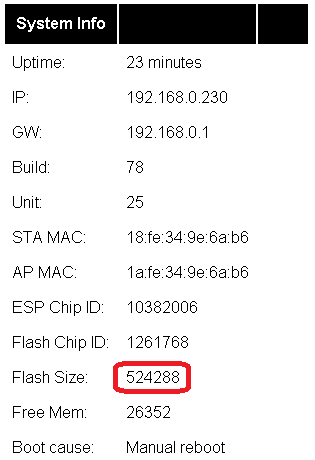

Martinus wrote:Just upgraded all my units using the firmware bin file R78 through OTA (12 pieces) within 10 minutes. Not a single issue encountered here. This is really convenient this way.
must the binary be build in the arduino ide for a special flash-size?
(as i am in doubt, wich flash-sizes my ESP01/ESP12E units "really" have. if they are spread around the house, and i dont see them no more, i think this information gets lost)
(i tried to upload R078 to my R077 ESP01 from the webgui "/tools/settings/load", but i did not see anything after upload. i did i via serial this time)
Martinus
Re: ESP Easy Releases
#222 Post by Martinus » 06 Feb 2016, 14:43
tozett wrote:must the binary be build in the arduino ide for a special flash-size?
Yes. That's why we provide three versions in the zipfile: 512, 1024 and 4096.
And remember that you cannot use 512 for OTA. This version can only be uploaded with a serial flash tool.

#224 Post by tozett » 06 Feb 2016, 15:08
Martinus wrote: Yes. That's why we provide three versions in the zipfile: 512, 1024 and 4096.
ok, i read it before, but i did not need it that time:
http://www.esp8266.nu/forum/viewtopic.p ... =160#p3183
How do i know wich size of the bin file i use, if i am not sure wich size my flash is.
could you detect this in an upload-tool? would be "easy"ier...
Martinus
#225 Post by Martinus » 06 Feb 2016, 15:12
You can always load the 512 k version and then check the webgui. This will tell you the actual size.
This is my old blue ESP-01:
