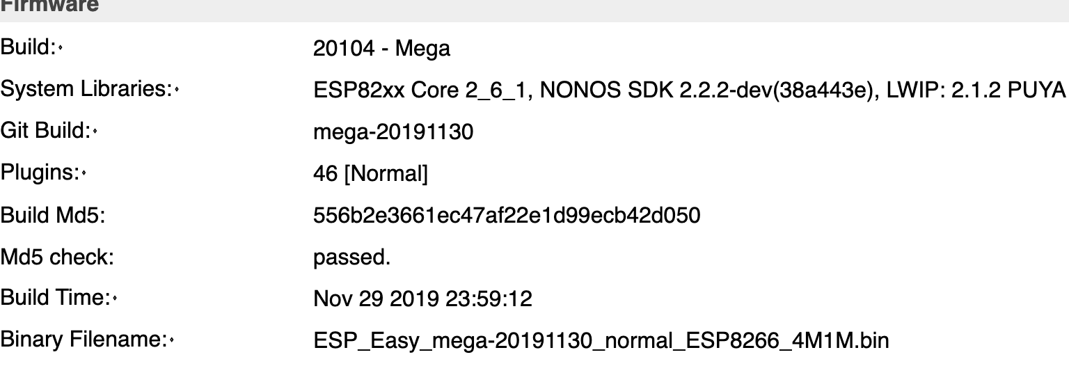

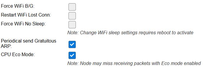

My battery monitoring devices (four devices Wemos D1 china clone) have been pretty unstable with releases > 2018-05-22. For testing purpose four weeks ago I have upgraded one device to release mega-20191123 with the following result up to now:
Used release:
Survived reconnects:
Previous and actual stability (reported uptime in mins to Domoticz):
Wifi config: AP (Fritz Box) fixed channel 9 and fixed to 802.11 b/g, used fixed IP for devices, advanced Wifi settings:
So for me this device reached a new uptime record....
Used release:

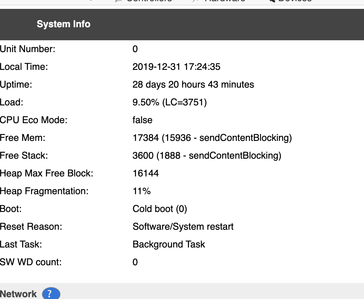

Hi Team,
Great to see that we have a stable system.
Now that the esp isn't rebooting i see there is a minor issue with presentation of the Wifi connected timer...
It doesn't seem to go past 21 day's, when it is supposed to go to 22 days it looks like it goes back to 20 days...
Here some screenshots.
Just for the statistics it would be nice to have it working ok.
Have a great year end!!
Re: Hardware Watchdog Reboots
Yep there is a bug when the connected time exceeds 2^31 msec.
