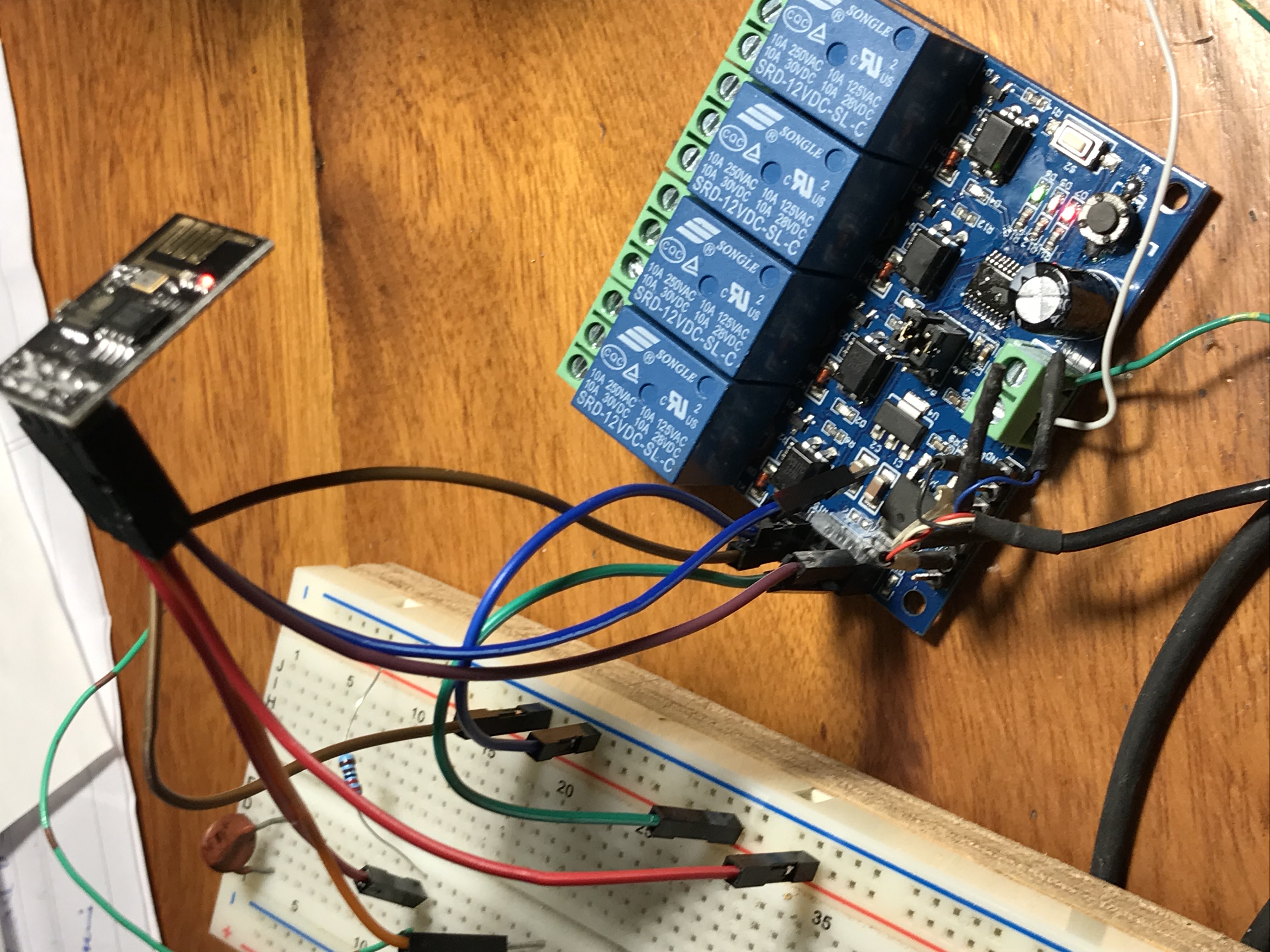

Colleagues,
I am working with the LC Tech module 4 relays as HTTP station for openskrinkler app . The issue I am facing is that when the ESP8266 ESp01 is on(attached to) the relay board, it does not connect to the WIFI.
If the ESP01 is not installed (since had to remove it to program with ESPEasy) , but connected with +Vcc, GND, Tx,Rx it works ok .
The only difference when the module is removed (to programm the ESP) are the GPIO0/2, RST and CH_PD. The first two I have them open and the others to +V .
Was wondering if the local controller sets these pins and prevent the WIFI to connect .

Question :
Is there any setup on the ESPEasy to ignore what the local MCU sends to the ESP module?
Cheers,
martin

Re: Serial MCU controlled relay/switch
Can you measure the voltage on the ESP when it is powered on the relay board?
Preferrably with a multimeter (or a scope) which may record the lowest voltage.
The voltage should be the same, since I taking the power from the relay module.
Take a look at the picture.
- IMG_5626.jpg (1.76 MiB) Viewed 40844 times
OK, I see.
Had to look hard to follow the wires, but it looks indeed like you're powering it from the relay board.
So this setup should even be worse, considering the possibility for voltage dips.
Just curious, have you tried it with this setup, but the TX of the board connected to the ESP's RX?
Let's assume your hypothesis of the event handling taking way more time to process and thus the WiFi timing out to be correct (I think it is plausible)
One thing you can do, is place the event that has to be handled at the top of the 1st rule file.
This will make handling that event much faster.
I noticed you're using quite an old build and there have been a lot of optimizations in the rules handling over the last years (I estimate that build is like 3 years old?)
Yes, I am taking power from relay module. Using the breadboard just to make the connections.
And yes, also measure the the RX/TX. What I posted up to now is what the module is sending to the local MCU and this is what the MCU is sending (in this case X3)to the ESP8266 and I am assuming it is ignoring these commands, right?
If you can read logs, then the AT commands sent by the module will be parsed by the command interpreter of ESPEasy.
This parsing may cause delays, which may affect some time critical actions like connecting to WiFi.
The latest builds can be found here: https://github.com/letscontrolit/ESPEasy/releases
But be aware that 1M builds may be hard to update via WiFi as it simply won't fit.
So you might want to flash them using serial.

is it even possible to install the Serial MCU on an ESP01 1M?
Have tried the ESP01 with
ESP_Easy_mega_20210802_test_C_beta_ESP8266_4M1M.bin
to flash.
After that, I can't get a connection to the ESP01 despite successful flashing.
Greetings Dondolo
The build you flashed is for 4M flash, so not really strange to see it won't boot.
Currently there is no pre-build file for 1M using that plugin.
So we have to make a custom build for it.
What else do you need in that build?
