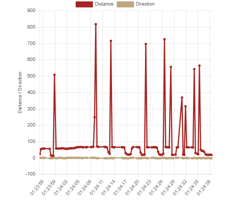

Hello. When using this plugin, when the sensor loses the object of measurement, the distance first increases sharply to extreme values, and then shows the actual values. Why can this be and how can the readings be filtered? Firmware number Build: ESP_Easy_mega_20241222_collection_B_ESP32_4M316k Dec 22 2024

#57 Post by TD-er » 31 Mar 2025, 22:02
Could it be there is some reflection so only slightly tilting the surface then makes it look into another direction?

#58 Post by sartam » 31 Mar 2025, 22:17
The sensor "looks" at the ceiling and measures a distance of 180 cm to it. When you bring your hand into the sensor's field of view and then remove your hand, the readings sharply increase to 400 cm or more, then return to normal values.

#59 Post by sartam » 31 Mar 2025, 22:27
This is very typical. I sit in front of the sensor and move my hand between myself and the sensor. Meanwhile, if I simply change the distance between the surface and the sensor, such an effect is not noticed.

#60 Post by Ath » 31 Mar 2025, 22:43
You seem to have the Range set to Normal, meaning the max expected distance is 800 mm (the highest peaks in your graph). For measuring up to 2 meter, Range should be set to Long. This might improve the behavior for the longer distances.
For more accurate measurements you could consider a VL53L1X, as supported by P113 (available in the same ESPEasy build). It has a separate plugin as it is not software-compatible with the VL53L0X.

#61 Post by sartam » 31 Mar 2025, 23:14
No. On the chart the numbers are centimeters. And the Range is set to Long.

#62 Post by ThomasB » 02 Apr 2025, 01:03
It might be an alias error. Transmitted IR from a ranging cycle can be received *after* another transmit has occurred. When this happens the received distance will be wrong, perhaps about 2X or so. Your hand movements could be interrupting the IR Tx or Rx in such a way it causes this unwanted artifact to occur.
Since 200cm is the max supported by the VL53L0X in the Long Range mode, perhaps you should just ignore the out-of-range values.

#63 Post by TD-er » 02 Apr 2025, 09:04
ThomasB wrote: 02 Apr 2025, 01:03 [...]
Sounds like ESPEasy should filter this.
