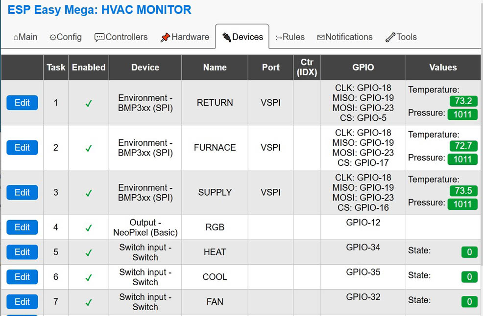

I installed the HVAC Performance Monitoring system yesterday. The three SPI based sensor probes (connected by the long ribbon cable) are now inside the HVAC duct plenums and heat exchanger. Everything works!
