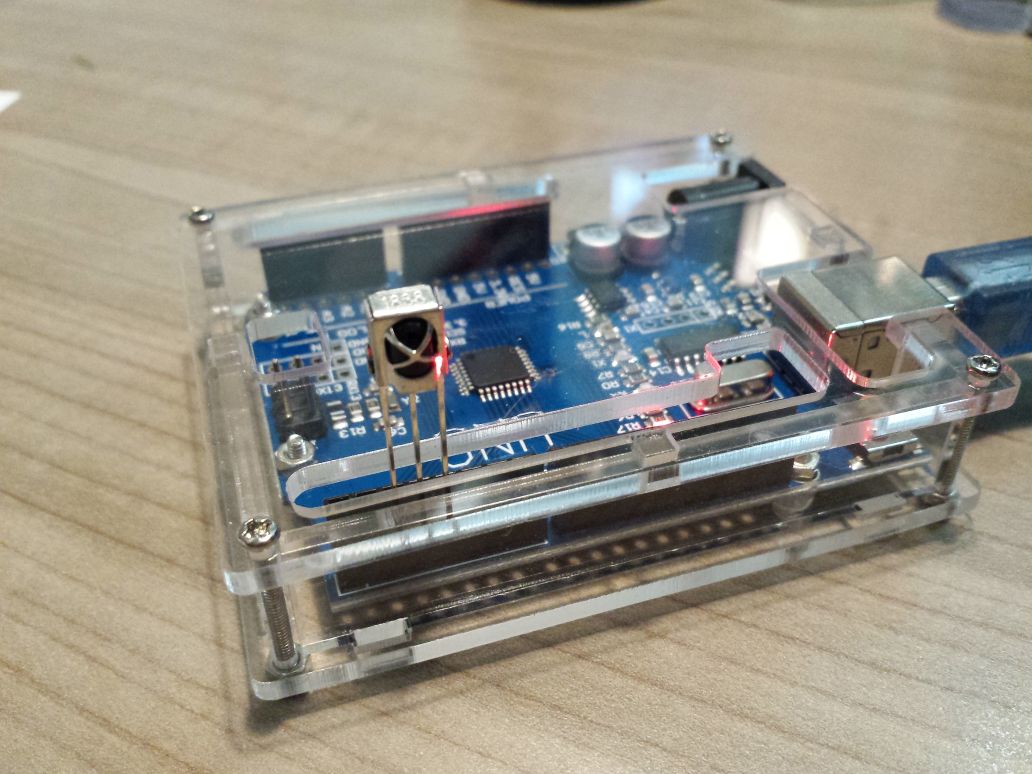

Could you try this decoder: https://github.com/ToniA/Raw-IR-decoder-for-Arduino
Even if it wouldn't understand the protocol, it should give out the data in a format which is easier to read.

sorry i have no arduino or can i use my nodemcu for scan?

Hi, here is quick caption from LG remote, if someone likes to study them more (if needed, I can make more tests):

#60 Post by ToniA » 04 Jun 2017, 10:12
You need to select a different decoding mode. The option '1' is not right for this model, as you see 'h' symbols in the middle of the data stream.

#61 Post by ramppa » 04 Jun 2017, 11:59
Sorry, my mistake. I was sure, there was no change between modes, but after recheck, modes 4&5 gives these :

based your https://github.com/ToniA/Raw-IR-decoder-for-Arduino, I've written a decoder for my ZH/LT-01 airco remote control, which was great fun. This remote control is used in over 10 different locally branded Airconditioners. Of course, I want to share my ZHLT01Remote.cpp with the Github-community, but being a noob, I have no idea how to proceed, so please, can someone help me out here. :?:
Besides for the cpp-file I have two remarks to make the decoding easier:
* The suggested IR-sensor is very old and cannot be bought in the market anymore. A very, very common IR-sensor is the VS1838, which also works fine. My suggestion is to add this to the readme, making it easier for other people to start help decoding.
* I suggest to set PIN3 HIGH and PIN4 LOW, (ab)using these pins as pseudo-VCC and -GND and eliminating the need for any wiring; also much easier to set up, see the photo.
Of course, I want to use the decoder to make an encoder for my heatpump (and I'll need som help for that too), but let's do that next...
Awaiting you response!
Cheers, Marcel
Stick your VS1838 right into the Arduino with PIN3 and PIN4
2018-06-07 21.07.42.jpg (160.51 KiB) Viewed 92239 times
