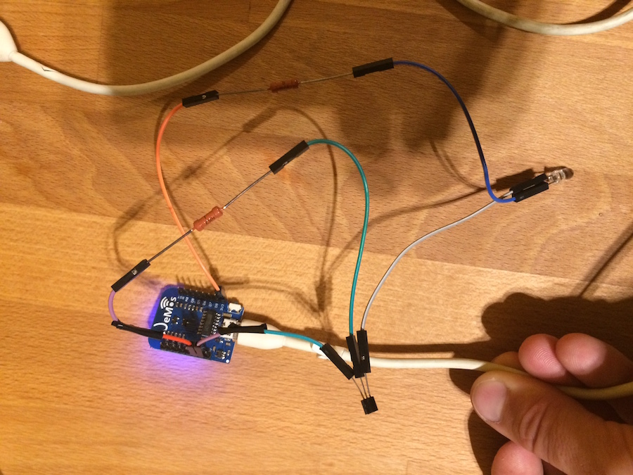

Finally I have time to play again with the IR. ;) Costo, do I need a resistor between GPIO and the base of the transistor? On the schematic I see 1kΩ resistor, on other sites I found 4.7kΩ resistors.
EDIT:
I just made a quick prototype:
It's working pretty good. Two more questions left unanswered:
If I choose GPIO2 (D4 on Wemos) the WiFi led is lighting ->why?
Can I use the IR LED(+transistors, resitors) on a 2 meter length cable? On the other end will be the ESP8266.

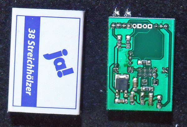

#57 Post by Shardan » 28 Dec 2016, 23:05
Hello all,
after tinkering and testing around i've created a first prototype of a little IR transmitter/receiver module.
Some improvements are still to be made:
- Change the transistor to a SMD darlington type or MOSFET to get more power,
- OnBoard flashing possibility
- find out why it does not boot up sometimes when powered on.
For now besides the mentioned points the prototype works well, driving my Yamaha receiver and some cheap led stripes from the DIY market.
It can be used with 2 or 4 IR-LEDs so one may bend some LEDs to get better results or use 850 nm and 940nm LEDs in parallel.
A TSOP-Receiver can be added optionally to the board to use a IR remote control for what purposes ever.

#68 Post by Shardan » 30 Mar 2017, 20:01
Hello all,
for those who have difficulties with the hardware here is the schematic and PCB layout
including silks for the IR-TX-RX shown in post #57.
IRTXRX-v2.1.pdf.zip
(139.12 KiB) Downloaded 3214 times
The version has some slight changes over the photos from #57 to improve the IR-receiver.
I've five of these modules running atm so i can say it is proven to work.
You may use different IR LED types. Beware, you have to adapt R4 and R5 to your LED type!
Most LEDs can take 20..30 mA. As they are pulse driven here they can take much more, but
be carefull.
The PCB is designed for four LEDs to give high IR power. You may ommit one of the paths, for example D1/D2/R4.
R3 is optional, some FET transistor types need it, some not. So i designed it into the PCB
The IRLL014 does not need it.
For easy flashing RX, TX and reset are lead out to pins.
The jumper P6 gives GND for flashing and allows jumpering to flash mode.
Happy tinkering :)
