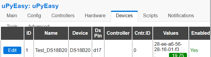

I then added a DS18B20 device, and that's working, although there do seem to be a couple of bugs:
1. In the web interface, I selected GPIO22, which matches the physiccal pin I connected to, D22. However, in the log there are references in the DS18B20 section to d21 - no idea where that is coming from. (section of log below.)
2. There is something strange about the Decimals field at the bottom. I can get the selector to show e.g. 1, but it also shows in the list a couple of unrelated items, phone numbers etc. (Using Google Chrome browser). And when I leave it at one and click Submit, then go back in to Edit, the number 1 has disappeared, it doesn't seem to get saved. It certainly doesn't take effect on the value presented on the main Devices page, this has a variable number of decimals, 2-4.

I haven't yet tried again the BME280, I'll get to that this evening hopefully.
Despite these things, I feel we are making progress! :)

BME280 is basically working for me, on LOLIN32 LITE board. :D And it's stable (touch wood!).
Temperature and pressure look fine,
but unfortunately Humidity is stuck on zero all the time, which seems unlikely here in Shropshire UK. ;)
I also noticed a few "cosmetic" points.
1, The Humidity value is displaced to the left compared with the others.
Capture BME280.PNG (22.83 KiB) Viewed 111681 times
2. if I narrow the window in which uPyEasy is displayed, the page-tab headings go onto the second line (as expected) but the rest of the page does not move down to make extra space, so the second line tabs try to overlap the screen display and are partly hidden.
Capture Tabs hidden.PNG (13.53 KiB) Viewed 111681 times
3. I have the same problem with the Decimals fields as I found with the DS18 (not being saved/re-displayed, and not controlling the values shown.)
Cheers
Andrew

Do you know for sure you have the BME280 and not the BMP280?
They are almost the same, but the BME version also measures humidity.
And are the 1-wire sensor and the BME/BMP measuring the same? Then the displayed temperature of the Bosch sensor is about 9 degrees off.
AndrewJ

Hi TD-er,
I think you may have pointed out the explanation of the zero humidity values. I checked the identification on the module, and it actually says "BME/P 280" :roll: So it's possible that in reality is BMP. Chinese clone.
I'll check later, but I may have another module which is definitely a BME and which has given humidity values when connected to a ESP8266 nodemcu. If so, I'll test it with the ESP32 and report back.
Thanks for your input! :)

Meantime, I found my other BMx sensor module and checked it on a nodemcu running ESPeasy Mega (but not yet the latest build). It gives non-zero humidity values which look "sensible". (Even though that one is also labelled "BME/P 280"!)
So, I connected it to my ESP32 and it is also working there, including the humidity value. So the uPyeasy BME280 plugin is fine. :)
Thanks again for your suggestion.
