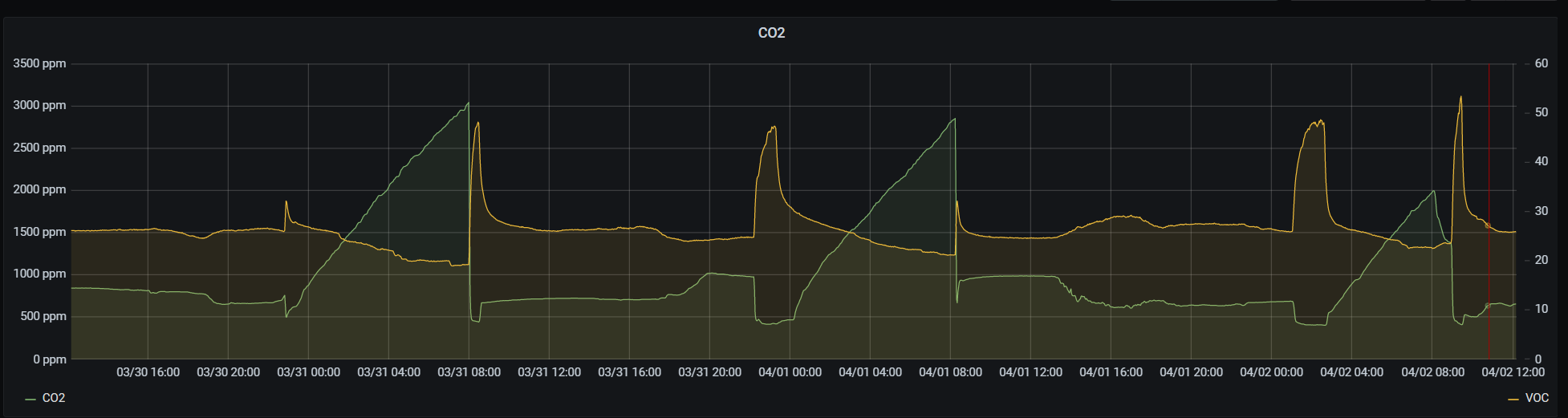

I have the BME680 raw GAS (=Ohms) values plotted here to right axis and to the left axis a very good SenseAir Sunrise CO2 sensor (+-30ppm)
You can easily see my sleep cycles (the linear increase in CO2 in the bedroom while I am emitting CO2 during my sleep in the night) and the steep drop when I open the window in the morning and before going to bed
How do I convert GAS values to IAQ values with EasyEsp or even better, could the plugin 106 do it for me?

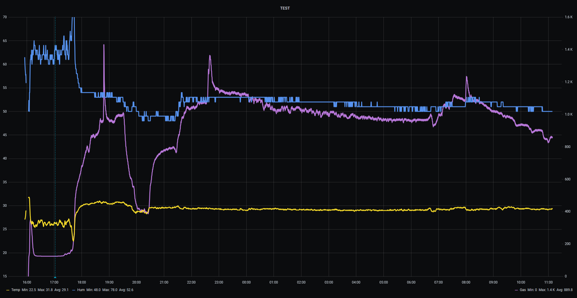

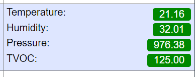

So i've been using release 2.0 from this guy.
put it outside for a few minutes and it dropped to 125 instantly.

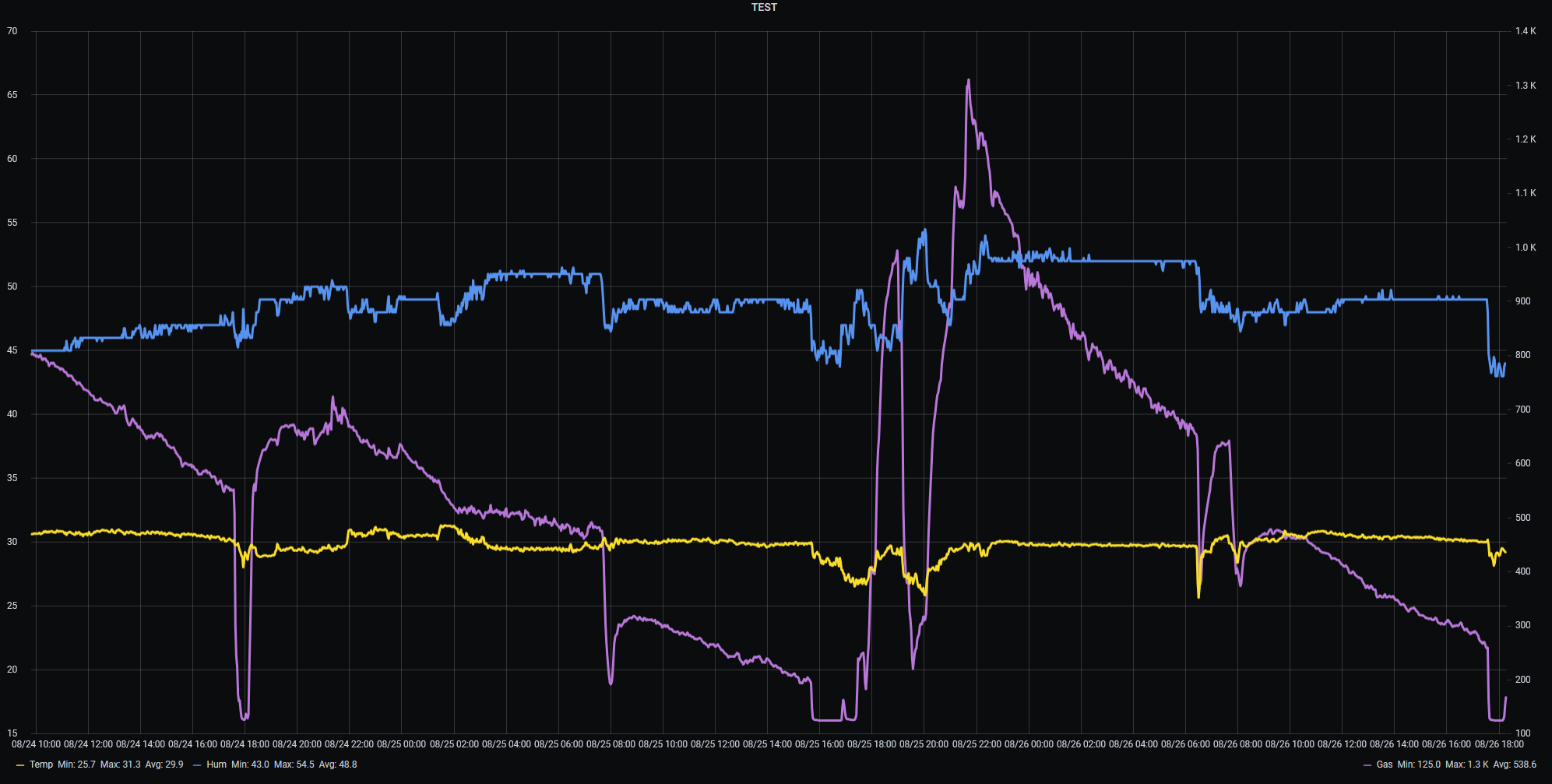

You can pretty much see whenever the windows are open because the temp and Gas drop simultanously.
Screenshot 2021-08-31 210502.png (208.58 KiB) Viewed 6936 times
You can see at the highest peak, thats when we went to sleep. Didn't open any window. and over night it slowly dropped. some really short window breaks at early morning 6 and 8 am. then again dropping slowly over the day because no one was home.
