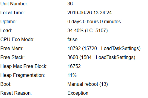

I'm sorry, I can't get a screenshot uploaded, getting the message "Sorry, the board attachment quota has been reached."
The core version of the release 2018-05-22 is definitely 2.4.1

Re: Hardware Watchdog Reboots
Uptime of 17h or 20h are no sign to have found a solution.
The graph shows the uptime in minutes of a device, Wemos D1, INA219, DS18B20, MQTT to Domoticz, http to another server, connected to the other esp. As you can see, randomly the device is running a few day, then again only some hours. The device ran in same configuration (as well as three identically cofigured others) >100 days with the version form 2018-05-22.
Documentation of The stable build:
Currently used build:The graph shows the uptime in minutes of a device, Wemos D1, INA219, DS18B20, MQTT to Domoticz, http to another server, connected to the other esp. As you can see, randomly the device is running a few day, then again only some hours. The device ran in same configuration (as well as three identically cofigured others) >100 days with the version form 2018-05-22.

Bit of an update:Shardan wrote: ↑25 Jun 2019, 12:59 Now three devices running with 20190607 on 2.5.2 core as the 0523 version has shown too many problems.
One is a room sensor, just with a SI7021 and a DS18B20, no rules at all: Many restarts, every 2..3 hours for now, heap fragmentation 11% - 12%, free mem 18936, free stack 3600, heap max free 16960
A rain sensor with rules: Restarts about every 24hours, heap fragmentation 7%, free mem 18976, stack 3600, heap max free 17688
A fully equipped weather sensor with lot of rules and 12 tasks used, restarts after 2..3 days, heap fragmentation 3%, free mem 17.200, stack 3600, heap max free 16760
I'm syslogging the room sensor now and report back
Restarts seem to be random.
The Syslogging doesn't say anything, it just stops.
Main page says
which is not very enlightening at least to me.

Ooops, sounds not good.georgep wrote: ↑26 Jun 2019, 15:15 [...]
{EDIT} I just spotted that my Sonoff unit running ESP_Easy_mega-20180522_normal_ESP8285_1024.bin has just rebooted! Isn't this supposed to be the reliable one?
The display shows:
[...]Code: Select all
Local Time 2019-06-26 14:16:20 Uptime 0 days 0 hours 37 minutes Load 7% (LC=11703) Free Mem 18288 (16912 - sendContentBlocking) Boot Manual reboot (1) Reset Reason Hardware Watchdog
I swear with that release (difference: Wemos D1, ESP_Easy_mega-20180522_normal_ESP8266_4096.bin) I didn't notice any wd reboots during the time they were running on it, I remember uptime >100 days when I flashed them in January - when my problems started.
Prob. another difference: You did a clean flash, blanking the device before, did you? In May/June last year mine came from mid March release (first flashing), and were upgraded to a version I think I remember 18th of April (veeeery slow Web GUI) and finally ended up in the version of 22nd of May, all without blanking them.
