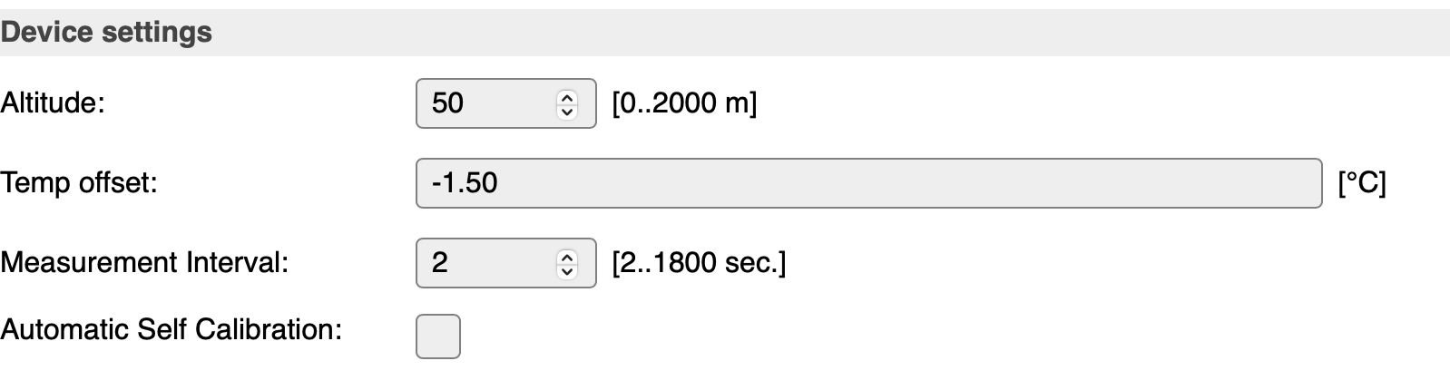

Re: SCD30 - CO2 sensor
I didn't know I had to click on Summary
I updated one sensor.
Activated ASC (The ABC label is probably a mistake)
scdgetabc now returns 1
I'll see what changes over time.
I can test on another scdsetfrc sensor
The question is when I set it, how do I verify if the value is in the sensor?
The build you downloaded and tested is already outdated
I have just pushed some more commits (and earlier too, fixing that ABC to ASC and a bug inn setting the FRC), hopefully this time Github actions won't fail for no apparent reason.
Please re-download and test the latest build from the PR, TIA!

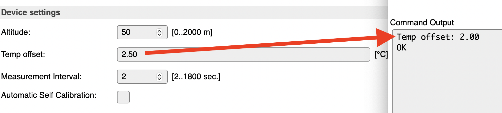

Did some one test to adjust the temp offset for the sensor?
My sensor shows to high temperature so the offset should set to -1.50°C but it seems not working.
Is there a trick?
Thanks and regards ....Carsten
Is there a trick?

I quickly checked the plugin code, and the temp offset is supplied to the sensor driver at startup, and using the 'scdgettmp' command, retrieves it from that same driver again.
Do you have multiple SDC30 sensor-tasks configured (and active) on that ESP, where the first one doesn't have the offset configured?

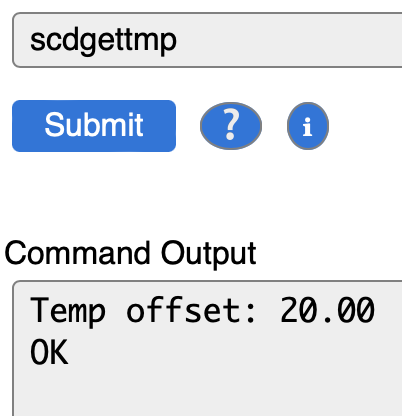

Thanks,
that was what I read in the docs.
No, only one SCD30 sensor and one non active BME280 sensor (deactivated, the temp offset for the BME280 works).
========= EDIT
offset in positive is also not working
========= EDIT 2
strange, now offset from 20 and the temp is falling down (it takes some more time that the sensor makes the offset)
ambient temp here is 25^C ========= EDIT 3
The humidity is also affected from temp offset ...lower temp more humidity (see pic), ambient hum is here 55%
Build: ESP_Easy_mega_20220616_test_D_ESP8266_4M1M Jun 16 2022

========= EDIT
========= EDIT 2
Ok, great.
All technical functionality is left to the device & driver/library used, 'I'm only playing the piano'CaWi wrote: ↑20 Jun 2022, 11:28 strange, now offset from 20 and the temp is falling down (it takes some more time that the sensor makes the offset)![]()
You might want to compare your notes with the documentation available at Sensirion, especially the Field Calibration application note might be helpful: https://sensirion.com/products/catalog/SCD30/
Thanks for all helping.
In the last week I did the calibration and it works (after new flashing the ESP) without "Restarting the calibration".

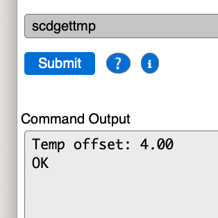

A little problem,
Ambiente temp is 27°and the SCD30 shows 31°
The temp offset is set to -4.00°
Is there a bug with the temp offset?
Settings: scdgettemp outpt: I remember the that I saw this before ... actual FW: ESP_Easy_mega_20220809_collection_D_ESP8266_4M1M Aug 9 202
I didn't know what I'm doing wrong with the forum sw.
- Bildschirmfoto 2022-08-13 um 17.20.20.png (6.76 KiB) Viewed 183156 times
I've had a look at the code, and the plugin is doing everything as expected, it's the SCD30 sensor (and library) that has a twist:
if (offset_degC >= 0)
offset_centiDegC = (uint16_t)offset_degC * 100;
return sendCommandArguments(COMMAND_SCD30_TEMPERATURE_OFFSET, offset_centiDegC);
return ERROR_SCD30_INVALID_VALUE;
This is not reflected in the plugin behavior, but can be changed.
I'm not sure if this either can or needs to be 'fixed' as the chip doesn't allow negative compensation. It can be a relative value, so what is the result if you set it to 4?
Value set to 4:
scdgettmp:
