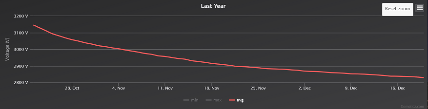

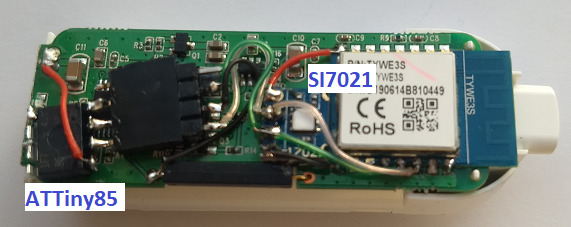

A doorsensor has gone life in production in my home as of yesterday, controlling the "meterkast" lights. Acts much better than the original version and no Chinese tuya cloud involved :D
The temperature sensor is in test with some dangling wires to the ATTiny and an SI7021 attached. So no pictures yet.
I first need to verify battery life with a 10 minute boot interval. If this looks promising, I will build the final hardware version. I already figured out how to include the SI7021 in the original case.

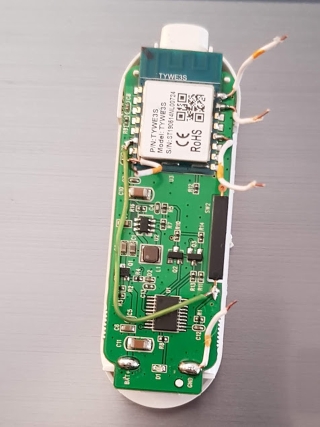

Neutrino
Posts: 5
Joined: 10 Sep 2017, 14:41
Re: New hackable ESP gadgets in local budget store "action" !!!
#71 Post by Neutrino » 17 Nov 2019, 19:05
Hi !
Door sensor owner here :)
I just connect the reed to GPIO13.
It works since 25/08 without battery replacement.
You do not have the required permissions to view the files attached to this post.
Flying Domotic
Posts: 37
Joined: 27 Aug 2019, 23:57
#72 Post by Flying Domotic » 18 Nov 2019, 10:13
Doing so, you've got an ESP powered only when contact changes, and can read contact value on GPIO 13 without need to board TUYA protocol, right?

Neutrino
Posts: 5
#73 Post by Neutrino » 18 Nov 2019, 16:13
That's right.
When contact changes, the esp power up connect to m'y AP and updates domoticz through http.
Then, the sensor is power off itself.
I use it on my fridge, not on a major access.

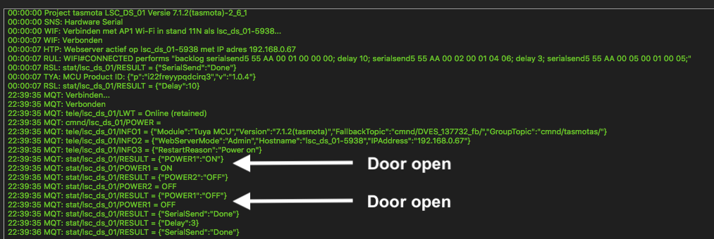

I have a working lsc doorsensor.
I use tasmota v7 with the commands below in the console command line
module 54
backlog TuyaMcu 11,1; TuyaMcu 51,51; TuyaMcu 12,3
rule1 ON Wifi#Connected DO backlog serialsend5 55 AA 00 01 00 00 00; delay 10; serialsend5 55 AA 00 02 00 01 04 06; delay 3; serialsend5 55 AA 00 05 00 01 00 05; ENDON
rule2 ON TuyaReceived#Data=55aa000200000155aa0005000501010001010d DO POWER ON ENDON
rule3 ON TuyaReceived#Data=55aa000200000155aa0005000501010001000c DO POWER OFF ENDON
restart 1

#75 Post by Robvs » 02 Dec 2019, 12:06
Hi patrick
can you explain how you us the device. does it report trough mqtt, do you use homeassistant or domoticz.
I want to use your code and iam using domoticz.
EDIT: I can confirm the solotion that patrick offers works! I used tasmota 7.1 firmware specifcly the tasmota.bin version (this has domoticz tab) to flash the firmware of the doorcontact (did use wired flash not OTA). In the console I pasted the code that Patrick wrote up!.
Then I set up Domoticz on a Rbpi and set up Mosquitto MQtt as well. Then I added a switch device that I configurerd as a doorswitch.
Then I filled in de MQTT information in the doorcontacts tasmota MQTT menu (You have to keep te doorcontact from shutting down by constantly adding and removing the magnet side or you can do it while the doorcontact is still connected to the flashing hardware (it powers the WIFI chip directly)).
And voila ...its works!
The doorswitch does take 5 seconds to switch a light after the realtime state is changed (eg the magnet is removed or added)
is there any way to make this faster?
great work!
Sincirely Rob

Joined: 16 Dec 2019, 22:35
#78 Post by duhen » 16 Dec 2019, 22:48
@mrrose
Two Toggles are OK. Toggle 1 is the one to keep track of.
Mine is functioning fine, I get my MQTT messages on topic: stat/lsc_ds_01/POWER1
I entered the rules in the order Rule3,Rule2,Rule1 and then the backlog, because otherwise it's much harder to get the command in time to extend the stay-alive of the ESP-unit with:
Serialsend5 55 AA 00 02 00 01 00 02
Hope this helps you out

FanOfHue
Posts: 96
Joined: 06 Oct 2018, 10:08
#80 Post by FanOfHue » 21 Dec 2019, 14:57
After two months of operation as test device, reporting every 10 minutes, the battery voltage is still ok and the decline during the last month is even lower than the first month:
Looks promising, so yesterday i've build the first two units for production use:
Takes about 30 minutes of soldering and then we're live with temperature and bat voltage charts in Domoticz.
