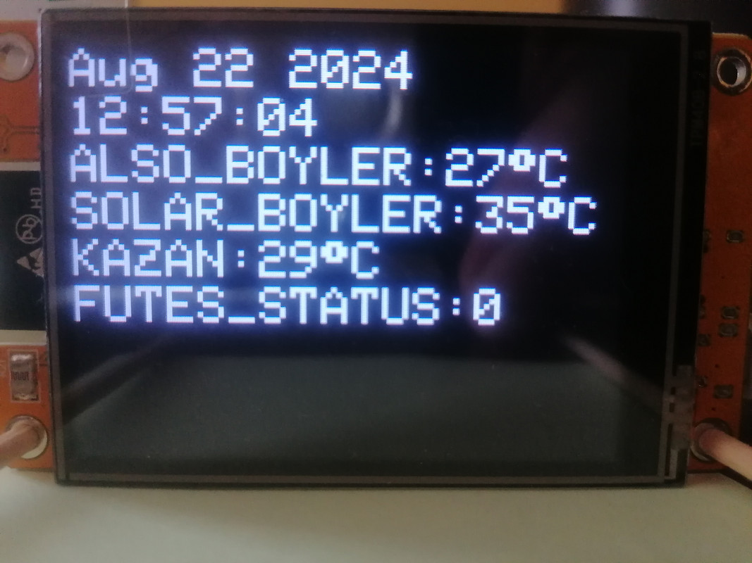

Hi!
udp data is flowing between 2 modules espeasy "BOJER_00 module" variable A/B:[ALSO_BJ#temperature] C I would like to display this on the TFT display of the espeasy "Display" module!?
How to define the TFT display of the "Display" module A/B: [ALSO_BJ#temperature] value to be printed?
"Display" module" c013 plugin Command unknown ?
All module settings in the video!
https://drive.google.com/file/d/1SYGe0l ... FojUN/view
I don't speak English, just google translator! Tankyou!

"display" module TFT only shows 0C, but the temperature of the "BOJER_00" module ALSO_BJ is 23C!
https://ibb.co/vPC6x2S
https://ibb.co/9bzQSjn
https://ibb.co/4FP1Gxr
https://ibb.co/2qDK2JT
https://ibb.co/z7xRwQz
Send to Controller(ESPEasy P2P Networking, enabled) "In module BOJER 00 ALSO_BJ I turn on the setting on the other side Display Send to Controller(ESPEasy P2P Networking, enabled) will be inactive why is this happening because it was enabled before! Endless struggle! What collides with each other?

Result! Thank you for the many helpers who did this!TD-er wrote: ↑26 Aug 2024, 09:01 You had it working apparently and now you've changed stuff so it is not working anymore.
The task on unit ID 1 which actually is reading the temp sensor is now task index 3?
And it is not sending to the p2p controller?
So maybe you should start over...
You have now task index 1 empty on unit ID 2 ("Display")
Leave it like it is, do not touch this!
Setup the temp sensor as task index 1 on unit id 1 and select to send it to the p2p controller.
N.B. use a different task name as the other one, or remove the temp sensor task from task index 3 before adding this as task 1.
Save
Refresh the "devices" page on unit 2 ("Display")
It should have added a new task on task index 1 and should also be updated.
https://i.postimg.cc/mDFJW4Qx/IMG-20240826-125706.jpg
