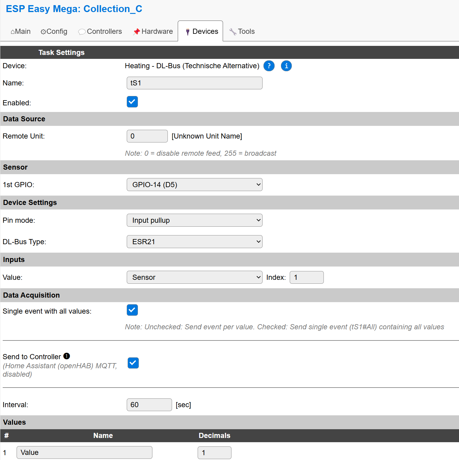

Hello, have I set up the device correctly (see attachment)? The log keeps reading:

51053868: ## StartReceiving: Error: Nothing received! No DL bus connected!

- devices_p092.png (146.61 KiB) Viewed 4428 times
Re: Make ESR31 work - plugin P092 - I need some help, please
Currently it seems no data is coming from the ESR31 to the ESP.
If you have connected the ESR31 to your ESP directly, without a level converter, then it is very likely the GPIO pin has been damaged by the 12V that's coming from the ESR31.
AFAICS, the TX pin from the ESR31 should be connected to the configured GPIO pin to make the connection work (each device TX/RX is 'labelled with itself in mind', so TX of the outgoing device should go to RX of the receiving device).
You can try to connect to a different GPIO pin, with a level converter, of course, and change the configuration accordingly, to see if something is coming in.
