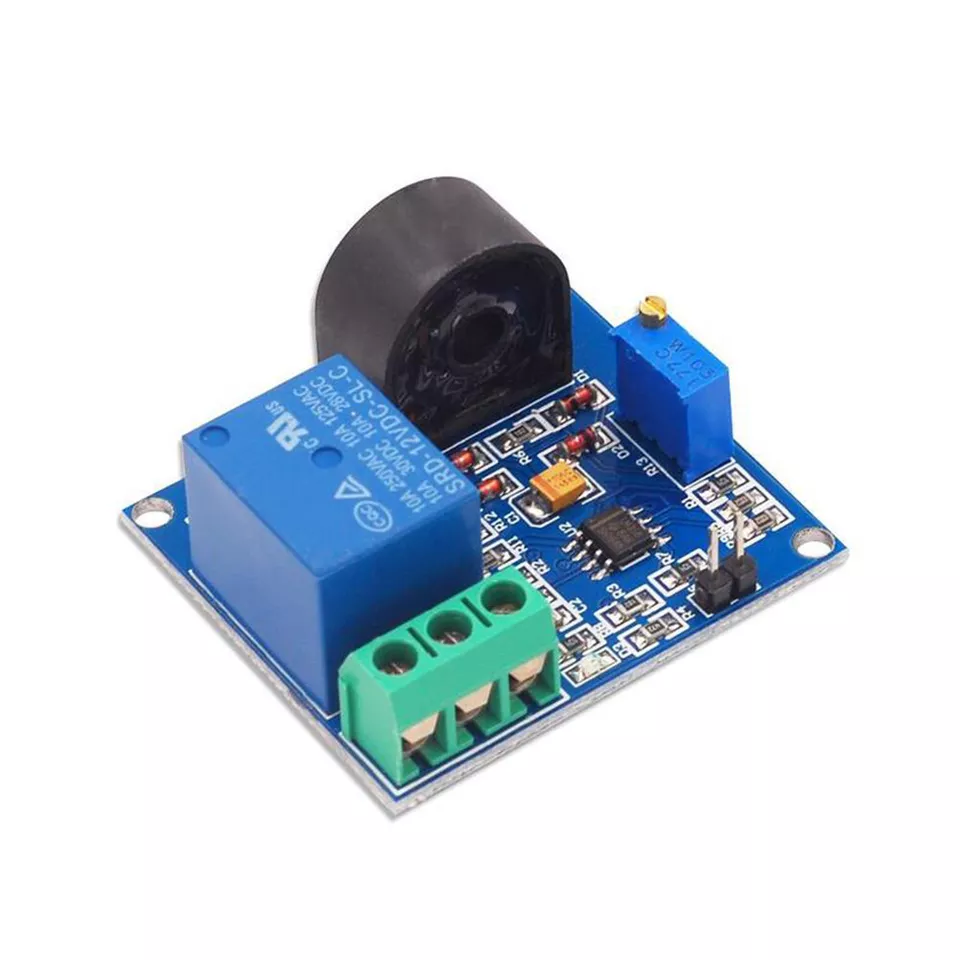

noxin wrote: 05 Nov 2024, 13:37 What I need is simply to check whether a load of around 300 watts is being switched, an exact measurement is not necessary.
This device fully meets your request.

noxin wrote: 07 Nov 2024, 10:57 Sometimes aquarium heaters have a tendency to fail when the temperature is reached, hence the relay.
I think you only need a temperature sensor and one relay module. Use the plugin "Regulator - Level Control" and set up "Email Notifications (SMTP)" to send emails.
A rule that will check the temperature and send you an email about a heater malfunction could look like this
On ds18b20#temperature<22 Do // The temperature dropped below 22°.
   If %Uptime%>30 And %v1%=0 // 30 minutes have passed since the power was turned on.
     Let,1,1
     notify 1,"{jimmydean@domain123.com},Check the heater!<br>Water temperature is 20 degrees.<br>Uptime %Uptime% ","Aquarium"
  Endif
Link to AC Power Monitoring Module
https://www.aliexpress.com/item/4001125 ... ry_from%3A
