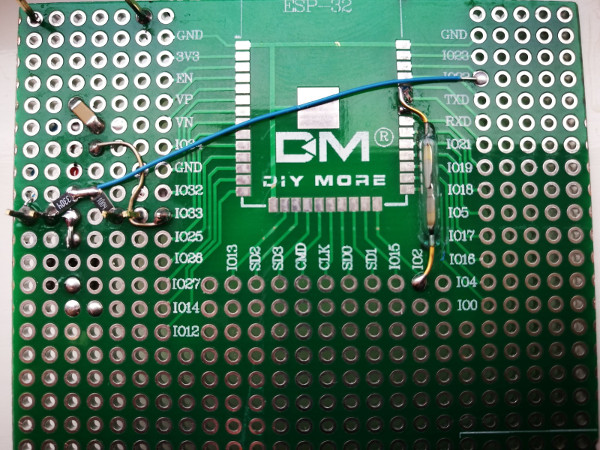

OK, I believe I have made some progress with this. It appears to be working with the following settings:
Circuit: Reed switch (bucket wire) between ground and D5. (Should work for many other GPIO)

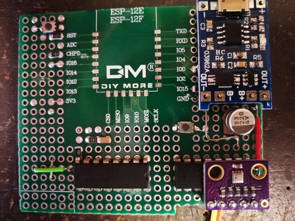

Hard to say exactly what the coating is I can check the bottle but it is supposed to be a conformational coating.
I need to lok at the board again but it is a bmp280 which is not rated for 100% humidity which I think I am getting when dropping air temps cause condensation.

the counter is not working good. it is counting even if no rain. My guess is the cable is to long and make noises or something (5 meters).
i have try to put it as a switch and that seems to work (on/off) but then i loose the counter and need to find a way to make it count and put it in domoticz..

there is not mutch schematic. Between ground and gpio 0 (d8 on wemos d1)
Generic - Pulse counter, counter type : delta/total, mode type : rising.
tried diffrent Debounce Time (mSec): but cant find any diffrent. right now it is set to 5000 .
i have also try to set it as Switch input - Switch and when use that it never got strange activity only shows when the bucket it tipping.

With a similar challenge to the OP, I thought I'd pick up on this thread.
I plan to use a good old CMOS Binary counter to count the bucket tips while the ESP8266 sleeps. The CD4520 is my chosen device which has a quiescent current drain of just 2.5uA.
With a small RC debounce circuit on the reed switch actuated Clock input, here's my proving prototype for this plan in action...
https://youtu.be/XmtVZqeBoqc
I plan to have the binary count (5 or six bits should be sufficient for anything up to a monsoon over 10 minutes) read by a PCF8574 I/O expander. Then (and this is the bit I am currently a little unsure of) in ESP Easy, read each 'bit' as a switch and calculate the count within a rule (1's plus 2's plus 4's plus 8's etc) Unless there's a simpler way!? When this is gathered and sent to the controller (thingspeak initially) a spare I/O on the expander can be sent high to reset the counter prior to the ESP going to sleep.
I have cut down an 8266/32 double sided breadboard to match the board that fits inside the rain gauge and added the reed switch in the same relative position...
(This is the reverse side)
I reckon, with SMD passives, I can get all the components on this board along with a TP4056 Solar charge control board to fit everything including a LIPO battery inside the rain gauge with a Solar panel outside to make it an all in one standalone device. There looks like there is also enough room at the fat end of the PCB housing to fit a BME280 Pressure/Temp/Humidity sensor in there also to complete a full (ish) weather station!

Hi Whatsupskip,
Construction is well under way. I've phased this so that testng can be done as it progresses. First the mount pins for the charger board and the 3.3v LDO regulator and capacitors beneath. The whole power supply side can then be tested first
There's also the resistor bridge across the battery pins for monitoring the voltage on the ADC
Next, I wired the supply rails and installed the IC's , I was able to check the counter IC was working correctly. I then linked all the count outputs to the PCF8574 inputs. The BME was then placed on some pins and I have taken out the I2C lines to be read on a Nodemcu, thus able to check a large majority of the circuit without even installing an ESP on the breadboard yet!
Not looking too bad eh? Yes I get your point about the temperatures and humidity will, though useful for internal status need to be disregarded when the sun is out but they'll be fine in the rain and I only really need the pressure reading anyway. There's plenty of free GPIOs for the option to hang a DSB18B20 out of the unit.
The counter and I/O expander all seems to be working.
I'll cover the Devices and Rule in a later post. I'll plan to use a high pulsing GPIO on the ESP to reset the CD4520 before the ESP goes to sleep (hopefully after a succesful thingspeak controller update if that's possible so no counts are lost)
As for the battery getting hot, I'll ensure that side will be largely shielded by the solar panel. There is natural ventilation inside the unit and I'll probably paint it white to protect it from UV anyway. It's not a production unit after all!

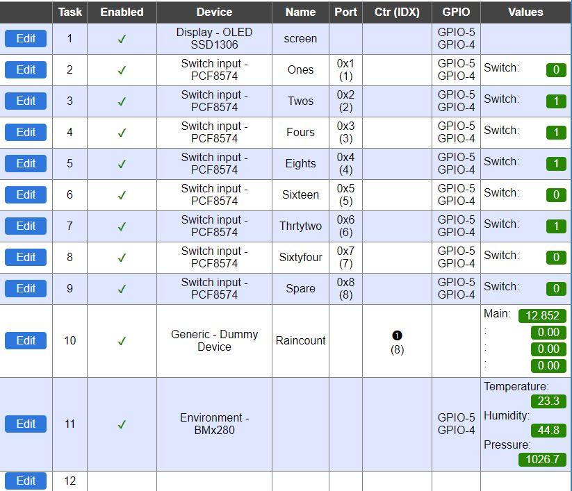

#31 Post by Vic20 » 14 Oct 2018, 16:51
Update: Due to THIS problem I could not use ESP-Easy to continue my project until that was resolved unfortunately.
I therefore decided to use the Arduino IDE and C++ to get it working...
On Wake of the ESP, A "pcf8574.read8()" instruction reads in the count from the Binary counter as decimal which I can multiply by the bucket volume to get the amount of rain over the ten minute period that the ESP was asleep.
The unit sends it's data to Thingspeak and returns to sleep in around ten seconds. A mathworks routine in Thingspeak produces another chart of total rain over the last 24 hours.
It has ran uninterrupted for over a week now on an ex nokia BL5 battery core and a small 6v Solar panel.
I will also get it to send me a Telegram message when it is 'Chucking it down' , a rain rate over a pre defined amount in 10 mins to be determined from evaluation ..just for fun.
ESP-Easy just wasn't that Easy ...though I do miss the ease of reconfiguration/reprogramming that brings.
