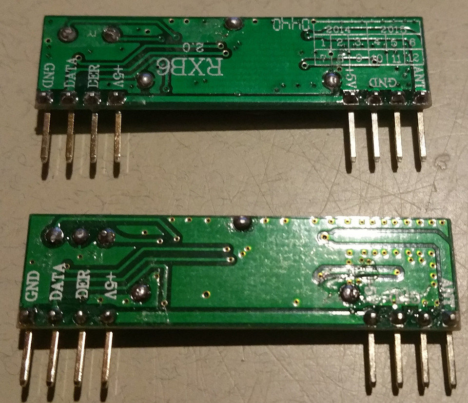

Meanwhile, I received the second RXB6 I ordered.
This one looks different from the first one. Besides a golden Q.C. Passed Sticker (the other one is silver) it has almost no markings.
The first one I received has "RXB6" printed on the back and below it reads "V2.0". Then, there is a timestamp field with 2014, 2015 and numbers 1 to 12.
Also, when measuring voltage on the supposed RSSI pin, the new one gives only values between 1 and 2 volts. (I have no Osci atm)
Connecting the GPIO to the supposed RSSI pin confirmed my expectation: There is no RSSI but the same data-out signal as on the
original data-out pin. So, this one is either a clone or at least not version 2.0 as claimed by the seller.
Is there already a beta Version available with RSSI support? If so, I'd love to try it out with the working one!

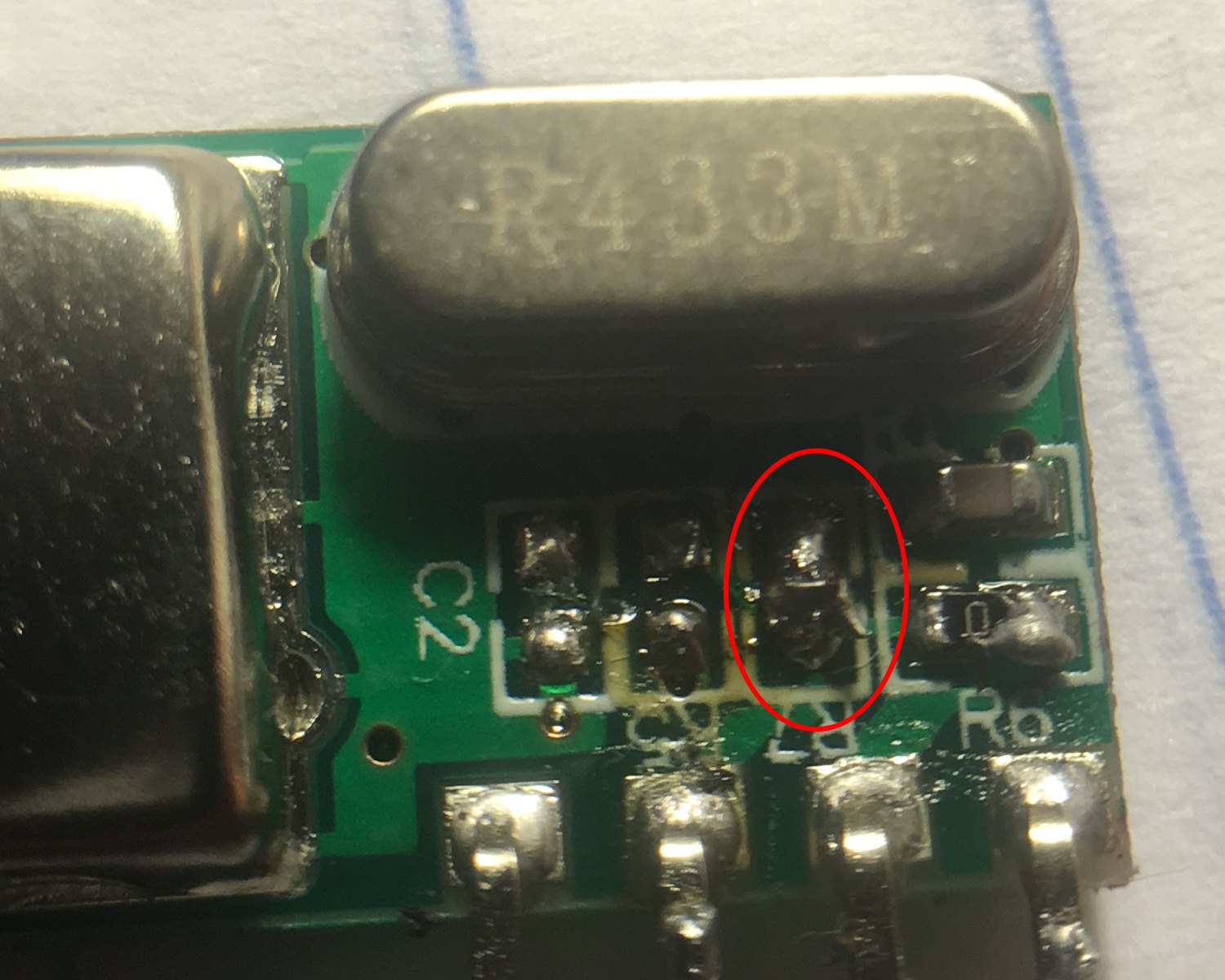

Re: RSSI info / provide signal strength
I to purchased some RXB6 receivers V2.0. They seemed legit, but I could not get RSSI to work. The DER pin was a duplicate of the DATA pin, so I though I was mislead. Then I found the following link on ebay:
http://www.ebay.com/itm/433-92MHz-433MH ... 1631674225
In the description it indicates:
For Pin 6 , it is R/E/D optional , R mean RSSI , E means Enable , D mean Data ( defult).
RSSI mode : please Romove R6 resistance to R7;
Enable modes: please Romove R6 resistance to R5 .
So I guess you just wire across the resistor??
Hope this helps!
Hope this helps!

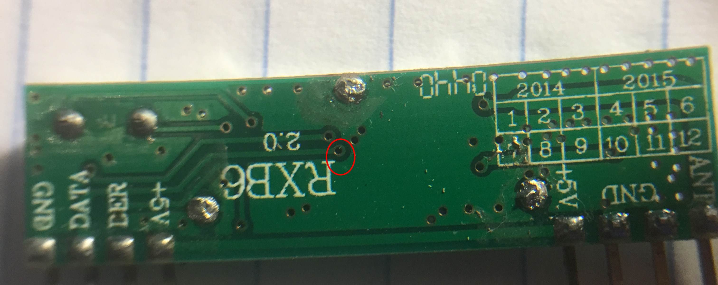

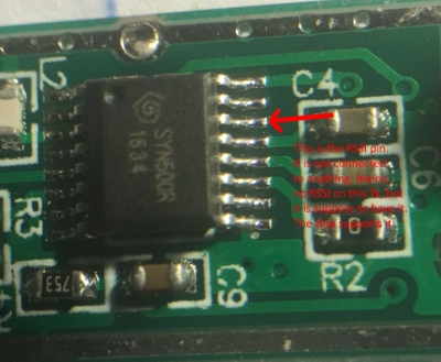

I did some more research. The RXB6 that I have use the SYN500R chip. See the datasheet for the SYN500R chip at http://www.xie-gang.com/SYN500R.pdf
I looked at the RXB6 board and the chip's RSSI pin is not connected to anything (see attached pic).

Both have the R6 with 0Ohm and the others not populated. Version 2.0 apparently provides
RSSI, the other one does not.
Can you make a photo of the back side of your module and upload it here?
- rxb6-back_960.jpg (219.5 KiB) Viewed 42226 times
- rxb6-front_960.jpg (144.84 KiB) Viewed 42226 times

I think I figured it out - at least it works for me. I have the same board as you have (white sticker in your picture). On mine the RSSI was not enabled. I enabled it by soldering the two contact point together in the red circle.
Out of interest, I destroyed one board by taking off the chip to inspect. What I found is that pin 3 (RSSI) on the chip as indicated in my previous post is connected to a pathway on the back of the board leading to the DATA pin. If you solder across as I did, apparently you remove the resistance and RSSI functions properly - at least for me.
Let me know if you try soldering the gold sticker board and it works.

So you've left R6 in place and just bridged R7? What voltages do you get on the RSSI pin?
- Posts: 5
- Joined: 10 Feb 2017, 08:07
Correct, I left the R6 in place and bridged R7. On the board I destroyed, I removed R6 and nothing worked. A little solder dropped on R6 in the pic, but I didn't want to remove it for fear of removing the resistor. R5 I believe is to enable power saving mode, which I don't need, so I didn't try.
The RXB6 is about 2' away from the Tx. With no signal being transmitted, voltage is between ~1.1v - 1.2v (~989 reading in arduino using analogRead(A0)). When the Tx transmit signal burst, voltage drops to ~.6v (~5 reading using arduino analogRead(A0)).
I'm using an Nodemcu 12-E as the board.

Leaving R6 in place and bridging R7 shortens RSSI and Data Output !
I have 2 of these RXB6 (one of them marked with Rev 2.0 - with the white Label Q.C. passed). Both of this boards have the same Layout.
One pad of R7 is connected to pin 14 (RSSI) of the receiver itself (SYN500R) and the other one to the connector pin 6 of the board,
so it should work, to move the 0 Ohm resistor R6 to R7.
Unforunately without success !
No RSSI signal at pin 6 "DER" - Looks like "not connected" or "floating"
Inspected with a multimeter and an oszilloscope.
Did anybody find a solution - respectively: where to get a working board ?
I ordered from the mentioned links and did not receive a 2.0 but one without any marking.
No rssi signal present.
It is useless to implement this if no one is able to get modules that actually supply the signal.
Opening the metal shielding on the module to connect to a chip pin is not the way to go.

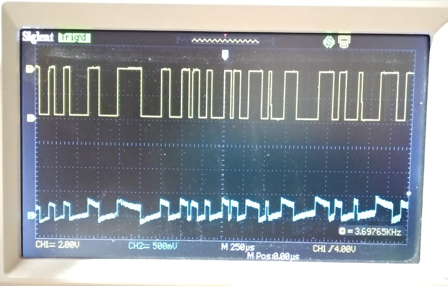

I popped the lid off one of my RXB6s. It turns out that pin 14, the RSSI output has a track that runs under the IC to a via and that goes directly to the R7 pad (the pad nearest the crystal, in the picture).RCcocktail wrote: ↑10 Feb 2017, 19:04I looked at the RXB6 board and the chip's RSSI pin is not connected to anything (see attached pic).
However on my devices, the RSSI isn't much use as a received signal strength indicator. It just seems to be an sample of the input to the data slicer.
The image below shows this. The yellow trace is the logic level output and the blue one underneath is the RSSI output.
It looks like this effort has been abandoned. However if you take a close look at the blue trace you can see that its level is not constant. In other words it is giving a signal strength indication but with the digital data riding on top of it. If you use a capacitor to smooth the output and maybe some proper programming in your sketch it looks like you could monitor the signal strength as desired.
