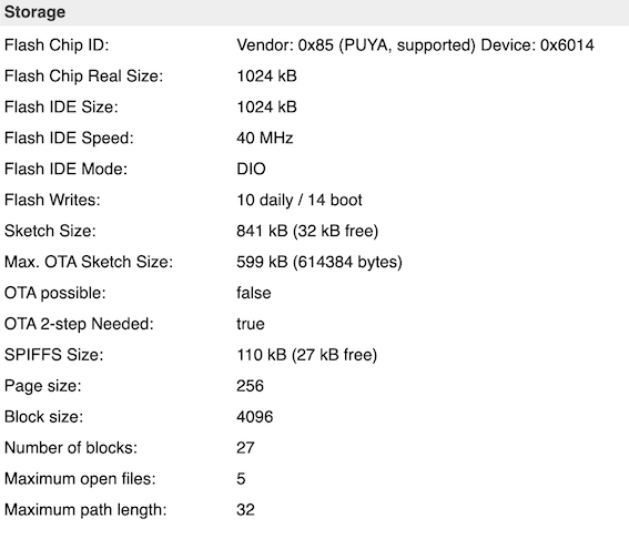

I have ugraded ESP01 to 2M Flash. (they where sent wrongly to my, but I still gave it a try) However, it also says I am not able to make a OTA upgrade. Why? There must be enough room. The flash size is correctly recognized.
Any Idea? However, it works with the 1M workaround.

The flash chip is partitioned in a partition for the sketch + OTA and the SPIFFS file system
A build for 1M flash is only using the first 1M of the flash chip, regardless its size.
But if you have 2M flash, it makes sense to use a 2M build (there are some 2M builds in the nightly builds, but not a lot)
With a 2M build, the SPIFFS is roughly 500k, which leaves 1500 k for the sketch + OTA, so you could use roughly 750 kB builds, or a few 100 k larger builds if you flash .bin.gz files. (only supported since core 2.7.0)
There are also ESP8285 chips with 2M, although I have never seen them myself.
N.B. if you change builds between 1M build and 2M build, the file system will be erased so you will loose all stored settings.

So I used ESP_Easy_mega_20200703_normal_WROOM02_2M256 to flash the ESP01, which works quite well.
It now says OTA yes, and it works...
However I do not know the differences to the normal one (w/Vcc). The time server ntp does not work here. So the time always stays on 1970-1-1
So maybe there is a bug here?

If you don't enter a host for the NTP server, then it will use a random one from pool.ntp.org.
Only requirement then is that it has access to a gateway and DNS server. So please check those are correct.
In the sysinfo page both are reported.
VCC build is about being able to measure its own voltage on the analog input pin.
If you need to read an analog value from some sensor, you don't need the VCC feature.

What is the size of the currently flashed 'sketch' ?
You can see it on the sysinfo page at the bottom.
If it is > 600 kB, you cannot update via OTA, not even when using the 2-step OTA.
Re: Mega (V2.0.0) OTA firmware updates on 1MB modules
But the line with "OTA 2-step Needed: true" is misleading then. Right?!
For me, this implies that a two-step OTA is possible.
The line above states it is not possible right now.
The check for "2-step OTA needed" is simply this:
On 4M units, the free sketch space is more than the max. sketch size, so you never need to use 2-step OTA.
On 2M units, the space for the active sketch + OTA sketch is roughly 1.7 MB, so it is possible the running sketch may take more than half this 1.7 MB and then you may need to perform 2-step OTA, but it will always be possible as the smallest 2-step OTA image + max sketch size is still less than this 1.7 MB
On 1M units, you always need 2-step, but is not always possible as the max. 2-step OTA builds must be smaller than ~600 kB.
You can still flash larger images on 1M units, but then you will not be able to perform an OTA update.
const bool otaPossible = freeSketchSpace >= smallestOtaImageSizeNeeded;
use2step = freeSketchSpace < currentSketchSize; // Assume the new image has the same size.
