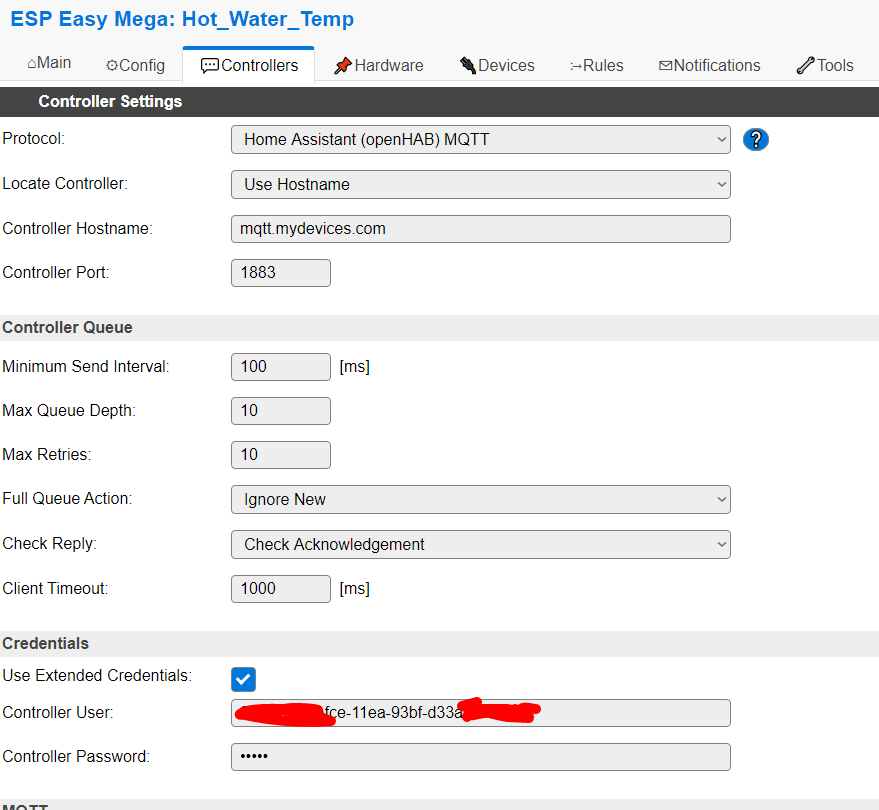

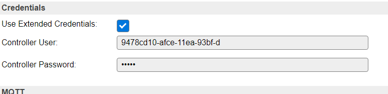

Hmm. Doesn't seem to work on my side. I am running the mega-20200608 and when i input the Controller User. It cuts off 30% or so. Is that only a GUI problem or still not fixed?

Re: Intigrating ESP Easy to Cayenne
It's only visual, it should work.
Have you reloaded the page after turning on the extended credentials? (and saving)
It could be the input field uses a max. length which is set based on the state of that checkbox at loading the page.
Yes. The extended credentials works fine. *Thumbs up*
