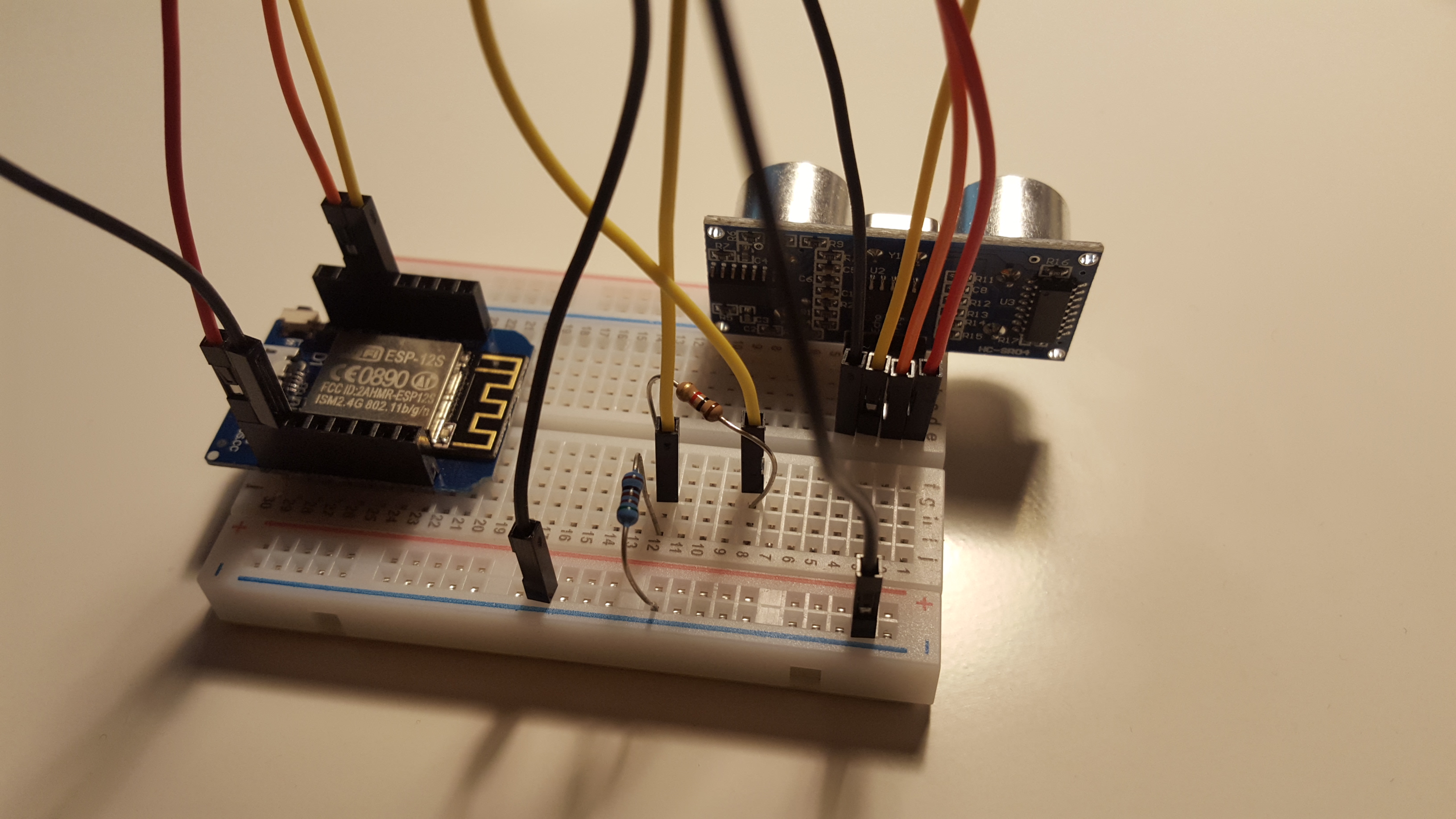

i don't have a HC-SR04+, just some HC-SR04 (without the "+").
If they are driven the same way it's not too difficult to connect.
The HC-SR04 needs 5V so signal levels need a level shifter.
Anyways the trigger input can take 3.3V so there is no problem, just connect.
The echo output is just an output so level adaption can be done with two resistors.
Configuration is as easy:
Make sure you don't swap trigger/echo accidentally - output always need the resistors.
Hope that helps

Re: HC-SR04+ and wemos d1 mini pro
Thanks you Shardan.
Yes the HC-SR04+ is similar, only difference is that only need 3.3V, so I probably can connect it to 3.3V pin and than not need any resistors?
Is possible that I power sensor from external supply, so then I will put on wemos only triger and echo pins??

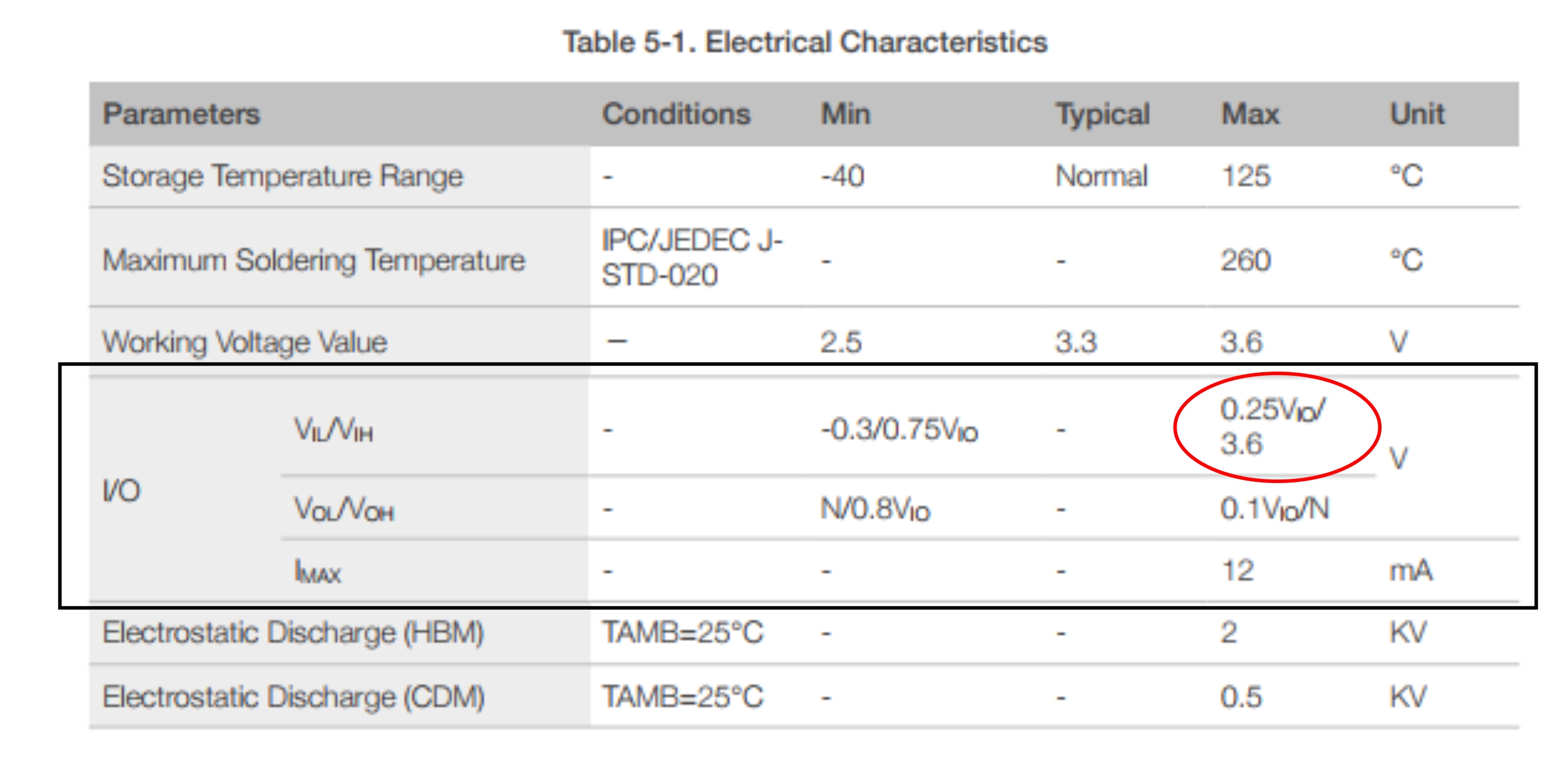

"Espressif CEO Mr Teo Swee Ann commented that “i can reply officially here: it is 5V tolerant at the IO. while the supply voltage is at 3.3V.”
Page 17 of ESP8266 Datasheet it is mentioned “All digital IO pins are protected from over-voltage” ( 6V )
Of course some serial safety resistors are always very useful ( even with 3.3V - it can damage GPIO too with wrong configuration ), but this is something different than voltage divider.
For example with i2c bus connection is good news, that we do not need voltage converters between 3.3V and 5V.

The Expressif ESP8266 datasheet can be found here:
http://espressif.com/sites/default/file ... eet_en.pdf

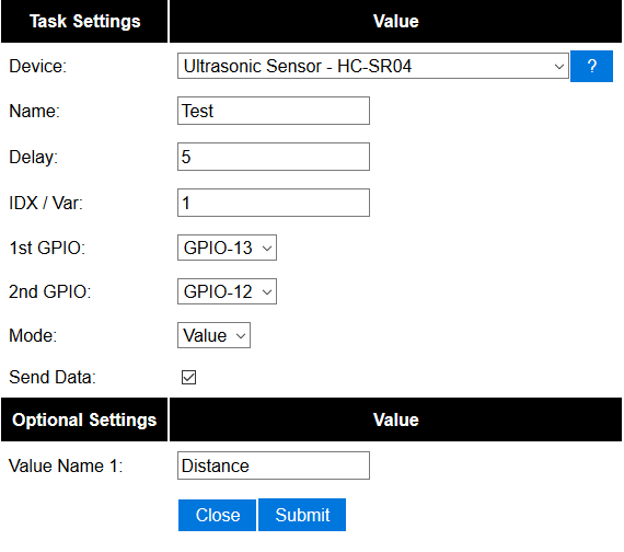

For I/O voltage it says for input values Vi:

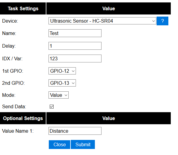

Now I finaly connect my wemos d1 mini to ultrasonic HC-SR04, but it was not reading distance.
in log I see: 523491 : SR04 : Distance: SR04 : Distance: No reading!
In GPIO-12 I connect Trig, in GPIO-13 I connect Echo

If it is not the "+" version, no surprise. The gpio being 5v tolerant or not, the US needs 5v logic level to drive the speaker to send out a ping

you need to connect it to the gpio by using a 3,3/5v logiv level converter, all the info is there
check the wiki
https://www.letscontrolit.com/wiki/index.php/HC-SR04
https://www.letscontrolit.com/wiki/inde ... _Converter
My suggestion is to use a 5V power supply and a bidirectional level shifter. They are dead cheap and it works

The output signal gives 5V, I'd be carefull with that. Many people tell the ESP is 5V friendly on the inputs...
If it really is or if it just can stand 5V on input for a (short?) while and might die later stays vague.
Whatever people say: The ESP8622 datasheet says inputs are not 5V tolerant and working with 5V at input can't be guaranteed.
Thats an instance I trust far more then an "it works for me" result from a few tests.
Anyways in this case a level shifter is not necessary, two resistors do the job quite well.

Are this settings for GPIO 12 and 13 are ok, or I must set something?

My sensor HC-SR04 still not working. I try with sepparate power the ultrasonic, but no luck.
Can you please check my connections and settings, now I power Wemos via USB adapter (5V).
Hm.. looks good to me, as far as i can see.
That was my testing setup:
It's same and worked, powered with a thick USB cable from my computer.
So what to do?
Check all cables first, a digital ohm meter helps a lot.
I've seen alot of these cheap DuPont cables having slack joints or no connection at all.
Breadboards are somewhat susceptible for bad contacts too.
So in settings must be:
- 1st GPIO set to GPIO-13, where Trig is connected.
- 2nd GPIO set to GPIO-12, where Echo is connected.
Is that ok?
Is that ok?
Yep..
Just it does not hurt if you swap accidentally, the device will just show 0.00.
If you doubt about that, swap the cables for a test.
