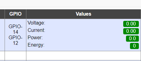

Still not working. With the new library even log show nothing
I have checkd hardware again with Atmega 328p (same library for arduino) and esp12 with wi-fi_iot firmware. Both are working fine.
But when I change firmware to ESPEasy - I still have always 0.00V
Last try i just checked answer from PZEM on the receive pin of ESP. Its looking so good but I think that, then ESPEasy do nothing with the signal))

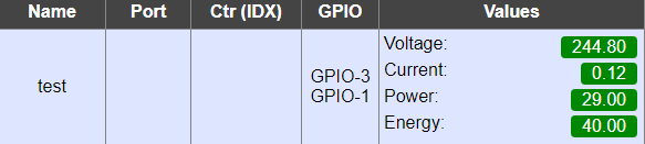

Finnaly Ive beat it
Just replace pzemTXpin and pzemRXpin with hardware pins 3,1 in the plugin code.

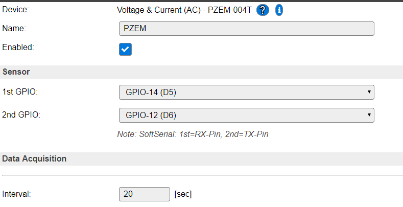

Re: Can't compile with a new plugin (PZEM004T)
Great !
It means you used hardware serial RX/TX, doesn't it ?
Normally, you should be able to change it directly in the web interface. But first, you must disable serial log in the advanced page.

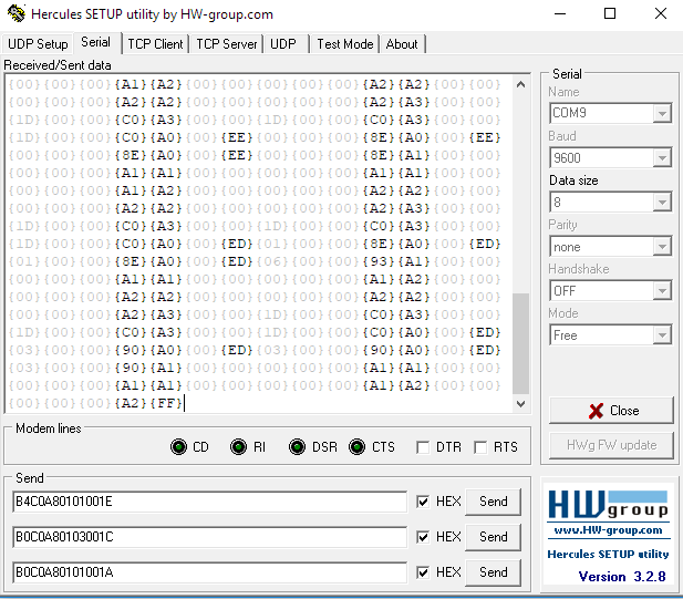

For me it does not work too.
But i get connected another uart converter to tx from pzem module and it send data, but showing only zero values on devices page.
Below is a scrren from hercules due sending data from pzem module.
I tried changing pins, enabling input, comile with different cores etc. and still unfortunately it does not work for me.
###edited###
Ok on HW UART is working well
To enable Hardware uart for pzem need to disable it on advanced page.
