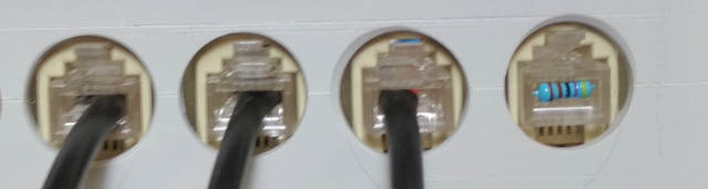

I made simple PCB and connect DS18B20 to VCC, GND and data to GPIO1(TX) + 4k7 resistor between data and vcc.
It works very bad. Sometimes I can scan 1-2 DS18B20 sensors, but in most cases I cannot see any sensor. I have connected 4 sensors.

I have RJ11 splitter. One of RJ11 connector have 4k7 resistor - about 15 centimeters long wires from Sonoff PCB. DS18B20 have about 1 meter cable.
