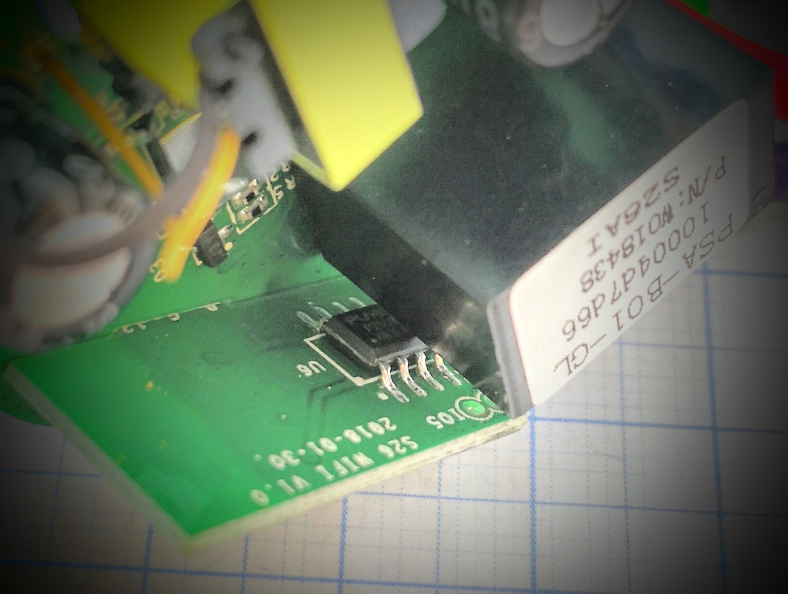

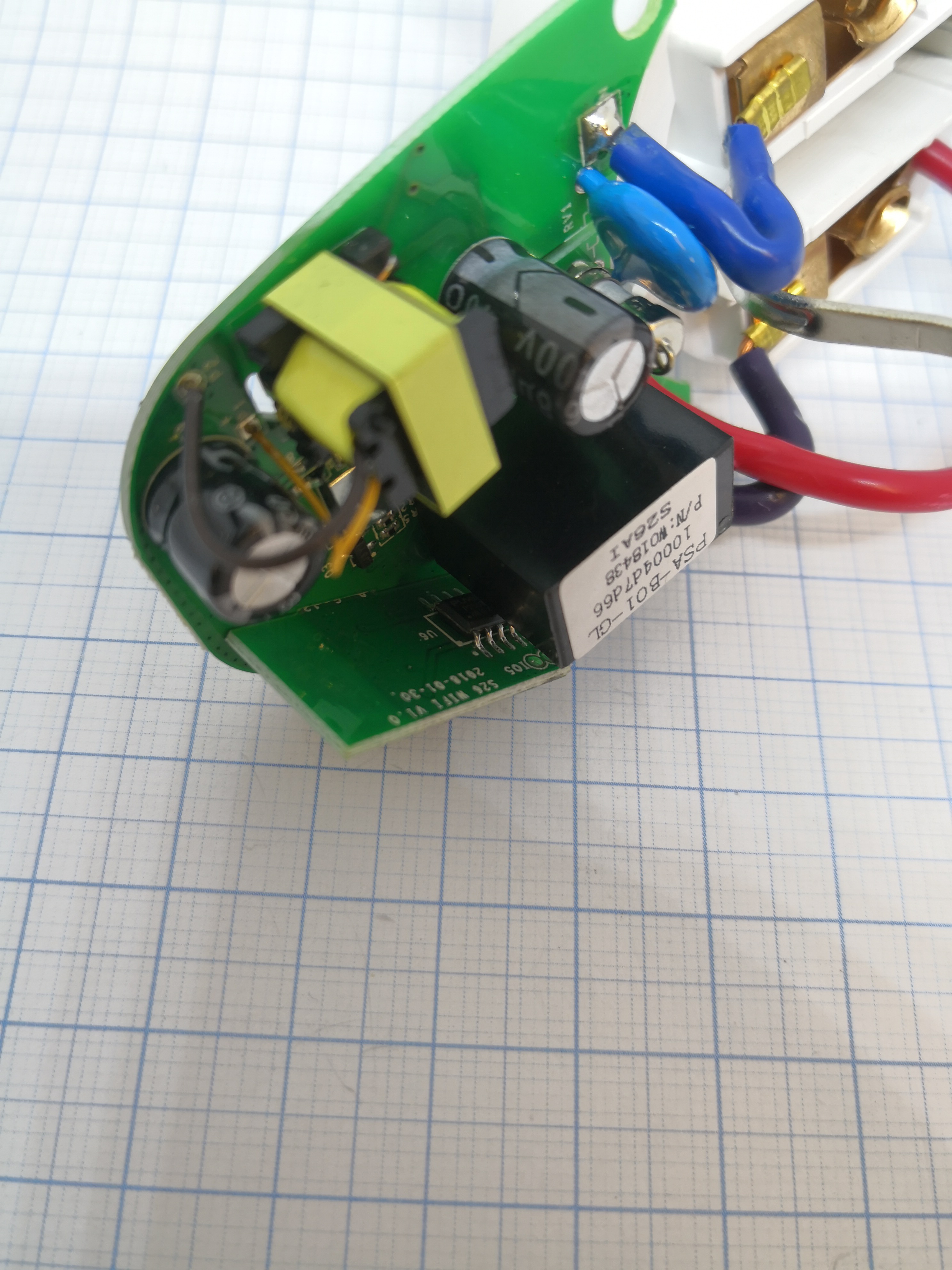

Can you get a close-up of the ESP and flash chip?
Or write down the text on these chips.
Re: ESP Easy on Sonoff S26
There it is... PUYA...
- IMG_20181024_201408.jpg (1.45 MiB) Viewed 16386 times
- IMG_20181024_195905.jpg (1.21 MiB) Viewed 16386 times

Closer look
- IMG_20181024_201408~2.jpg (258.29 KiB) Viewed 16385 times
So you'll need the PUYA builds, I guess?
We really should take care of patching all builds with Uzi18's patch, so it is no longer important to have a separate PUYA build.
Yes for sure. More companies will follow...

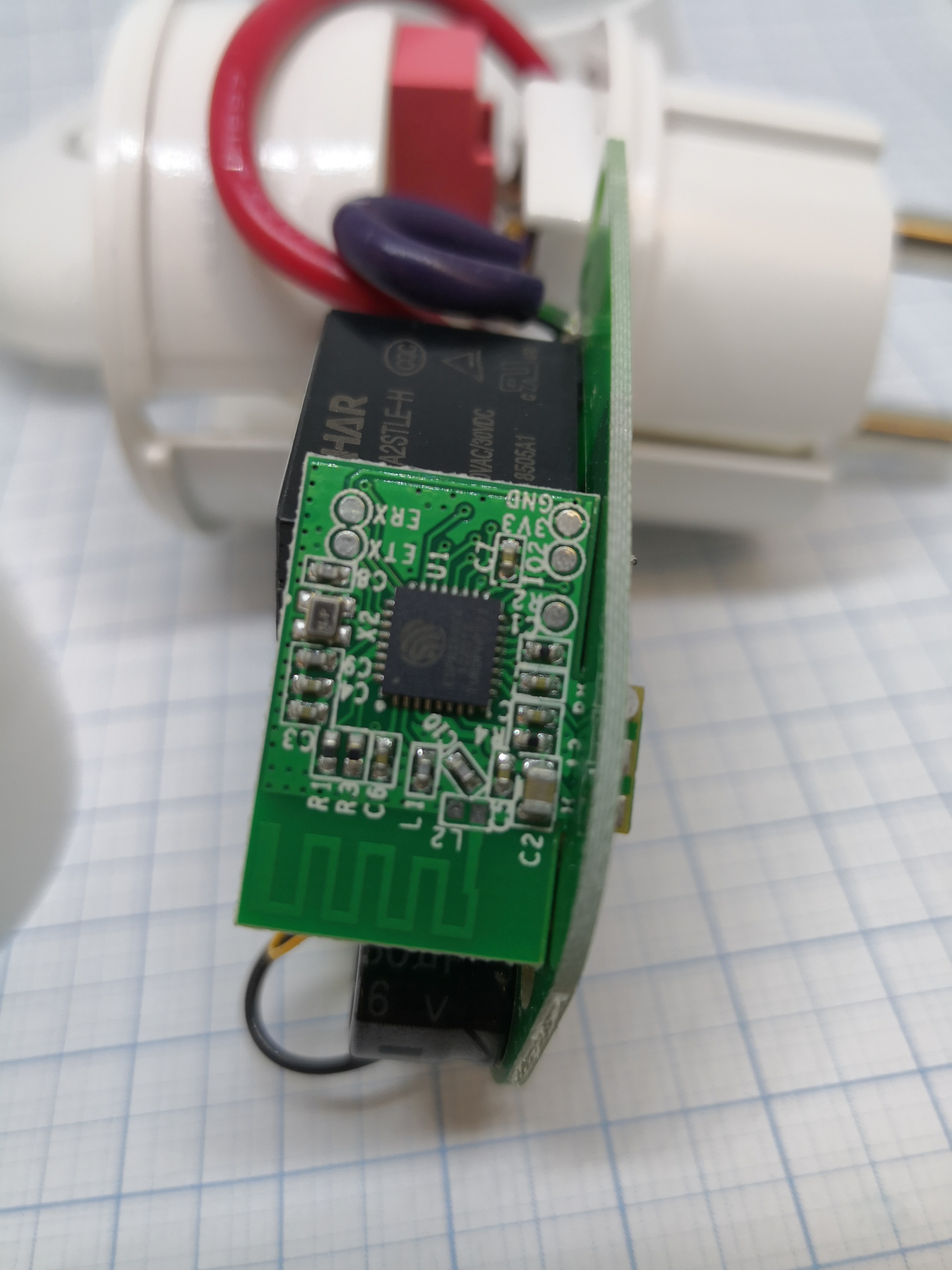

I bought them on eBay. It is very nice to have 4MB on the Sonnoffs. But meanwhile I'm building my own hardware around the ESPs
- IMG_20191213_170947.jpg (160.65 KiB) Viewed 12740 times
