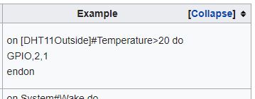

i just tried to make some sort of thermostat. These are my devices:
And this is my rule same as you can find in the wiki:
on [tempsolar]#Temperature>20 do
   GPIO,13,1
Wiki:
But even the temp is over 20. The Value of the GPIO13 always stays at 0.
I am not a friend o the rules because i m no coder.. but how can i even mess up the most simple thing?

Shouldn't it be :
On tempsolar#Temperature>20 do
instead of :
On [tempsolar]#Temperature>20 do
-D

iron wrote: 28 Dec 2018, 10:40 Shouldn't it be :
instead of :
-D
Indeed... It's always the small thing things. Thanks. Works now.
Maybe it's time to update the wiki. Two people struggled with it within two days.
