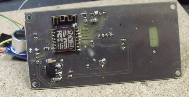

Hello all,
some weeks agon i've designed a clean PCB layout for the HC-SR501 and some more sensors,
(HC-SR04 ultrasonic distance, door contact and humidity + temperature)
I want to use it as a server room surveillance device.
The prototype PCB's arrived some days ago and one device was assembled some days ago.
And a miracle happened......
There is no pull up resistor or capacitor added to the circuits.
It's test running for a week now and did not give false positives up to now.

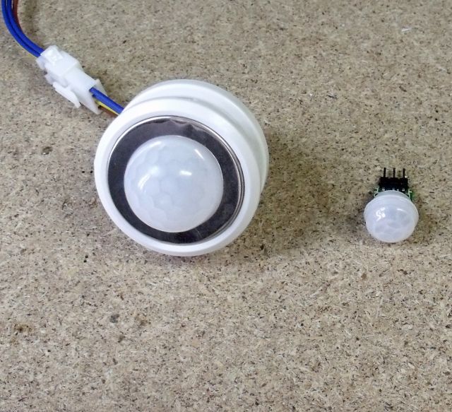

For my curiosity i tested two other PIR's. A mini sensor and a
bigger one for 230VAC mains. The small one works similliar to the HC-SR501,
but it can't be adjusted on runtime and sensivity, but works.
The bigger one works too but is made for placing in the ceiling, not suitable for ESP-circuits.
As far as a can say atm all three show false positives with direct sunlight.
I agree with toffel that the sun is a massive IR source. The outside sensors i know
are made for lighting. They have an additional daylight sensor and switch off over the day.
Even the cheap 230V sensor i tested is able to deactivate over daylight time.
We use PIR's for the alarm system in our company. They are not allowed to be placed
in direct sunlight due to possible false positives.
There might be PIRs that are compensated against sunlight. Hoenstly i've never
seen one or could test one. I doubt if you can get it for a dollar at your dealer anyways :)
You do not have the required permissions to view the files attached to this post.

@Shardan
You should have spent your antenna keep-out region a bit more size - except ruining the RF performance was intended :D
At least it might help avoiding false triggering by RF.
Posts: 1156
Joined: 03 Sep 2016, 23:27
Location: Bielefeld / Germany
Re: HC-SR501 PIR - stop false positives?
#34 Post by Shardan » 24 May 2017, 16:49
Intrestingly i just used a ready made footprint for the ESP-12/E/F from my layout program...
and this is one of the strongest signals i get even on distance through walls.
Don't ask me why - high frequencies have their very own rules.

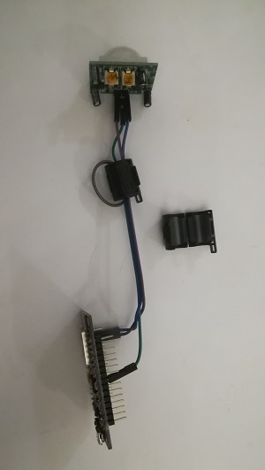

One solution I have tested with success is to put a ferrite core close to the PIR sensor. When the ESPeasy is too close (few cm) from the PIR, the WIFI HF is detected and generates false positives. Power and signal cables act as HF antenna.
Pass the 2 power cables and the PIR signal cable through the ferrite. If you can, you can make additional turns to improve the efficiency.
You can buy cheap ferrite core on Ebay.
André
