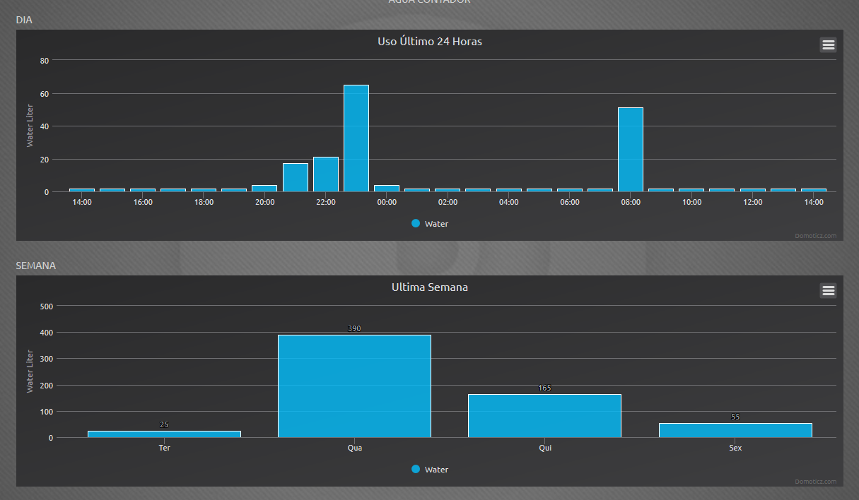

Hi again now that i'm at home i can do some testings. Here are the results:
Using this settings:
Debounce time: 100
Interval: 60
Formula: %value%/477
My log over esp is this one:
Has you can see i do get a value under the "Contador_agua#Count=0.012"
And on the "Domoticz: Sensortype: 6 idx: 2487 values: 0.115;8389.000;211.000" the strange thing in here is that i don´t receive any value on the domoticz dummy counter sensor.
How can this be fix?

In the last two days i have been workin on this sensor. Up until now i have seen that this sensor is not giving reads under 1 Liter and the day counter has a difference comparing it to my water supplyer.
I steel have some doubts about this value "477 pulses" for 1L.... in some situatios for example a discharg off 6L i get an accurate reading but the difference in the end off the day comparing this water flow with my water supplyer i would like to fix this difference.
Heres some imagens for the setup and data stored on domoticz server.
Device setup on esp easy: Data stored on domoticz side: Hope this can help others on setting up this and other identical water flows.
And thanks to all that gived me a hand on making this water flow work.
Edit my post to show the images.

Re: esp8266 and water flow SEN-HZ43WB
The difference is less than the official meter.
On saturday i had to give the water total that i spent last month and the difference was less than 100L.
Now lets not forget that i started this project on 21 off May and i give my readings on saturday 25 sow in 4 days i had a difference off 100L its a bit too high this differenc.
I'm thinking on trying another water flow meter like you said Domosapiens.
In the end off the month i want to have the most accurate readings and history off my water has possible.
Why? Because my water meter is ons a difficult place to access and i'm suspecting that my water provider is not being correct on my readings.
