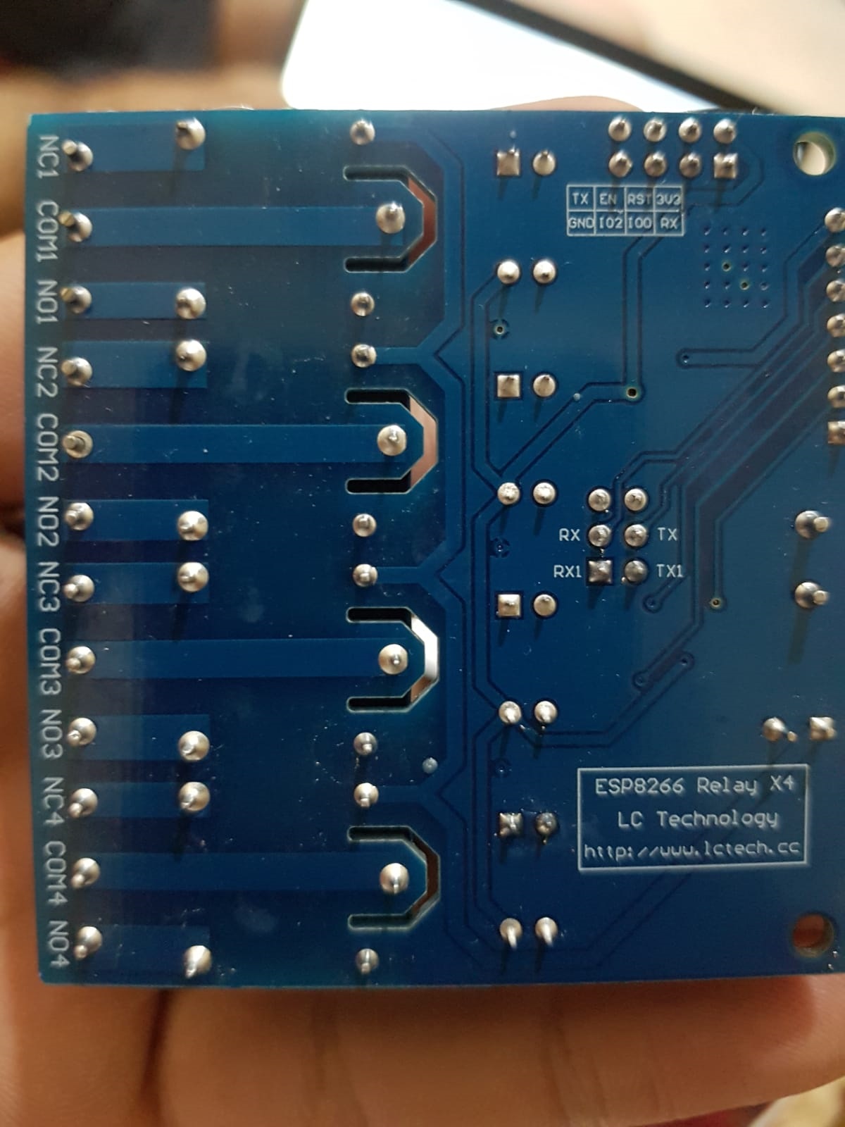

I have [lc technology ESP8266 realy x4 ] When I search for it via wifi I did not find it .. Since it is the blue LED in the widget ..
It works permanently
Please Help

Can you give a schematic of the board?

I cannot see what chip is being used to control the relais.
They used an ESP-01 module, which only exposes a limited number of GPIO-pins.
So the SMD chip next to the green power socket must be doing something, but I don't see what chip it is.
This makes it really hard to tell what may be going on here.

I think it's a NUVOTON 8 bit 8051 compatible microcontroller
Re: lc technology ESP8266 realy x4 Problem
#7 Post by TD-er » 31 Aug 2019, 12:29
That's a microcontroller running its own program.
Without knowing what it is running, it is near impossible to tell you what's going on here without thorough investigation using a logic analyzer.

epost wrote: 31 Aug 2019, 11:46 I think it's a NUVOTON 8 bit 8051 compatible microcontroller
It is a standard 4 channel Serial MCU controlled relay/switch, can be used with ESPEasy and P165 plugin. (If the NUVOTON has its standard program)
