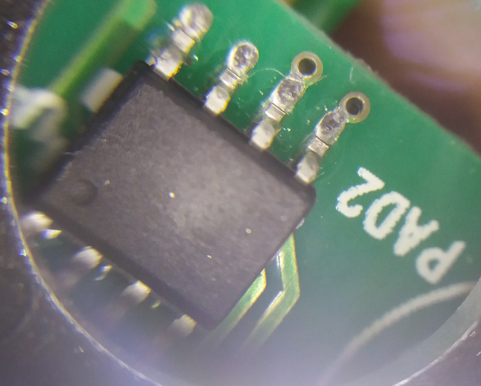

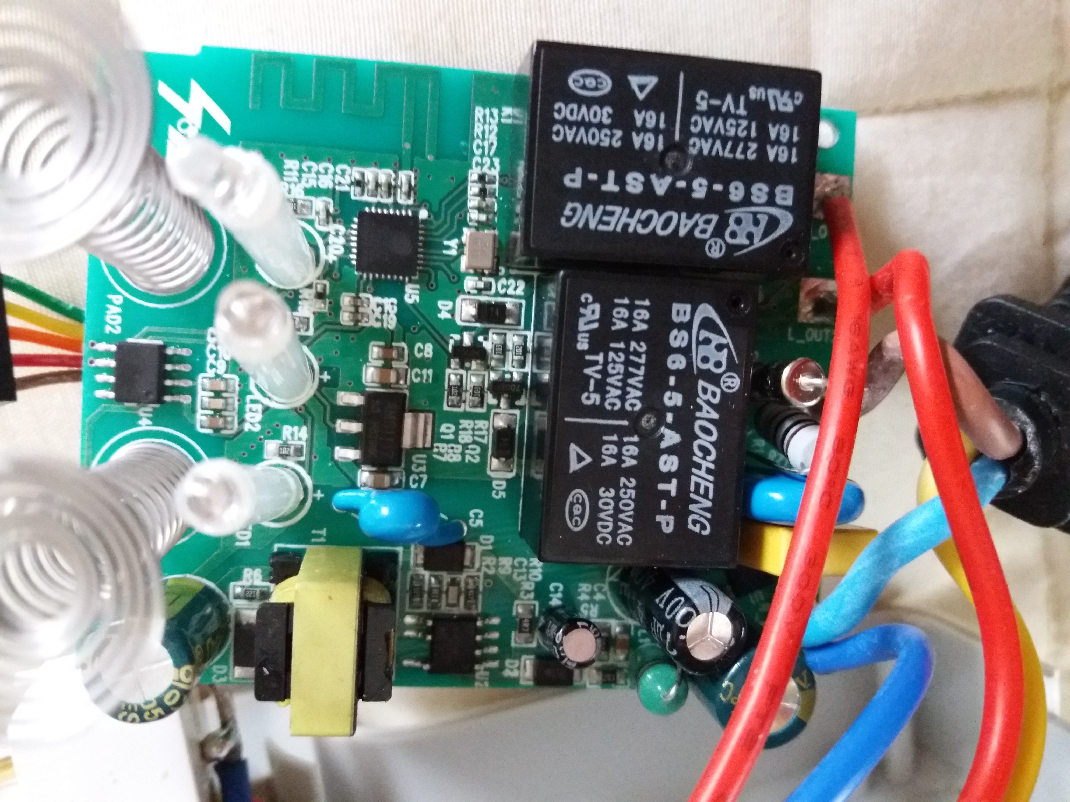

Flash chip: which one could it be? there's one with 8 legs, one with 7, one that looks like the clock and the AMS1117 of course ...
All so tiny, maybe even with no print on it? U4:
Could 'Force-DOUT' be worth a try?

obod0002c

Re: running Albohes Outdoor Switch: Cannot save to file

That picture looks like an memory unit but 8285 got internal memory... This fact might shed light on the problem.
Posts: 9895
#20 Post by TD-er » 26 Sep 2019, 10:32
Ah, yes I totally mis read the text on the picture of the first post.
ESP8285 has indeed its flash internal.
Sorry for all the confusion that may have caused.

#28 Post by Ath » 13 Feb 2022, 17:02
Is that this device? There you can also see the GPIO configuration, that should work just fine with ESPEasy. You will need some rules to operate the relays by using the buttons though.
- Configure a Switch device task for Button1 on GPIO-0, set the de-bounce delay to 150 msec
- Configure a Switch device task for Button2 on GPIO-9, set the de-bounce delay to 150 msec
- Configure a Switch device task for Relay1 on GPIO-12
- Configure a Switch device task for Relay2 on GPIO-5
on Button1#State=0 do
  GPIO,12,![Relay1#State]
on Button2#State=0 do
  GPIO,5,![Relay2#State]
Edit: Rules can be enabled on the Tools/Advanced page.
