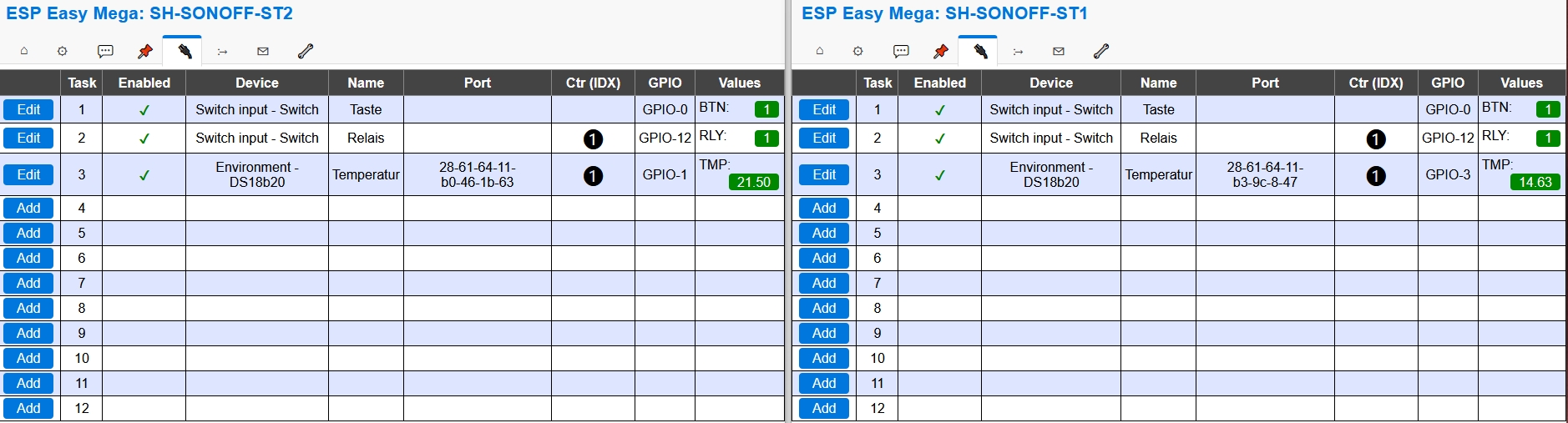

... just temp showing in the morning today.
Real outside temp on this place: +3,3°C
GPIO 1 : +18,62°C
GPIO 3 : +12,50°C
Swap DS18B20 over cross
GPIO 1 : +19,25°C
GPIO 3 : +13,00°C
(maybe a little more while touching)

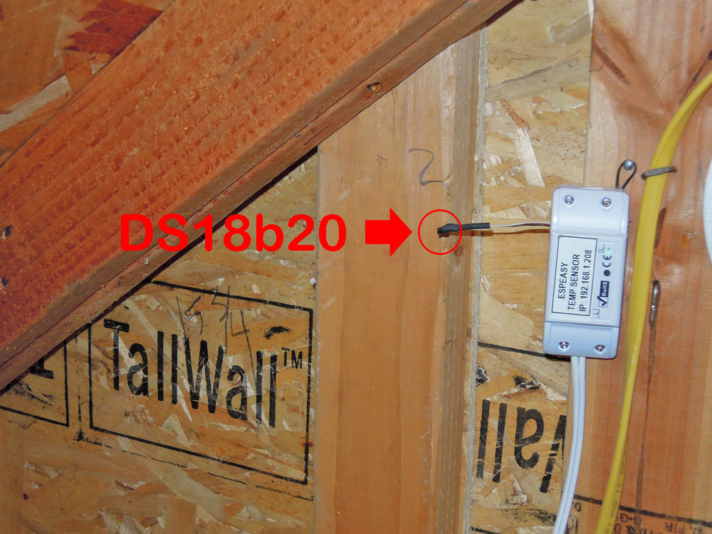

Being outside of the housing does not stop the temperature rise from the Sonoff. Heat is also conducted from the warm PCB to the wire leads on the DS18b20. That is one of the reasons why I recommend using long wire leads.Since the sensor is located outside the housing, only the current consumption of the sensor itself can be the cause.
Here is a photo of one of my Sonoffs that is installed in the attic. It shows the DS18b20 at the end of 3-inch long 26AWG wire leads. The long thin wire provides conducted heat isolation from the PCB. It also moves the chip away from the warm plastic housing. Your installation should do this too.
Please post a photo of the DS18b20's installation on your existing Sonoff. It will be interesting to see how you have it connected.

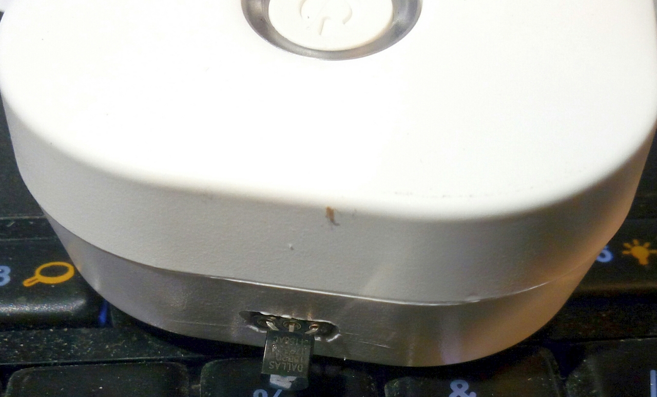

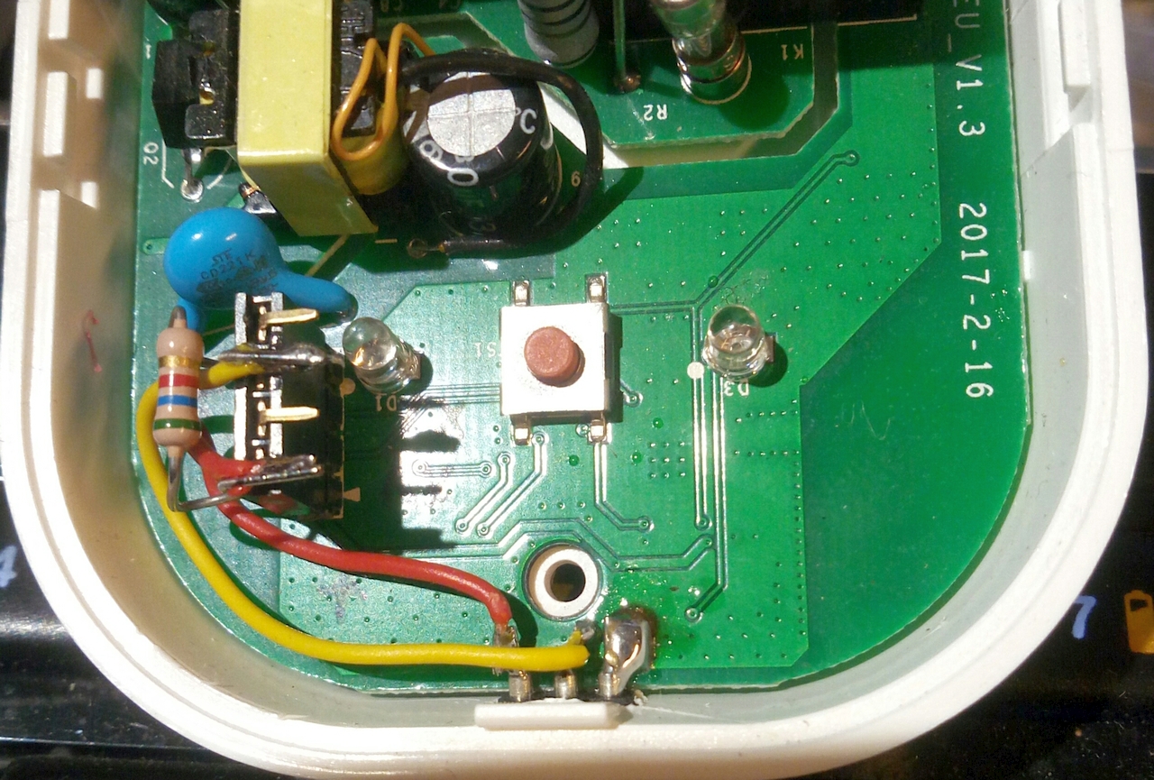

I have messured the current. That's ok arround 0,9mA, also the current of the dataline is arround 550µA peek (messured with a scope). All inside specs...
Now one of the S20 I have solder a tube-sensor with a long cable...
You are all right! The problem is realy the heat out from the S20 over the copper... Unbeliveable... I haven't noticed that before in an roomtemp ambiente. Now the temp match the real one...
But now I have a long cable on it. Not the solution I have in my brain. I have to think hard again how to do it so that the sensor can remain on the device (see pictures).

And, after looking at the picture again, it looks like you have a resister there....
Re: mega-20190630, DS18b20: Wrong temp
... jes, I have a R there ;o)
I have test many different ones before I use WeMOS, ESPEasy and similar... Datasheet say 4k7 but if you only have one sensor on the bus and also not so long cables (I talk about 10m or more) you can also use 5k6, 10k, 15k... If you have a scope just connect it to the dataline and raise the R... arround 20k or more you will see that the square wave data signal goes ugly. That's the point some GPIO's can't read the signal. It hangs on the GPIO-IN resistance and capacity...
Normaly you can take any between 1k and 18k and you will not see any problems... Just what you can find in your blackbox
