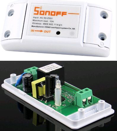

I flashed ESP Easy R72 into this little fun box:
The switch is attached to GPIO-0
The relay is attached to GPIO-12 (active high)
The LED is attached to GPIO-13 (active low)
You have to solder a 4 pin header to the PCB to be able to upload the first build. After that you can use OTA because it has a 1MB flash chip.The switch is attached to GPIO-0

On the link ManS-H gave https://www.itead.cc/smart-home/sonoff- ... witch.htmlBertB wrote:Almost impossible to build this yourself for that price, but I wonder ... how safe is this?
Does it have some CE (not China Export) marking?
you find images of the board from both sides, also the schematics of the device, RF + power.
http://wiki.iteadstudio.com/images/6/6b ... hmatic.pdf
Looks pretty decent in my opinion.

Some more info about these boxes :
http://tech.scargill.net/itead-slampher-and-sonoff/
After reading this, i ordered a bunch !

Itead studio also has another model of this WiFi swich for sale: https://www.itead.cc/im151116003.html for only $7.20.
It has a 433MHz selflearning receiver/decoder module on board type RXC6 which can decode the very common PT2262 (and EV1527) encoded RF-ASK signals.
Aside from the EFM8BB10F2g chip, all the components look pretty hackable.
As with the other device, without 433MHz module, the PSU is isolated from the mains, but the distance between the mains switching circuit and the low voltage DC parts looks relatively small (<2mm ?) as seen on the pictures, so probably this device will not receive CE approval. ( *** note)

I found another test/teardown of this device on this site: http://www.chet.ie/?m=201601
click on picture and again click on the picture will give you a very detailed picture of the board.

Mine have arrived and sad to say that the circuit diagrams online do not match the actual unit so no gpio line broken out to the pads (only 4 pads not 5 pads).
So maybe use gpio 0 from the switch and the led (shorting the current limiter resistor) as the i2c pair?

But I wonder, does your board layout differ from the ones that you find on the web ?
When looking at the schematic for the first time I was thinking that E-D0,E-D1,E-D2,E-D3 were the same as D0,D1,D2,D3 but it is not like that.
Looking better I see that
The relais is powered by GPIO-12.
The 3-pin bicolor led (pin3) is connected to GPIO-13.
I have to wait till I get mine to do some more investigation and flash it with ESPEasy.

Yeah the board is different from the circuit diags found on the web...
Of course, could we change the espeasy code to disable the serial port and use those 2 lines for i2c? Is it just a software thing or do we need to put the esp chip in a different hardware mode to disable the uart?

I meant, does the board layout look like this?cherowley wrote:Hi costo,
http://static.tweakers.net/ext/f/qBMHeJ ... u/full.jpg
or is it different?
The documentation of ESP8266 says that you can assign every software function to every pin that you choose.Of course, could we change the espeasy code to disable the serial port and use those 2 lines for i2c? Is it just a software thing or do we need to put the esp chip in a different hardware mode to disable the uart?
If you like to write your own application or modify the ESPEasy code you could change it in a way you can use GPIO-1&3 as I2C bus.
Maybe in a future relase of ESPEasy it is possible to use GPIO 1&3 as I2C bus, I have proposed that here: http://www.esp8266.nu/forum/viewtopic.php?f=4&t=711
At the moment, for me the easiest way to go seems a hardware hack/modification.
Looks like the board has 3 unused GPIO pins, GPIO 4,5 & 14 (pin 16,24 & 9 of the esp chip)
If you dare to do it you can solder 3 very tiny wires on those 3 pins, fix them with a blob of hot glue to the esp top, and solder them somewhere to the holes where the RF module can be placed.

Yep the board does look the same as that picture
In the circuit diags it showed 5 pins in the header but only 4 in the actual board...
Ah, if the code only requires turning off the serial output and adding them to the drop down list i'll have a dabble
Re: New ESP gadget
should be:Looks like the board has 3 unused GPIO pins, GPIO 4,5 & 14 (pin 16,24 & 9 of the esp chip)
Looks like the board has 4 unused GPIO pins, GPIO 2,4,5 & 14 (pin 14,16,24 & 9 of the esp chip)
About re-assigning GPIO 1&3 for I2C, I have tested it myself with wire.begin(1,3) and connected a OLED and that works fine, I did not test this setup with other I2C, especially talking, devices, but expect it will work.
These pins need to have the UART function when booting in flash mode, that is done automatically , when booting in normal mode they can be used as I2C. You just need to make sure that in the software the UART is not initialised, so NO Serial.begin and YES a wire.begin(1,3).
Re: New ESP gadget
Did yoy succeed ?cherowley wrote: Ah, if the code only requires turning off the serial output and adding them to the drop down list i'll have a dabble
I turned off the serial.begin initialisation in the source code but that did not disable the serial stuff.
Serial stuff is deeply embedded in the ESPEasy code, and it MUST be turned off completely before it is possible to use RX and TX pins for I2C bus.
I hope you will succeed in removing all the serial stuff from the code and can enable GPIO1&3 for other uses, that would make it very attractive to use the Sonoff WiFi boxes for ESPEasy.
Re: New ESP gadget
@ cherowley
I made a fork of ESPEasy and call it MiniESP .
https://github.com/costonisp/MiniESP
I have not received my sonoff WiFi switches yet but tested this program on several boards.
I believe it will work with the sonoff gadget, it disables Serial input/output and enables GPIO 1 & GPIO 3 for I2C.
Re: New ESP gadget
Morning Costo!
I haven't had chance yet to mod the code but looks like you've beaten me to it anyway!
If i get time today i'll grab yours and give it a go
Re: New ESP gadget
Today I got my sonoff switches, ordered them on januari 26.
The custom firmware that is flashed on it is stupid because you can not integrate it with home-automation software. It only works with a phone app and uses a external Amazon server.
So I soldered a 4 header on the board with gives me Vcc, Txd, Rxd, Gnd and connected a 3.3V USB/Serial interface to the unpowered sonoff switch.
With Arduino IDE I flashed ESPEasy on it and OTA updated that with my github fork and that gave me the I2C bus instead of a serial bus.
Connected a Barometer and OLED, connected the 230V AC and configured it.
The device tab shows the I2C bus on Rxd and Txd
The 230V AC to 5V DC isolation does not look like it is made for or usable in medical intrumentation
The distance on the nearest points is about 1.5 mm.
But with carefull use and technical wishdom it can be made pretty safe.

- Posts: 103
- Joined: 16 Sep 2015, 20:32
Re: New ESP gadget
Nice, have 5 pices waiting in China for transport (Yearly China Shutdown Time)costo wrote: The 230V AC to 5V DC isolation does not look like it is made for or usable in medical intrumentation![]()
Do not use it with an alcohol tester

If the power cord is actually plugged in, I would not recommend this lab setup as general safe working practice.
You have to rely on a good working "Earth Leakage Circuit Breaker" or "Residual Current Circuit Breaker" if you touch some of the components.
We would like our community members to stay alive...
Re: New ESP gadget
I used the 3.3V rail did not use the 5V rail.cherowley wrote:Hiya costo,
I was trying to get a pir sensor working with it last night but no joy @ 3v..
Where are you picking 5v up from?
cheers!
5 volt is available at the bottomside of the board where D4, the relaiscoil and the 3.3V regulator are located. No testpoint with 5V available so you have to solder a wire for that. Not really a attractive solution for a simple setup.
But offcourse you can do it. As long as you keep all electronics like your PIR, other sensors, switches, wires and the Sonoff itself inside a good isolated enclosure you can do that without the risk of endangering anyone.
I think also Martinus and Bert will agree that when done consious and within the guidelines of NEN 1010 and NEN 2012 it can be perfectly safe.
Oh . . . . and do not forget to let anyone entering your home , sign a agreement in advance that they are aware of the dangers and do this at their own risk and that you will in no way be liable for damage or injury

received 5 switches early to my surprise
Thought the Chinese holiday would delay the shipment
Can somebody tell me what the best flash setting is
I flashed one with 1M(256K SPIFFS) and its working
(Just using the relay on pio 12)
But I'm not sure if I better go for 512, 128 or 64 K SPIFFS
Of course I want to OTA update after the first serial
Re: New ESP gadget
I use these settings to generate a bin file that can be loaded (by OTA )into Sonoff, i didn't try other settings because this works well for me.NietGiftig wrote: Can somebody tell me what the best flash setting is
Board : Generic esp8266
Flash size : 1Meg 256 K SPIFFS
Reset method: ck

I have one of these and have soldered wires to all 4 pads. I am having issues uploading easy ESP to it though.
Can someone go into a bit more detail for me?
Re: New ESP gadget
Hi, what's the problem? Not flashing or doesn't run after flashing?jay_s_uk wrote:I have one of these and have soldered wires to all 4 pads. I am having issues uploading easy ESP to it though.
Re: New ESP gadget
Hi:
Do work the relay ?
Do work the relay ?
Re: New ESP gadget
The problem is not flashing. I've used the 4 pads on the bottom of the board, but am I better off using the 4 through hole connections?cherowley wrote:Hi, what's the problem? Not flashing or doesn't run after flashing?jay_s_uk wrote:I have one of these and have soldered wires to all 4 pads. I am having issues uploading easy ESP to it though.
I've tried resetting the board at the point of upload etc but I'm not getting any where.
Re: New ESP gadget
jay_s_uk wrote:The problem is not flashing. I've used the 4 pads on the bottom of the board, but am I better off using the 4 through hole connections?cherowley wrote:Hi, what's the problem? Not flashing or doesn't run after flashing?jay_s_uk wrote:I have one of these and have soldered wires to all 4 pads. I am having issues uploading easy ESP to it though.
Hmm, you say the problem is not flashing yet you say you are not getting anywhere? Sorry, bit confused..
Re: New ESP gadget
Managed to get it flashed with easy esp.cherowley wrote:jay_s_uk wrote:The problem is not flashing. I've used the 4 pads on the bottom of the board, but am I better off using the 4 through hole connections?cherowley wrote:
Have wired it into a lamp to test it out but the sonoff is up and down like a yoyo. I have no idea why. Am powering it off of the mains
Re: New ESP gadget
What IDE-Tool settings did you use to complie ESP78 ?jay_s_uk wrote: Managed to get it flashed with easy esp.
Re: New ESP gadget
Reset method: ck
Still can't get it to stay alive longer than one or two pings
Re: New ESP gadget
Are you sure you are powering the sonoff with 230 V after flashing it with a USB/Serial adapter? Because the adapter cannot deliver the power for the WiFi to work, it will reset often.jay_s_uk wrote:I've usedcosto wrote:
Reset method: ck
About the flashsize, I believe 1M with 512kSPIFFS is the better option to use when you want to do OTA.
The best result I get is to upload the ESPEasy_R78_1024.bin file from http://www.esp8266.nu/downloads/ESPEasy_R78.zip
with the flashtool. From that version I update with the forked ESPEasy from here https://github.com/costonisp/MiniESPEasy to disable the UART on Rxd&Txd and enable GPIO1 and GPIO3 on these pins for I/O
It is a bit troublesome that you have to do all the settings from start again after a OTA update. Choose network on 192.168.4.1 and so on.
Or you must compile with SSID and PassPhrase into the sourcecode.
