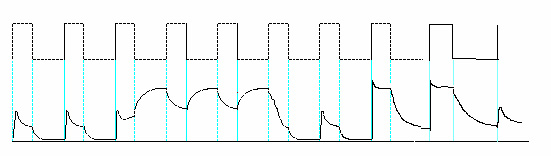

Re: MQ-7 support
Hello again.
First, the circuit looks good to me.
I've copied the signal diagram from the MQ-9 datasheet:
The upper line is the heating/measuring voltage, the lower one is the output signal.
Looking at this diagram I think taking the value at the end of the measurement period
should work best as it seems the signal needs a while to settle down.
So in my opinion the flow should be roughly like this:
- High voltage for heating (x seconds)
- Low voltage for measurement (y seconds)
- take value
- repeat
- take value
- repeat
