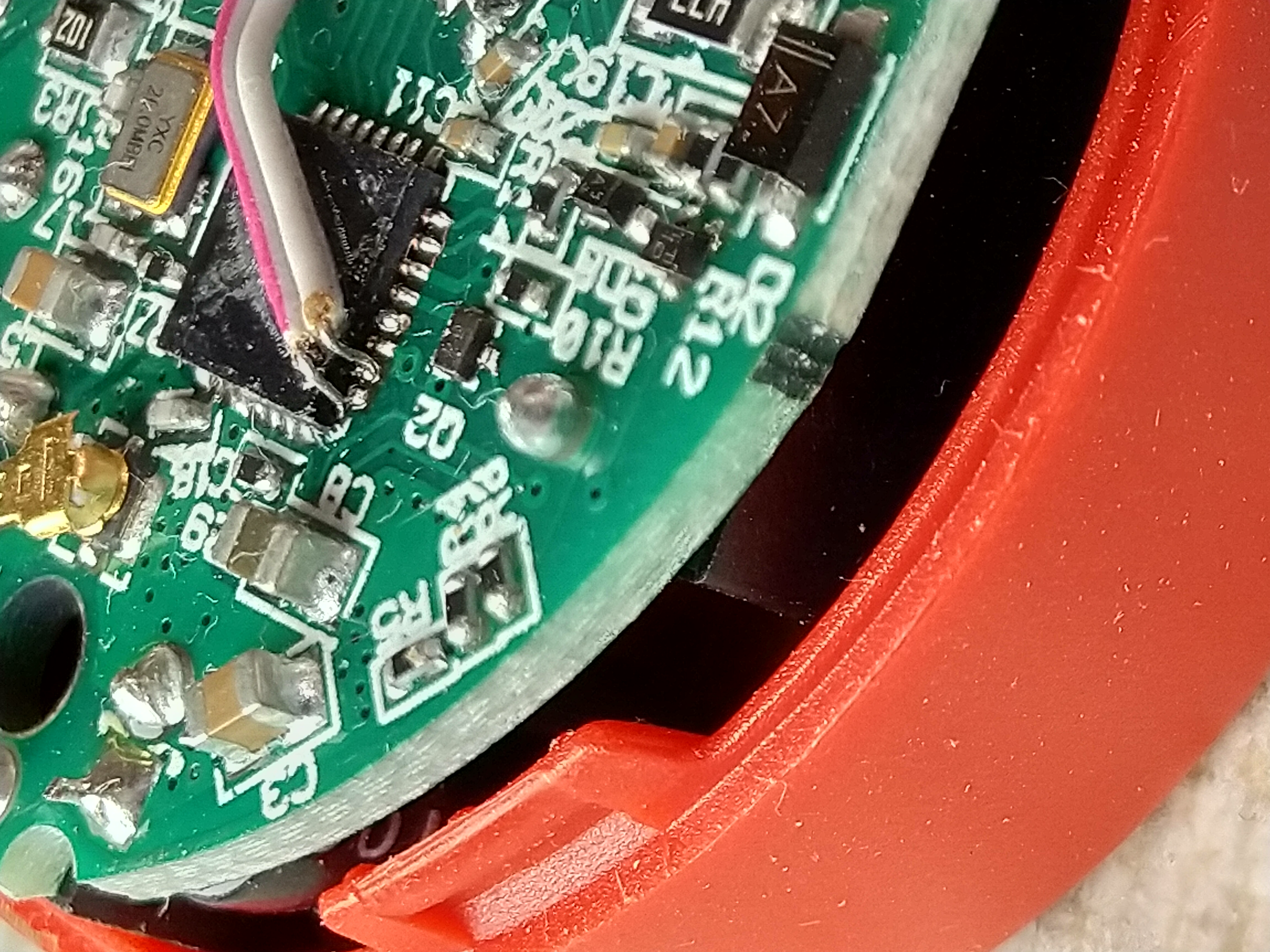

The 'doable' wires on the BL0937:

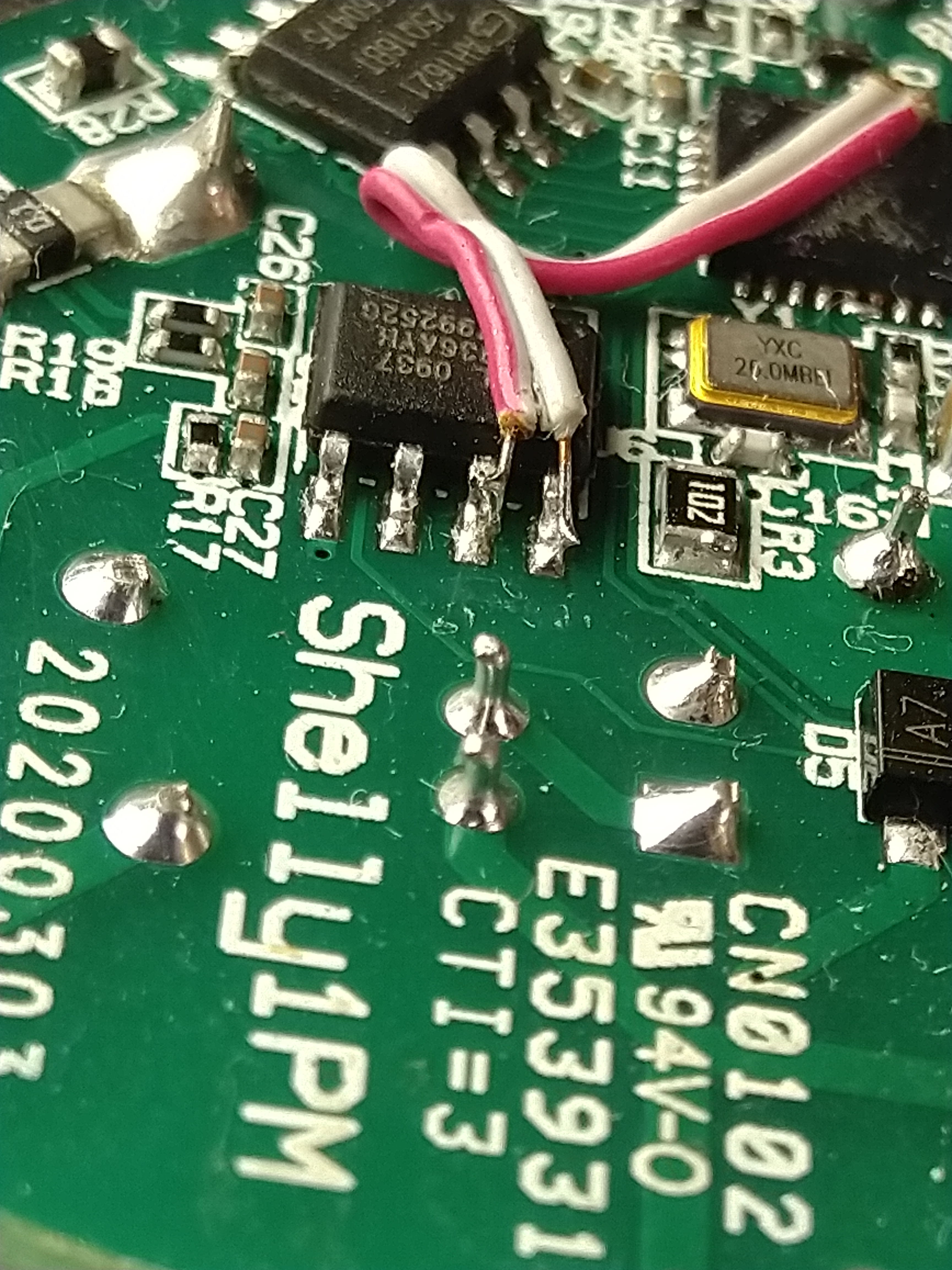

The 'hard' soldering, directly at the ESP chip:

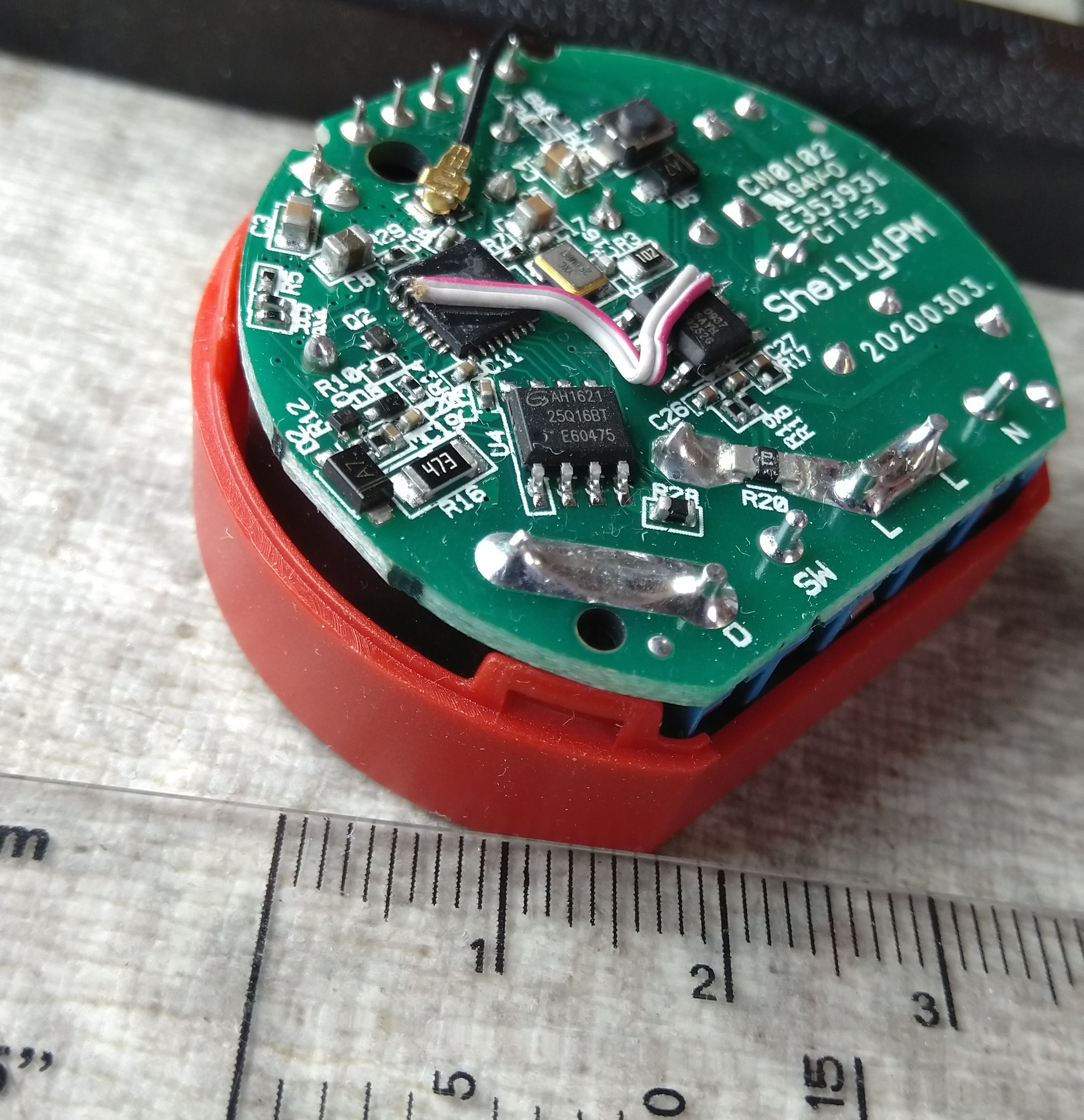

And the Shelly put to the scale:

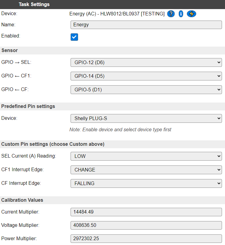

Next issue is to get all measurements to actually work... the Power is measured, though I had to increase the Power multiplier by a factor of 3.48 to get the correct reading.
This is the configuration I use: (it has the fixes from PR 3166)
Screenshot - 12-07-2020 , 22_18_27.png (31.46 KiB) Viewed 24361 times
Any suggestions are greatly appreciated.

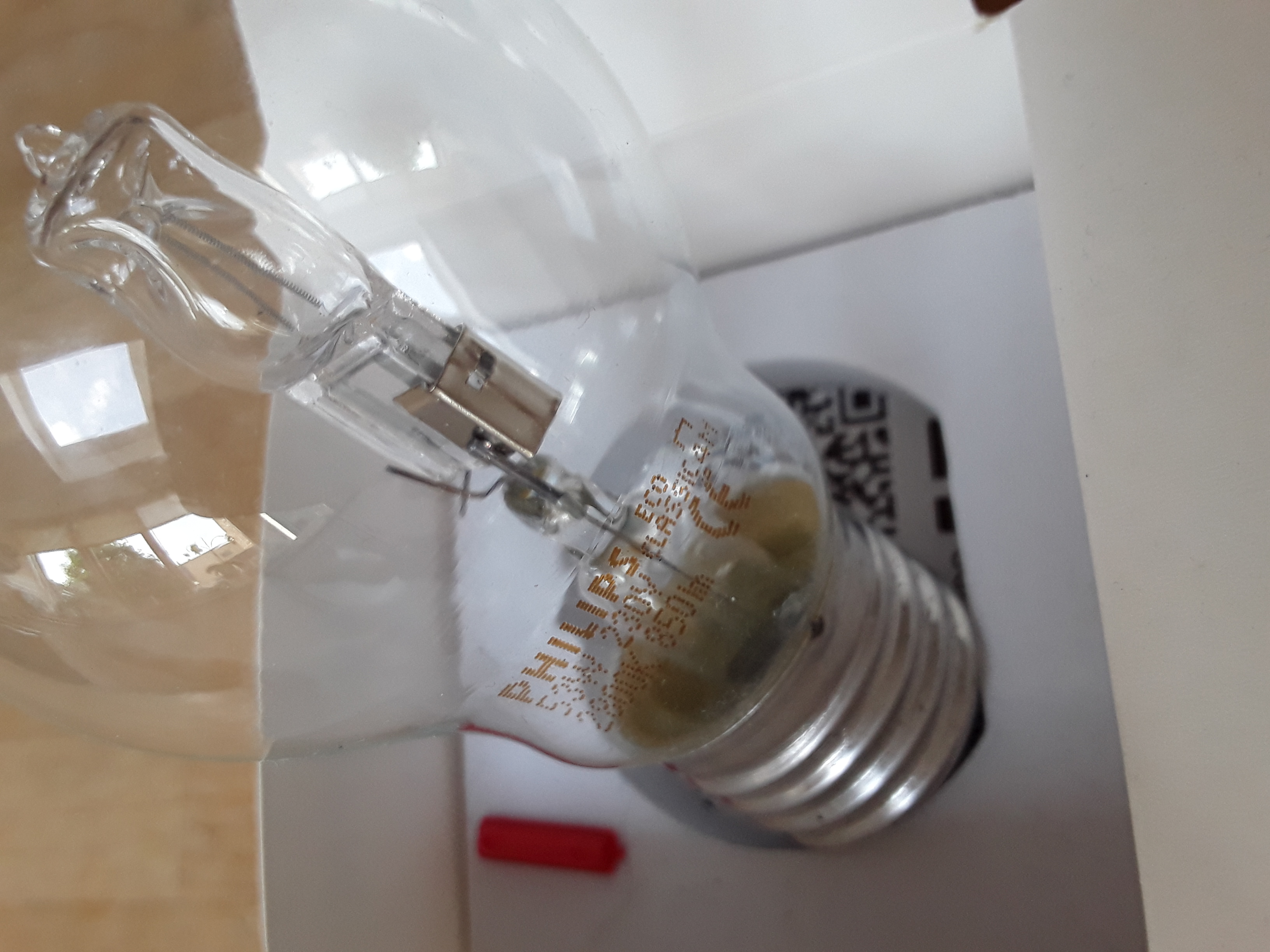

I'm pretty confident the bulb doesn't have a switching powersupply, but I don't think it's halogen either, that may be from my imagination, or some text on the box it came in, I can't recall that, and the box went down the paper 'archive'.
It's this closeup:
Re: Project: Shelly 1PM with HW patch
#6 Post by TD-er » 19 Jul 2020, 10:23
Yep, that's a halogen bulb, running at 230V, so it is as close to a perfect power factor as you can get.
For this, the unit should have no problem at all measuring its power and thus it is rather strange you need to apply such a big correction factor.
Maybe the Shelly unit uses a different shunt resistor value to measure the current and usually corrects it in its own firmware?

When looking at the shunt (first photo, above) it most likely has a 1 mOhm resistance, at least the print on R20 can be read as '0.1'. That is also the defined value in the source, and should result in the correct factor. My multimeter isn't accurate enough to effectively measure that kind of resistance... That's why I recalculated it, based on the bulb shown.
