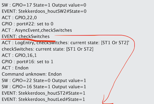

#15 Post by Dick60 » 13 Apr 2023, 19:30
I hoped that this would work using 2 switches but changing sw1 or sw2 will turn On the led because st1 or st2 or both changed the status but I want to keep the led on untill all ST1 AND ST2 are off. This is what I thought:
on Stekkerdoos_houtSW1#State do
 AsyncEvent,checkSwitches
 If [Stekkerdoos_houtSW1#State]=0
  GPIO,33,0
  GPIO,33,1
on Stekkerdoos_houtSW2#State do
 If [Stekkerdoos_houtSW2#State]=0
  GPIO,22,0
  GPIO,22,1
on checkSwitches do
  LogEntry,"checkSwitches: current state: [ST1 Or ST2]"
  if [Stekkerdoos_houtST1#State]=1 or [Stekkerdoos_houtST2#State]=1
    GPIO,16,1 // Turn on LED
  Elseif [Stekkerdoos_houtST1#State]=0 and [Stekkerdoos_houtST2#State]=0
    GPIO,16,0
Re: Rules best approach

Dick60
Posts: 244
Joined: 11 Feb 2018, 17:35
Location: The Netherlands
#17 Post by Dick60 » 13 Apr 2023, 20:48
This is what I have for now:
  GPIO,33,0
  GPIO,33,1
  GPIO,22,0
  GPIO,22,1
on checkSwitches do
    Else
    //Elseif [Stekkerdoos_houtST1#State]=0 and [Stekkerdoos_houtST2#State]=0
    GPIO,16,0
Led is turned on and off for Stekkerdoos_houtSW1#State. The same for Stekkerdoos_houtSW2#State but if you use Stekkerdoos_houtSW1#State (led on) and after that use Stekkerdoos_houtSW2#State the led is turned off and I would expect that the led keeps on.

Push SW1(gpio13) resulting activate ST1(gpio33) and turn on the LED(gpio16).
SW : GPIO=13 State=1 Output value=0
EVENT: Stekkerdoos_houtSW1#State=0
ACT : GPIO,33,0
GPIO : port#33: set to 0
ACT : AsyncEvent,checkSwitches
EVENT: checkSwitches
ACT : LogEntry,'checkSwitches: current state: [ST1 Or ST2]'
ACT : GPIO,16,0
GPIO : port#16: set to 0
ACT : Endon
Command unknown: Endon
SW : GPIO=33 State=0 Output value=1
SW : GPIO=16 State=0 Output value=0
EVENT: Stekkerdoos_houtST1#State=1
EVENT: Stekkerdoos_houtLed#State=0
Push SW2(gpio17) resulting activate ST2(gpio22) bt turn off LED(gpio16)-
SW : GPIO=17 State=1 Output value=0
EVENT: Stekkerdoos_houtSW2#State=0
ACT : GPIO,22,0
GPIO : port#22: set to 0
ACT : GPIO,16,1
GPIO : port#16: set to 1
ACT : Endon
SW : GPIO=22 State=0 Output value=1
SW : GPIO=16 State=1 Output value=1
EVENT: Stekkerdoos_houtST2#State=1
EVENT: Stekkerdoos_houtLed#State=1

Ok.. your naming of switches an relays is confusing me a bit.
You do seem to check the relay states and not the switch state in "checkSwitches":
But the state of the relays is changed after "AsyncEvent,checkSwitches" (as you can see in your log output)
So it is better to put this at the end of the "switch" event blocks like this:
On Stekkerdoos_houtSW1#State Do
  GPIO,33,0
 Else
  GPIO,33,1
 Endif
As you can see in the image. The "checkSwitches" event needs to be processed after "EVENT: Stekkerdoos_houtST2#State=1" otherwise it is useless.
So keep an eye on log output while investigating your code it is really helpful
Edit: To be really sure the "checkSwitches" event is fired at the right time you could use a new event block like this:
On Stekkerdoos_houtST1#State Do

Dick60 wrote: 14 Apr 2023, 09:42 So the result of the log is from this script:
so "checkSwitches" is still to early... i recommend you this:
Dick60 wrote: 14 Apr 2023, 09:42 Edit: To be really sure the "checkSwitches" event is fired at the right time you could use a new event block like this:
And did you find the mistake in your rules?

#30 Post by chromo23 » 14 Apr 2023, 10:08
And to shorten the code a bit you could use a "wildcard" in your rules making the "checkSwitches" event obsolete
On Stekkerdoos_houtST* Do
 LogEntry,"checkSwitches: current state: ST1=[Stekkerdoos_houtST1#State], ST2=[Stekkerdoos_houtST2#State]" // etc.
  If [Stekkerdoos_houtST1#State]=1 or [Stekkerdoos_houtST2#State]=1 // Add more on-state switches like this, using the 'or' condition, when needed
    GPIO,16,0 // Turn on LED
  Else
    GPIO,16,1
  Endif
