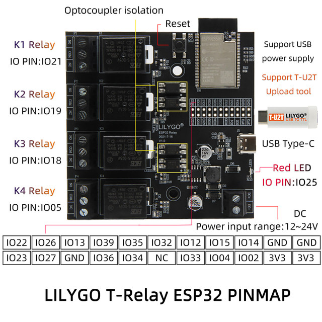

Dear all,
I have a few ESP8266 and ESP32 running ESP Easy smoothly, but recently I stumbled across a problem:
- Using ESP32 Relay board: LILYGO TTGO T-Relay ESP32 4MB Flash
- Spec saying it is a ESP32-Wrover-B 4MB Flash 8MB RAM
- I have flashed ESP_Easy_mega_20230409_normal_ESP32_4M316k.factory.bin using the flash_download_tool_3.9.3
- Device is coming up with ESP Easy, I can connect via Wifi and put in my local Wifi settings
- Device is connecting to my local Wifi
- I can connect NPT, Rules, etc.
- But: When I do a hard reboot (power off) device is loosing all settings and rebooting with factory settings (local Wifi access point, without any other settings done before)

Re: ESP32 not saving preferences (Wifi, NTP, Rules, etc.)
The WROVER modules are for sure not using PUYA chips.
As far as I know those were only used on 1MB ESP8266 modules.
However some ESP32-WROVER boards do use flash chips running at a different voltage compared to almost any module released later.
GPIO-12 on the ESP32 is one of the so called "boot strapping" pins, meaning its state during boot does set something in the module.
The boot state of GPIO-12 does set the flash voltage.
Is something connected to GPIO-12? And is it possible this could force the boot state of that pin to a specific state?
Another option can be when GPIO-1 and GPIO-3 are shorted.
This does force ESPEasy to perform a factory reset at boot.

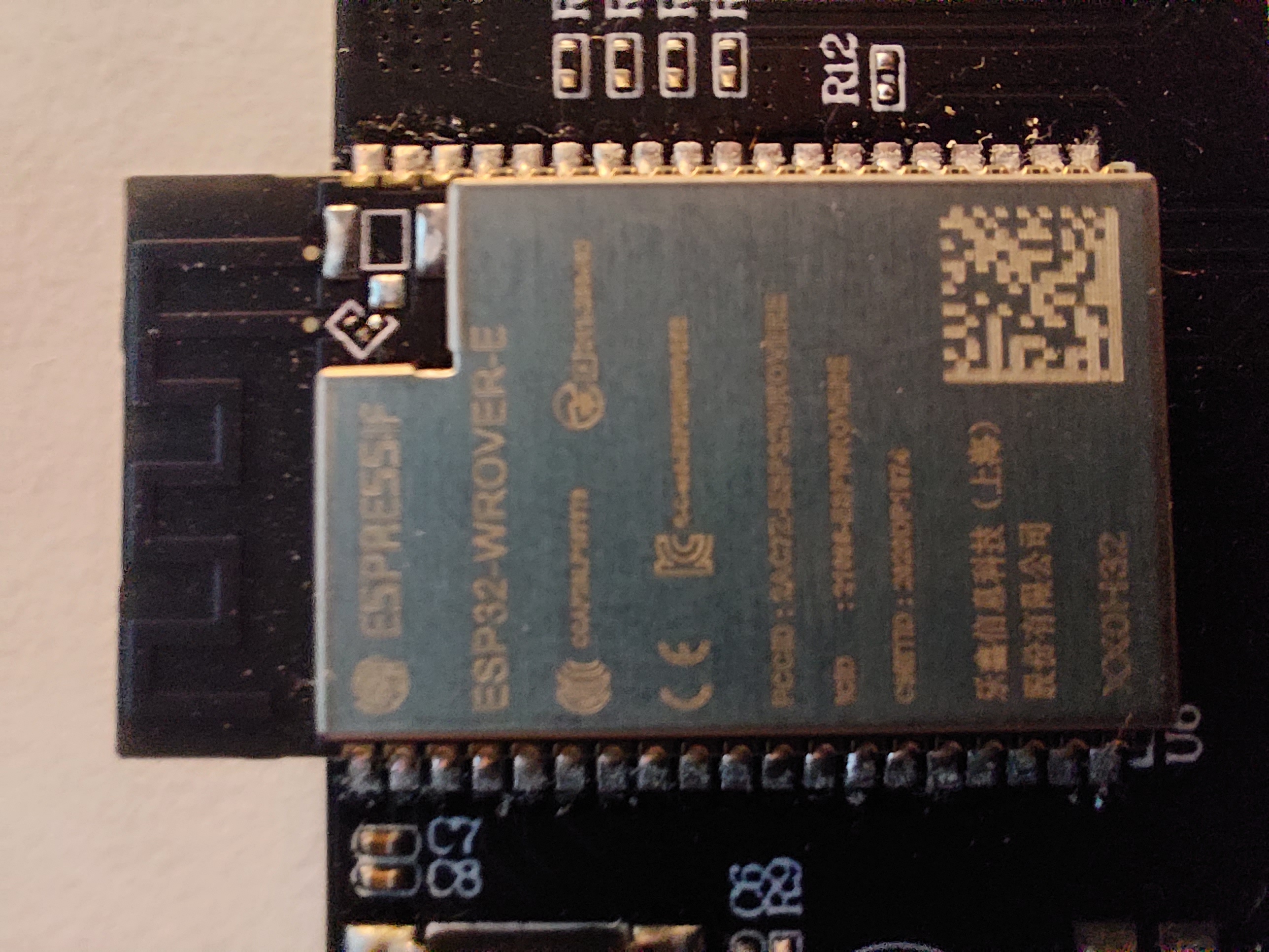

The "datasheet" does not tell me something with regards to GPIO12/1/3.
Following the print on the ESP it is a ESP-WROVER-E
Based on pinout from here (page 11): https://www.espressif.com/sites/default ... eet_en.pdf
Checking with the multimeter GPIO12 seems to be floaiting.
GPIO-1 and GPIO-3 are not shorted/connected.
On the sysinfo page, or via the output of esptool.py (that one is the preferred one), you can see what CPU is used inside the module.
Is it the ESP32-D0WD-V3 or is it the ESP32-D0WDR2-V3 ? (the number after the "R" may be different)
The one with the "R" does have the QSPI PSRAM embedded in the chip.
On the metal of the WROVER there is probably also something printed like ESP32-WROVER-E-N4R8.
Maybe you can also run this test build: https://github.com/letscontrolit/ESPEas ... 4914697503
It has a new item on the sysinfo page showing the CPU Features as reported by the CPU.
Not all ESPs seem to have these set, but perhaps the modules made by Espressif themselves have these CPU features burnt in the E-Fuses.
Please show all which is shown on the sysinfo page.
Especially the "memory", "ESP Board" and "Storage" part and when possible the "Partitions"

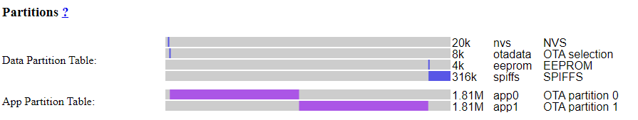

From the test build (ESPEasy_mega_20230508_ESP32_PR#4640_4914697503) using ESP_Easy_mega_20230508_normal_ESP32_4M316k.factory.bin:

ESP Board Name: Espressif Generic ESP32 4M Flash ESPEasy 1810k Code/OTA 316k FS
Storage
Flash Chip ID: Vendor: 0x5E Device: 0x4016
Flash Chip Real Size: 4096 kB
Flash IDE Size: 4096 kB
Flash Chip Speed: 80 MHz
Flash IDE Speed: 40 MHz
Flash IDE Mode: DIO
Flash Writes: 7 daily / 8 boot
Sketch Size: 1325 kB (1856 kB free)
Max. OTA Sketch Size: 1856 kB (1900544 bytes)
SPIFFS Size: 283 kB (128 kB free)
Page size: 256
Block size: 8192
Number of blocks: 35

Ehhh, maybe I found the root cause.
The Lilygo Board does not have a USB2Serial on board but ships with a Tiny USB-C USB2Serial.
It is connected via USB-C connector to the board (strange to use a USB-C adapter for serial.
Somewhere in the docs it is described, the board can be powered via USB-C without the adapter.
I found out, that the board seems to reset config, if I am connecting the board to a AC-power adapter directly with USB-C cable (without the tiny USB2Serial ) -> maybe there is a bridge between GPIO01 and GPIO03 in the AC adapter...
Maybe see also: https://github.com/Xinyuan-LilyGO/LilyG ... /Schematic
It doesn't even need to be a short.
ESPEasy does send a string on the TX port and if that exact string is received on the RX port, it will consider the RX/TX pin shorted.
This can also be done via some resistor.

Thanks for your help - so it seems we found the root cause - I will give a hint to the Lilygo developers...
As stated here: https://en.wikipedia.org/wiki/USB_hardw ... y_charging
There is a resistor over D+ and D- when using an USB charger.
Jason2866 pointed me to this thread on Tasmota:
https://github.com/arendst/Tasmota/discussions/16060
