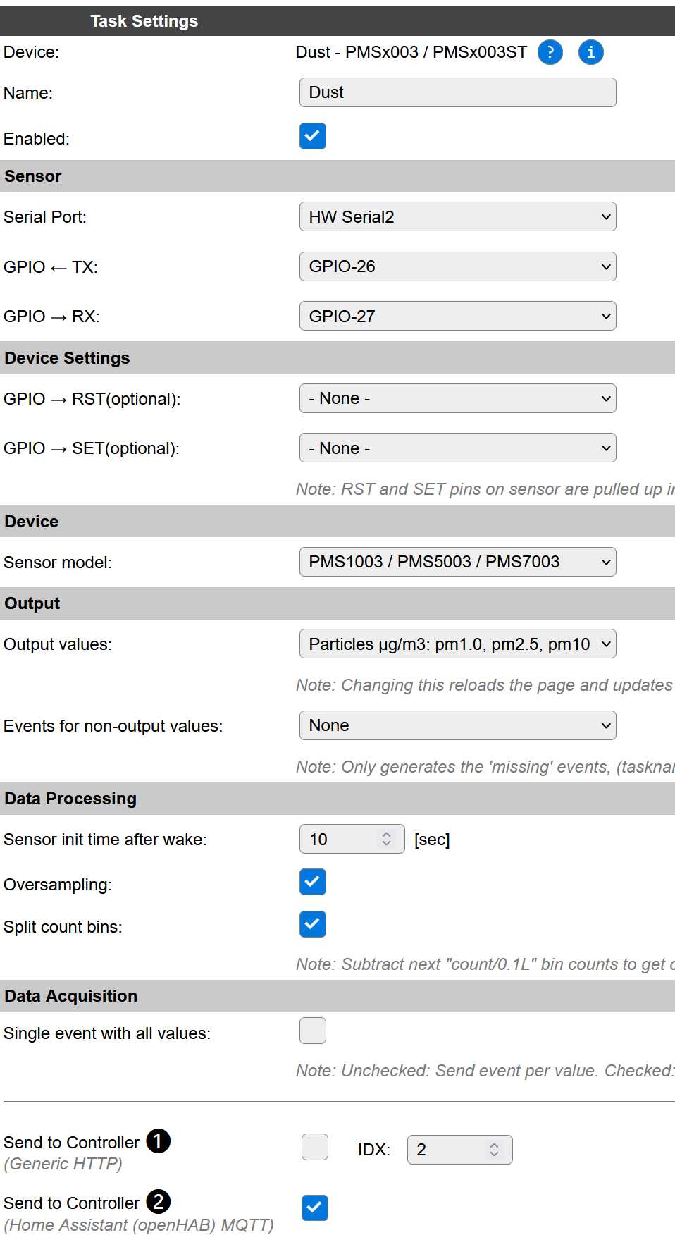

I am using a PMS5003 on an ESP32 board and want to use the sleep mode. I am using the code example from https://espeasy.readthedocs.io/en/lates ... light=dust :
On System#Boot do    //When the ESP boots, do
  looptimerset,1,300  // Start loop timer 1, 300 sec interval
  timerSet,2,30 // Set timer 2 to put the sensor to sleep again
On Rules#Timer=1 do
  pmsx003,wake
On Rules#Timer=2 do
  pmsx003,sleep
I would expect the sensor now to run for 30s seconds and then sleep for 270s and then do so again. However, the values of the dust sensor are updated/changing every 10s and the sensor does not seem to sleep at all. Did I do sth wrong?
My sensor is connected only through the RX and TX with ESP32. SET and RST are not connected. Did I understand the Wiki correctly that the sleep/wake command is performed thorugh the serial interface?
pmsx003,sleep Either pulls the PWR_SET pin low, or writes sleep command to the sensor.
I attatched the settings of my sensor.
2023-06-04 19_48_07-Wohnzimmer_Supersensor – Mozilla Firefox.png (134.84 KiB) Viewed 1509 times

#2 Post by Ath » 04 Jun 2023, 20:14
What is the Interval you have set for that task? Also on 10 seconds? (it's not in the screenshot).
The example has it set to 60 seconds, though that may still be too short, and may need to be set to ~260 sec. (270 sec. minus 10 sec. init time).
