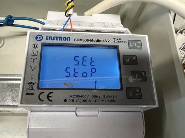

This is the setup of the eastron
set adres.jpg (104.83 KiB) Viewed 90033 times
set baud.jpg (109.31 KiB) Viewed 90033 times
set pari.jpg (107.33 KiB) Viewed 90033 times
set stop.jpg (105.2 KiB) Viewed 90033 times

The picture of the baud rate is a bit unclear as the decimal dot (if any) isn't visible at this viewing angle.
So if there isn't a decimal dot, then you actually set it to 96000 baud.
This would be a really strange setting, but maybe you can verify there actually is a decimal dot, or the documentation mentions this situation?
Also the default serial port config would be something like "8N1", meaning No parity and 1 stop bit.

TD-er wrote: 16 Jul 2023, 15:16 The picture of the baud rate is a bit unclear as the decimal dot (if any) isn't visible at this viewing angle.
there is a decimal point between the 9 and the 6 so this is set to 9600 baud

TD-er wrote: 16 Jul 2023, 16:01 Have you looked at the "parity" setting?
I think that one might be wrong on your setup.
i just tried every option (odd, even, none). No result
What should it be?

Is serial config on the Eastron correct? (8N1 as in 8 bits, no parity, 1 stop bit)
I checked the settings in te SDM630:
Did not find BIT-length in the Eastron....

I think you mean the lines which start with EASTRON: (1,4)
What 'fail/success' values did you see on the web page?
I assume you have the serial log and serial console disabled on the tools->Advanced page.
Yes I did disabled that setting
I know there are some MAX485 chips out there that don't work well when powered by 3.3V (or not at all)
In the tests of last Friday I had a NodeMCU with 5V on Vin. But that one is blown.. Now I use a Lolin. That has no 5V on Vin.. So I have no choice at the moment.. I orderd 2 new Amica's. Maybe I receive them tomorrow.
To be sure, I use a different (brandnew) MAX485 TTL to RS485 module (I have 2 of them) for the tests today.
The red light on the old one still works. But I am not sure.
So maybe -just as a test- it is better to connect the DI and RO pins not to the RX/TX pins on the board, but rather use GPIO 5 (D1) and GPIO-4 (D2) and configure these as software serial port.
I will give it a try.
But can you explain: configure these as software serial port
Thanks again.
