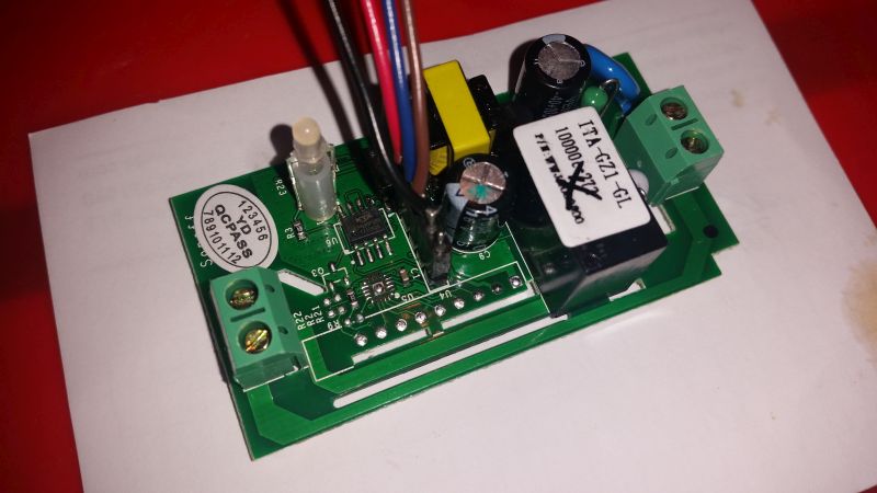

Attached my modules....
Re: Flashing Sonoff Wifi Modules / not working
I hpoe they are now online...

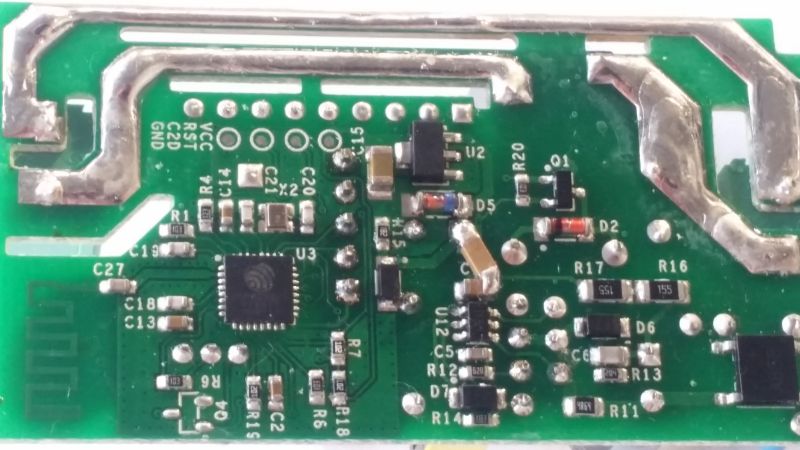

Esp is on the other side i guess, can you send bottom picture as well?
Only thing i can think of is tgat maybe itead changed from esp8266 to another mc
here is the bottom side. I cannot see any changes...
Tzzz, what happens?
I've used the original bin-File...
Tzzz, what happens?

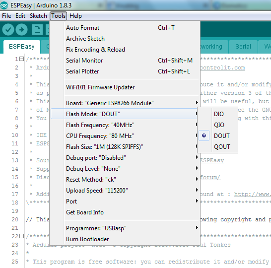

Did you flash in DOUT mode? The flash memory in your picture require this mode. DiO, QIO, etc. won't work.
- Posts: 11
- Joined: 20 Jul 2017, 13:11
That worked for me! Thanks a lot!!!!

Here's one: I'm using Arduino to flash the Sonoff, en then it's just somewhere in the tools menu.
Interesting. I use Arduino IDE 1.8.1 Windows (german) with the ESP-core 2.3.0Blacky's Boss wrote: ↑24 Jul 2017, 22:37 Rule nr1: there are no stupid questions, only stupid answers
Within the tools menu i can switch to serial plotter/Monitor, WiFi Firmware updater, Board Manager,
CPU frequency, Flash size, Upload speed, Port, Get board info, Programmer, and burn bootloader.
Sorry, but no or at least no obvious no setting for prog mode.
I didn't find any in the other menu's too.

See my settings below, Arduino 1.8.3 and ESP core 2.3.0
Available options depend on the selected board, could that be your cause?

I ordererd SPI-EEproms from Winbond W25Q32FVSSIG a few weeks ago (for upgrade from 1 Mbit up tp 4 Mbit).
I removed the Xicor 25F08xxx and replaced them with the Winbond EEproms.
And...surprise....all 8 Sonoffs Wifi Switches are now working correct and stable.
It seems to be that the Xircor-Chips have some properties, that has an impact on the firmware...
But now all is working fine.
Best regards

I have not read through the whole post, but I hope this will help.
Last week I bought two Sonoff Basic units and followed the instructions for flashing them and had the same issue where the AP never showed. I tried multiple time and also noted that when flashing the program would often get connection errors before flashing.
I even tried two different USB to serial devices, but they both did the same thing.
After much Googling, I found two things that will hopefully help you.
My board seems to be the newer version from Sonoff (it says v1.1 on the board) and it turns out that Sonoff has made a change to the new boards.
The first thing I learned was that the new board needs to be flashed in DOUT flash mode and the only way I have found to do that is via download of the source, compile and flash via Arduino software.
That did not work at first and was even worse as I just got an immediate connection error, with no retries like with the ESPEasy flash software. So I went Googling again.
The second thing I learned is that Sonoff made a second change to the new board and you have to hold the black button in the whole time from connecting the Sonoff Basic to the USB to serial device and only release the button after the compile and flash has complete. Connection is immediate after compile and the flash does not take long. Doing this resulted in the AP showing up after disconnecting power and power the Sonoff on again (without holding the black button).
I am a complete noob at this, but I hope my advice helps.
Thank you and I saw and tried the steps already. No luck for me .
I'm still trying. If I found something I will tell.
Can you look on the flash chip and see if it has a "PUYA" label on it?
