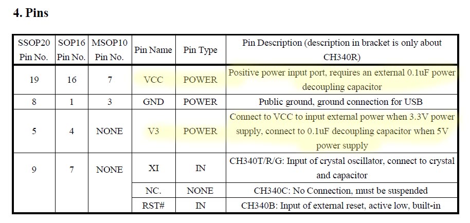

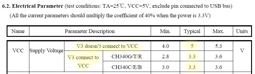

Interesting solution. Your 5V conversion should also change the V3 pin, per the data sheet.
Why? The CH340 chip supports 3.3V VCC if the "V3" pin is also connected to 3.3V. When using 5V VCC, the V3 pin must be only connected to a .1uF cap (V3 is not connected to VCC).
