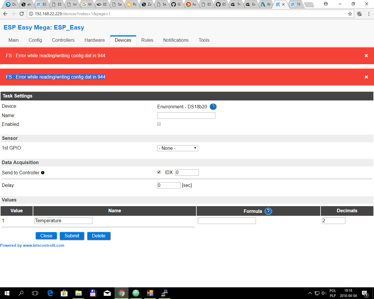

As your suggestion I managed to compile on 2.3.0 core. Plugin sims work OK but when I try add new device I have error in red frame:
I guess is a filesystem error. Maybe not enough flash? Or is wrong organization, because I had another version of firmware before.
I'll tray to disable some unneeded plugins for me and check again.

#107 Post by xury » 16 Apr 2018, 01:09
Ok. I finally managed to compile with what I need.
It was a problem with PUYA chip.
After patching Esp.cpp it works well.

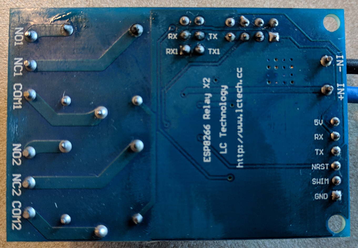

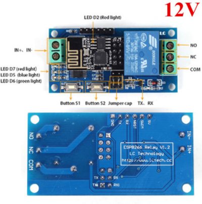

You're welcome. In the meantime i also bought an LCTech relay, but a 12V version which is also works with the same commands. But some reason it only works reliable with 115200 baud setting.
Older models speed was 9600 baud at default.

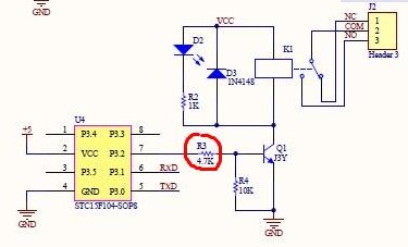

Programmed the MCU of relay with the hex code from the post. And the relay works now. Well, sort of.
The LED works, it turns on and off with the on/off command, but the relay does not switch.
The problem is that the R3 is too big. It is 10K instead of 4.7K from LCTech. Once I changed it to 4.7K, it worked.

qingz wrote: 05 May 2018, 03:56 Programmed the MCU of relay with the hex code from the post. And the relay works now. Well, sort of.
Nice work! I know that counterfeit's sometimes missing software, but never tought that they are incompatible at hardware level. If i were you, i would ask for refund.

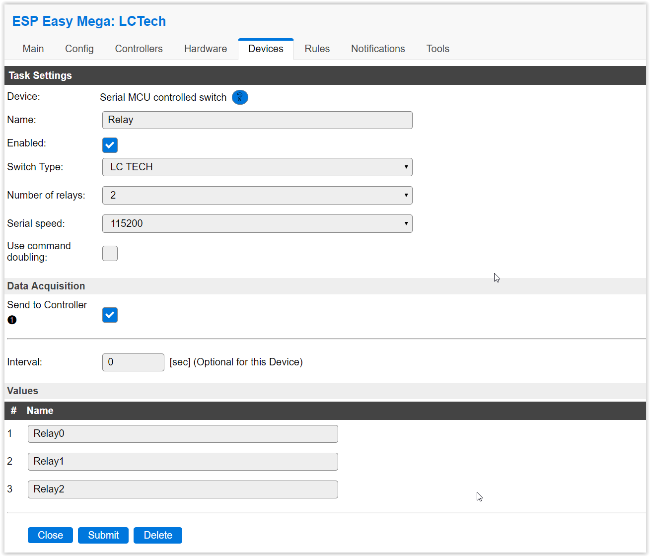

Hi Xury,
I have an LCTech Relay X2 (2 relay module). The stock firmware on the MCU and ESP worked, I was able to control the relays with HEX codes over TCP. I flashed your ESPEasy_1M_128kSPIFFS_PUYA.bin to the ESP-01 (not a PUYA chip). ESP Easy works. I configured it in the following way:
Device: Serial MCU controlled switch
Enabled: X
Switch type: LC TECH
Number of Relays: 2
Serial speed: 9600
Use command doubling: NO
Send to Controller: X
Interval: 0
Names: Relay0, Relay1, Relay2
I also configured a OpenHAB MQTT controller. I am trying to send 0 and 1 to /LCTech/Relay/Relay0 but nothing happens. The device and MQTT definitely works as I am getting the RSSI and update messages from the System Info devices that I have also created. When I am sending the MQTT messages to the above relay topics, nothing is appearing in the Log.
How can I check this further? Can I switch the relays from the Webserver?
Thanks,
Csongor

riker1 wrote: 30 Jan 2018, 08:37 Now I can switch relay with 115200 baut.
According to riker 115200 baud is the necessary setting. Save than power off&power on the device, and check if it works. If nothing helps you can try other speeds, and for last resort: command doubling.
nygma
Posts: 27
Joined: 26 Nov 2016, 11:16
Re: Serial MCU controlled relay/switch
#135 Post by nygma » 08 May 2018, 08:34
enesbcs wrote: 08 May 2018, 07:46 According to riker 115200 baud is the necessary setting. Save than power off&power on the device, and check if it works. If nothing helps you can try other speeds, and for last resort: command doubling.
WOW, man, it works! Thank you very much! Let me add a post here with the exact settings for anyone who comes around next time.

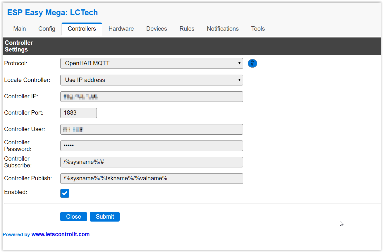

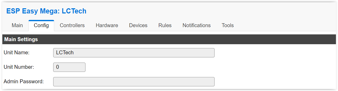

This for anyone who would like to setup ESP Easy for a LCTech Relay X2 board. Thanks for the guys here for making this happen and helping me getting it working with my relay board.
I got mine from ICStation.com: http://www.icstation.com/esp8266-wifi-c ... 12593.html
My model came with a ESP-01 NOT with a PUYA flash chip. But the firmware is PUYA compatible, so it should work with an ESP-01 with PUYA :D
This is how my board looks like:
And the back of the board:
Flash ESPEasy_1M_128kSPIFFS_PUYA.bin firmware to the ESP-01. You can find the link to the firmware on Page 12 post #120 of this thread.
Perform the basic settings of the ESP Easy (wifi, etc.)
I set LCTech as my unit name (it will be important for MQTT later):
Add the following in the Device section:
Of course your can rename the Relay0, Relay1 names at the bottom. Ignore Relay2.
I set up MQTT with the following settings:
Save the settings and power cycle the relay board. When I power up the board, the red LED (D7) is lit and after a few seconds the green LED (D6) starts flashing. And it will stay that way. The board is ready to receive commands. So far I am controlling it via HTTP and MQTT the following way:
HTTP commands:
Relay 0 Off: http://ESP_IP/control?cmd=relay,0,0
Relay 0 On: http://ESP_IP/control?cmd=relay,0,1
Relay 1 Off: http://ESP_IP/control?cmd=relay,1,0
Relay 1 On: http://ESP_IP/control?cmd=relay,1,1
MQTT commands:
Topic: /LCTech/cmd (of course this may change depending on the Unit name)
Payload:
Relay 0 Off: relay,0,0
Relay 0 On: relay,0,1
Relay 1 Off: relay,1,0
Relay 1 On: relay,1,1
With the above setup, you will be getting MQTT messages on /LCTech/Relay/Relay0 or /LCTech/Relay/Relay1 topic with payload of 0 or 1 when the relay status is changed either via HTTP or MQTT. There is no status message back via HTTP. Keep in mind that this is not based on the actual status of the relay, as the MCU is not sending status information / confirmation back to ESP.

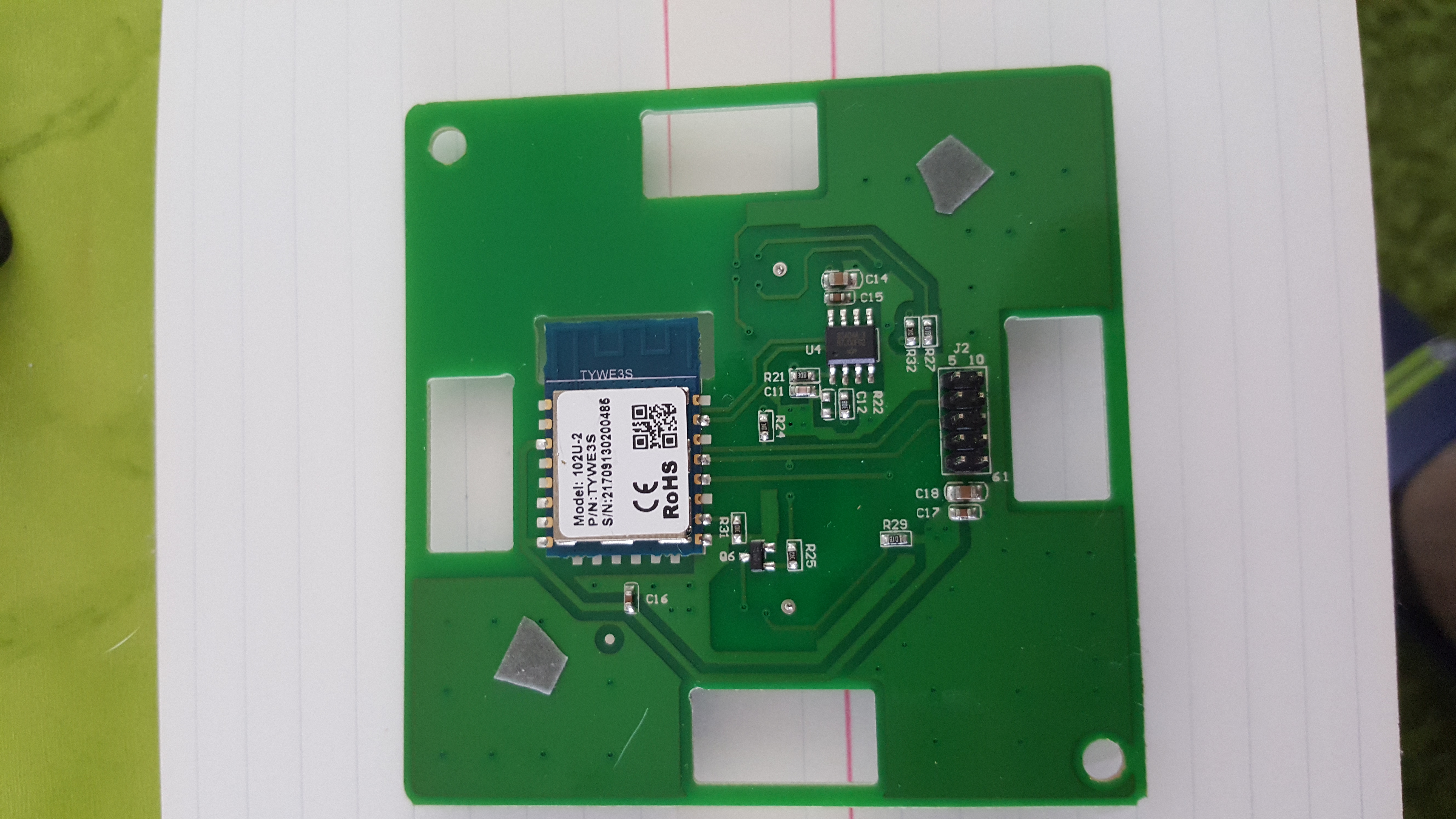

Hi all,
I just received a Jinvoo dual switch. I would like to install the ESP firmware yet I do not find any empty pin headers... Has anyone experience with flashing this device? Below are the pictures of the PCB board.
The attachment 20180617_131709.jpg is no longer available
In case someone already flashed it, which binary file did you use?
Kind regards
