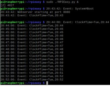

#156 Post by vidalv » 15 Oct 2019, 21:01
Hi all, I'm new on RPIEasy, I've installed the package on my PI3 then after starting :
Now, how to start ESPEasy on web browser ( Chromium) ?
Thanks for help !

#157 Post by enesbcs » 17 Oct 2019, 11:18
vidalv wrote: 15 Oct 2019, 21:01 Hi all, I'm new on RPIEasy, I've installed the package on my PI3 then after starting :
Thanks for help !
As something grabbed port 80 on your RPI, it writes clearly that RPIEasy started on port 8080, so you can reach it from any webbrowser as http://your_raspberry_ip:8080/

#158 Post by vidalv » 23 Oct 2019, 12:14
Thanks enesbcs, by putting IP address on menu bar it works fine, thanks !

Alan-rpi
Posts: 15
Joined: 09 Feb 2020, 22:49
Location: UK
Re: RPIEasy
#177 Post by Alan-rpi » 09 Feb 2020, 23:11
Hi Many thanks for helping RPi users with this GUI :) My installation went fine!
I'm struggling to get an easy initial test going as I've not found any manuals or guides.
I've defined:
Hardward Pinouts: Set GPIO 6 (Shutdown Button) to Input
Devices: Defined Generic Input, Name: Shutdown Button, Enabled, 1st GPIO: GPIO 6, Debouce: 300ms, Type: Push Button Active Low, Values/Name: State
Dependencies: Selected Generic MQTT paho-mqtt
Controllers: Defined Generic MQTT, Enabled, Controller: 192.xxx.xx.xx. Port 1883 (default), Report %sysname%/#/state  Command: %sysname%/#/set
				Mode: MQTT (no security), Controller lwl: %sysname%/LWT, Connect: Online, Disconnect: Offline
Now I want to link GPIO 6 to GPIO 13 and send an MQTT message. Do I have to define a rule like this:
			on ShutdownButton#state do		// GPIO 6
				if [ShutdownButton#state] = 0
					gpio, 13, 1	// shutdown LED on
					gpio, 13, 0	// shutdown LED off
				Publish RPIEasys/ShutdownButton,ShutdownButton#state
BTW, I've built some electronics to interface an alarm panel to a RPi4 and to test it and learn Python I wrote a table driven program to test my hardware. So to do the above I would define:
[6, "ShutdownButton", "input", "falling", 300, 13, "high"],      # Turns on Shutdown Red LED
It strikes me the rules in RPI EAsy could be similarly defined via a GUI table/form, at least to handle simple rules:
<input device><event><output device><state/message>
e.g. ShutDownButton, falling, ShutDownLED, high
e.g.  ShutDownButton, falling, MQTTClient, myRPI/high
Thanks again, RPI Easy is looking promising and could avoid implementing a more complex system like openHAB.
Alan in the UK

Alan-rpi wrote: 09 Feb 2020, 23:11 I'm struggling to get an easy initial test going as I've not found any manuals or guides.
Its a free software which means that it's free to anyone to write manuals and guides... :)
I've written a short instructable in english here:
https://www.instructables.com/id/RPIEas ... or-Device/
And a longer one in my mother language here:
https://bitekmindenhol.blog.hu/2019/01/02/rpieasy
Alan-rpi wrote: 09 Feb 2020, 23:11 Hardward Pinouts: Set GPIO 6 (Shutdown Button) to Input
Please do not use space in device names and value names. I used "Input-Pullup" pin type in my testing as it makes more sense, if it is activated by pulling to GND. (active low)
I hope that GPIO13 is also defined as output at Pinout.
Alan-rpi wrote: 09 Feb 2020, 23:11 Devices: Defined Generic Input, Name: Shutdown Button, Enabled, 1st GPIO: GPIO 6, Debouce: 300ms, Type: Push Button Active Low, Values/Name: State
In case the status did not change you can lower debounce to 50 or 100ms. For last resort try to enable 1/10sec periodic checking.
on ShutdownButton#State do
 if [ShutdownButton#State] = 0
  gpio, 13, 1
  gpio, 13, 0
 Publish RPIEasys/ShutdownButton,[ShutdownButton#State]
I've tested this code just now and works as expected. ESPEasy rules are well documented:
https://www.letscontrolit.com/wiki/inde ... rial_Rules

I did try my code before posting and the console indicated that the button was pressed, but nothing else.
If there are syntax errors in the rules, do they appear on the console?
You say "For last resort try to enable 1/10sec periodic checking.". That implies RPI Easy is polling the pins for state change rather than setting up GPIO.add_event_detect. Is that correct? I'm a bit worried about my Pi 4 overheating if it is running 24/7. They seem to have a bit of a reputation in this area.
Tomorrow I will make your suggested changes and try again.
Best wishes, Alan

Alan-rpi wrote: 11 Feb 2020, 00:19 If there are syntax errors in the rules, do they appear on the console?
"Debug level" console logging gives some idea what is happening in the background. I did not implemented the full rule engine, interpreter simply forwards commands to plugins (which returns only simple False in case of error), or conditional checks to python eval() function (which returns true or false).
The code i've sent is working, the code you've posted earlier missed some [].
Alan-rpi wrote: 11 Feb 2020, 00:19 You say "For last resort try to enable 1/10sec periodic checking.". That implies RPI Easy is polling the pins for state change rather than setting up GPIO.add_event_detect. Is that correct? I'm a bit worried about my Pi 4 overheating if it is running 24/7. They seem to have a bit of a reputation in this area.
The default behaviour is to use add_event_detect, except when you CHECK 1/10 periodic check than it will use periodic check. Periodic checking is a fallback method only, because in my experiences add_event_detect did not work always, especially if you use debounce.. you will see.
