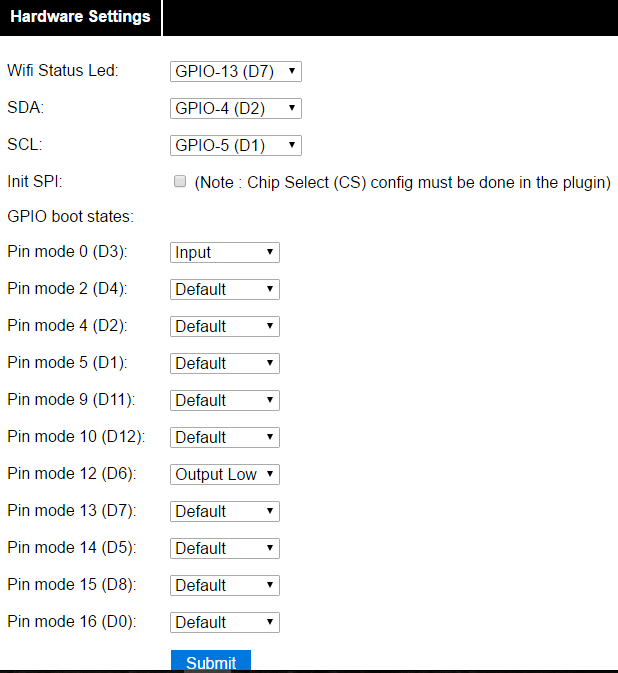

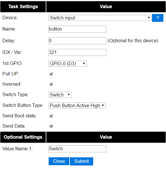

How to me to make that when clicking the button the relay switched?
And that it worked only by means of the standard program in a firmware that it was possible to include or turn off manually the light in the absence of the Internet or Wi-Fi of a network in particular.

First go to Tools->Advanced and enable Rules (click on Rules checkbox).
Then go to Devices and cerate switch input like here:
Then go to Rules tab and paste this code:
on switchon do
gpio 12,1
gpio 13,0
inputswitchstate 0,1
on switchoff do
gpio 12,0
gpio 13,1
inputswitchstate 0,0
on Switch#switch do
if [Switch#switch]=1
event switchon
event switchoff
Submit and reboot!
Test. This setup works for me.

Re: Control of the relay when clicking the button (without network)
This is all I have for my sonoff's:
On button#switch do // when button is pressed, toggle the relay
if [button#switch]=1
gpio, 12, 1
gpio, 12, 0
---Device Settings---
Device: Switch input
Delay: 0
IDX/Var: [what ever you need, I just use 1]
1st GPIO: GPIO-0
Switch Type: Switch
Switch Button Types: Push Button Active Low
Pull Up, Inversed, Send Boot State, Send Data - unchecked
Value Name 1: switch
gpio, 12, 1
gpio, 12, 0
Delay: 0
1st GPIO: GPIO-0
Switch Type: Switch
