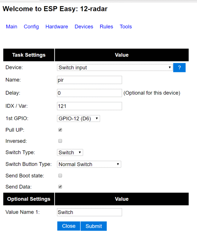

Please read this article. It describes how to use the PIR sensor on 3.3V without soldering. I already did that on my arduino pro mini but used the 5V on my nodemcu (well, actually: I tried to use 5V but that didn't work).
I now connected the PIR data wire to GPIO14 (~D5) and the power (via PIR sensor 3.3V connection) to 3.3V and GND to GND (of course). It works flawless. I also tried with GPIO0 (~D3) and that works just as well.
No shielding, no special cables. First with 3 short dupont wires, now with unshielded 1½ meter wires.
Config:

#28 Post by tozett » 16 Dec 2016, 21:46
rtenklooster wrote:I replaced the sensitivity resistor with a 47K
The time resistor with 4.7K.
Need to finetune a little bit because i just noticed, when my wife goes to the toilet at night, i got a (false) positive from the sensor one floor lower in the living room.
Would be glad about FEEDBACK....
because i finally managed to try one of my 6 month old "new" RADAR sensors.
i used some info from CNX and Scargill
i assumed they would trigger all the time, if i sit directly in front of them.
instead it seems to me, they are not "that" sensitive at all.
i made a rule to switch a led, if the RADAR switch goes to 1, but it does this only sometimes. i feel.
do i have any mistake in my config, or is this "slow" as a real PIR...?
i would be glad, if anybody could share some experience with the RADAR module...

i left all default resistors in place,
means probably 20k for sensitivty (10-100k, higher resistance is less sensitivity, like a comment wrote)
and also default for time (30s) (as i checked later, on my pcb there is _no_ resistor ~ 30sec ??)

Re: HC-SR501 PIR issue's
#32 Post by tozett » 15 Jan 2017, 13:47
i played with the radar-pir.
looks they are working ok, but they have 360 degree observation.
i put one in a tin-can and tried to limit it to 100 degree with that.
but i had to put this on hold. i am short of time ...
