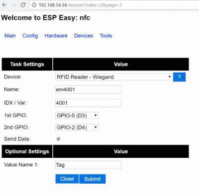

i ordered a longrange Reader from aliexpress, looks like its generally working.
It beeps at start and also recognizing a tag.
but the (probably) Wiegang-Signal is not recognized by ESPeasy.
(espEasy ver147 on wemos mini d1 and nodemcu ver1 boards. both dont work)
In the past i managed succesfully to get the Wiegand-signal from my fingerprint-Reader.
The fingerprint-reader is now perfectly working over 1/2 year. (espEasy ver145, wemods mini d1 board)
I dont know exactly how to debug this hardware/software issue.
i put a simple oscilloscope on the D0 and D1 wires, and i can see Waves coming in.
Looks like always the same pattern for the same Tag.
I show, what i have. Greatly appreciate any hint to go on from here to get this working with ESPeasy...
(i am somehow a noob... 8-) )
