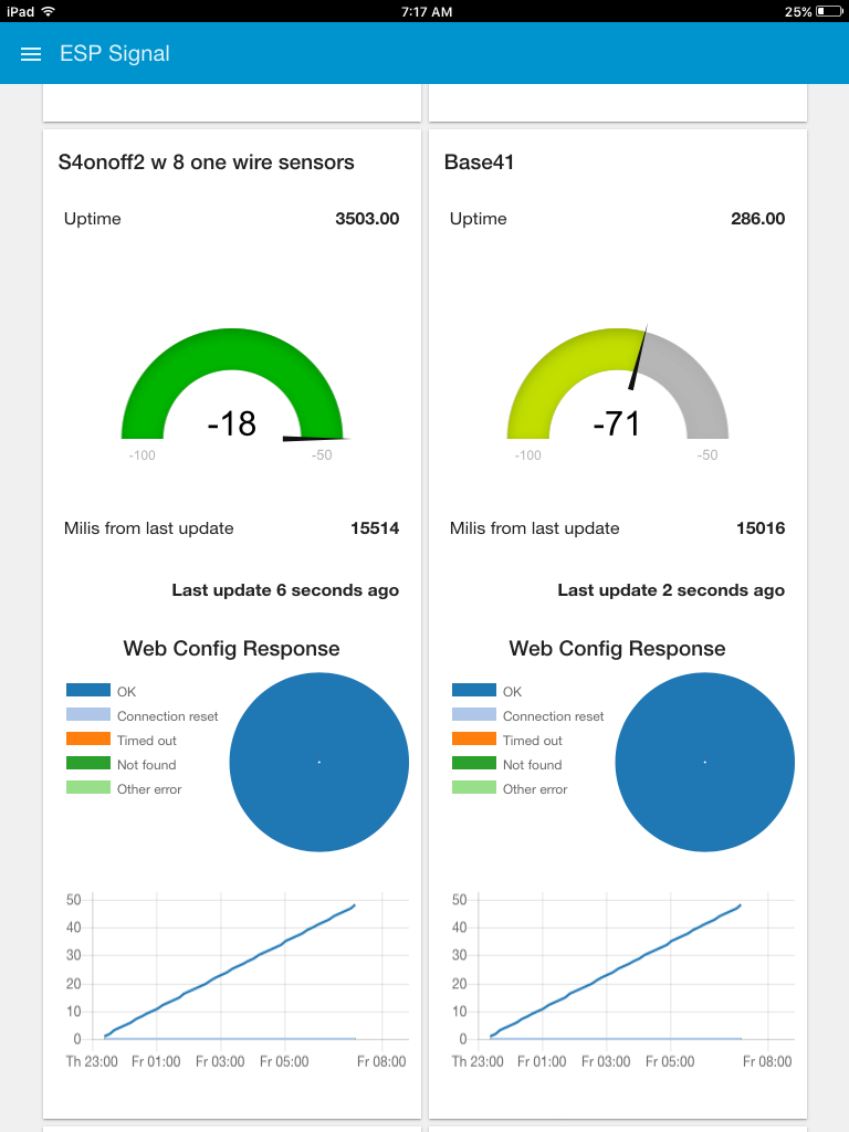

Out of box with 9 units thus far: I have had one Sonoff unit that will not work on Mains at all. Programmed fine powered by the programming cable but that was it. I had one unit that had wifi poor connectivity. I reloaded ESPeasy a few days later and subjectively the unit started to work better. All are on 147 I believe. I have another box of them coming...
As to performance:
I just found this last night (which brought me to this thread) and set it up on my system for a mixture of 6 Sonoffs and raw Esp8266 units. Thank you to the author for a nice learning example..
https://m.youtube.com/watch?v=mK1vvyuf39c
http://flows.nodered.org/flow/1963bdc55 ... 7ecc859612
After running it for 6 hours, I see good connectivity to all and was not surprised to see my heavily loaded 4 channel Sonoff (8 one wire sensors) responding often two seconds slower than the others.
In the image, that Sonoff is sitting on the AP(g), the Base41 ( raw Esp8266 ) is three rooms away.
As a side query, the Base41 unit is near another AP(n) with the same credentials. None of these ESP units will talk to that AP(n) but the iPad, phones, computers and roku love it. Do the Esp units not like (n)?
The (g) AP is using channel 11 and the (n) is using channel 36. I can see them both from the end of the house with the iPad. -45db and -85db respectively.

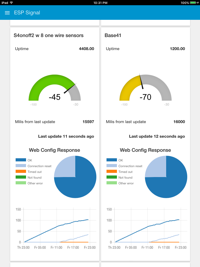

First of all, thank you for using my flow for running the stats. I have to say this makes me interested. Is it possible that there is so much difference between individual models? None of my models are as reliable as yours.
Re: Unreliable config page and SendTo connectivity
All seem to have this status now:
My delay is 15sec not 5sec so that may make mine look better.
