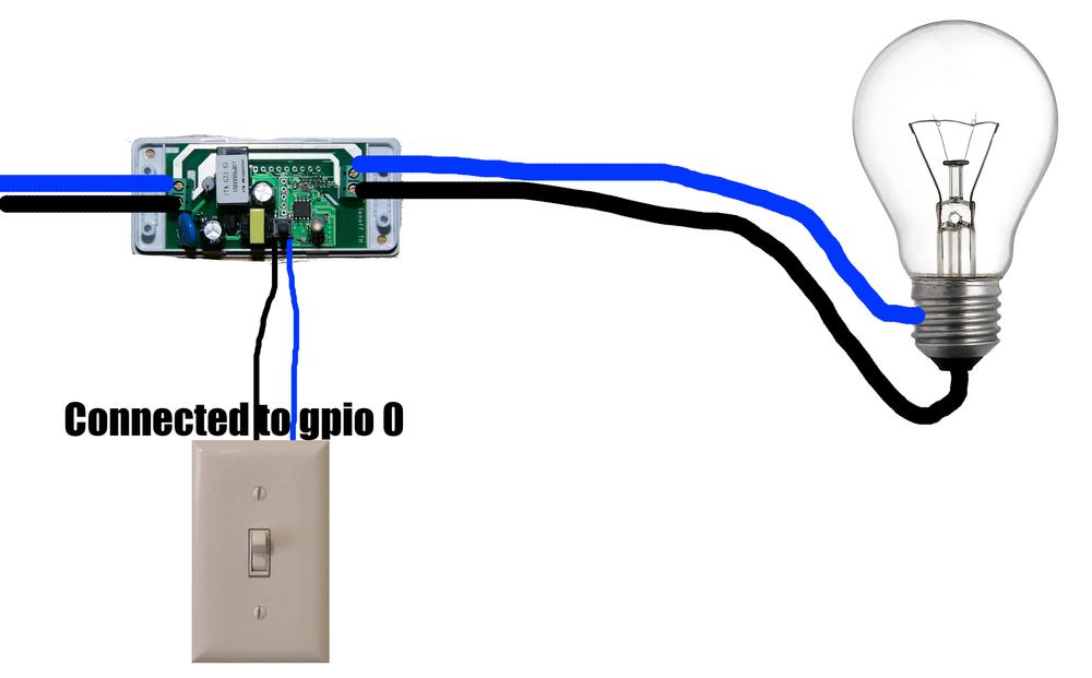

Then maybe you should leave your esp device always on, and use a GPIO to control the relay. Im using this setup and works fine.
Im even using the sonoffs multiple GPIO to control the relay and another sonoff.

#4 Post by gajotnt » 24 Feb 2017, 17:06
Exactly how i am using...
Theres maybe a few milli seconds delay, if thats what you're talking about, i dont think there's anything one can do.

My setup is different, the wallswitch breaks power to sonoff.
Mains > switch > sonoff > lamp
Wiring the switch to gpio would require to open walls and run additional wires or dig holes to burry the units...

Then theres your problem...the sonoff must always be connected to mains if you dont want the delay with the bootup of the device.
Then.... why have sonoffs? I dont get the advantage of using sonoffs with your current setup.
You have to flip the wall switch to turn on the light and sonoff and only then be able to control remotely?
